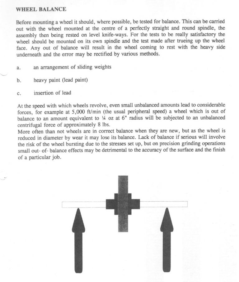

                  Hi, grinding wheels are porous, and as a result they are normally balanced by the manufacturer by gently vibrating powdered chalk I believe, into the appropriate places. Probably a skilled job that is learnt over many years, but most likely to be automated these days.
                  Below is an extract from one of my grinding wheel regulations courses I went on, about wheel balance, but the techniques of the methods are not elaborated upon, but I do believe some more elaborate machines have facilities for attaching weights on the clamping rings.
                  Clive is correct about checking them on knife edges.
                  Regards Nick.

                      I am intrigued by Nicholas’ comments on balancing and the article he attached. The question I have is, if the problem rests with the wheels themselves then what is the best way to balance them! Heavy paint, chalk – but not balance weights as in surface grinders – I think that would be going too far! I can confirm that there is no problem with water – here everything is ‘bone dry’!

                          Hi Clive, to be honest I have never had to balance any wheels that I’ve fitted or serviced, so how to implement lead into a wheel I don’t know. The last course I did was 17 years ago and the process was probably described verbally.
                          On the point of chalk it may have been finely ground sand, all I can remember was a short film about grindstone manufacture on the first course I ever did and that was back in 1978. What I remember seeing is the wheel laying horizontal on a vibrating machine and a small pile of powder piled in one place, the machine was started and the powder just disappeared into the wheel. Maybe lead is made into a powder and put into the wheel the same way.
                          Regads Nick.
