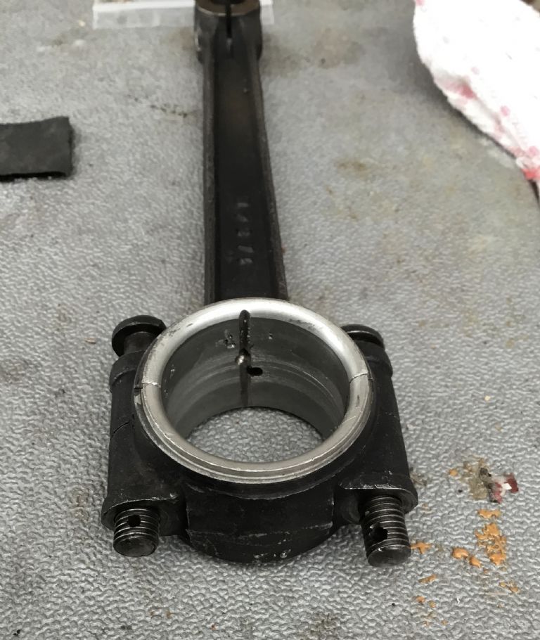

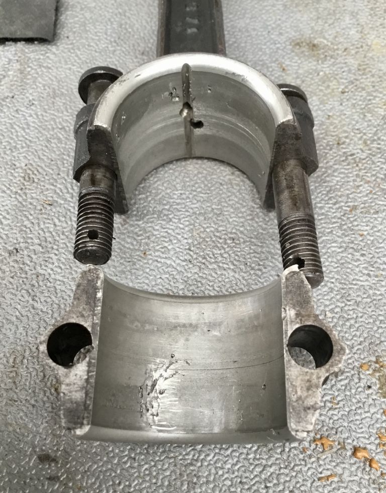

                                Something of interest are my Austin Seven two bearing conrods with cast in place bearing material.
                                Crank bearings are 1.3/8” diameter.
                                1935 Austin Seven Ruby ARQ
                                Considering age of car these are in nigh on perfect condition, other than the oil retaining ‘pits’.
                                No idea what has caused thise.
                                Geoff – Feeling somewhat human again

                                not done it yet
                                  @notdoneityet
                                  I have four rods, for a 2 3/4” crank, needing to be re-metalled. Doubt I will ever get round to it as I have a good set of mains and rods. Unless needed, the 20kg of white metal can remain as two cast cylindrical lumps of metal.
                                  When I had to rebuild my 73 year-old tractor, about 35 years ago, all I had to do was remove shims from between the con-rod and end-cap. Max crankshaft speed was only 1125rpm and it had only been worked hard for about 15 years on a 150 acre farm.
