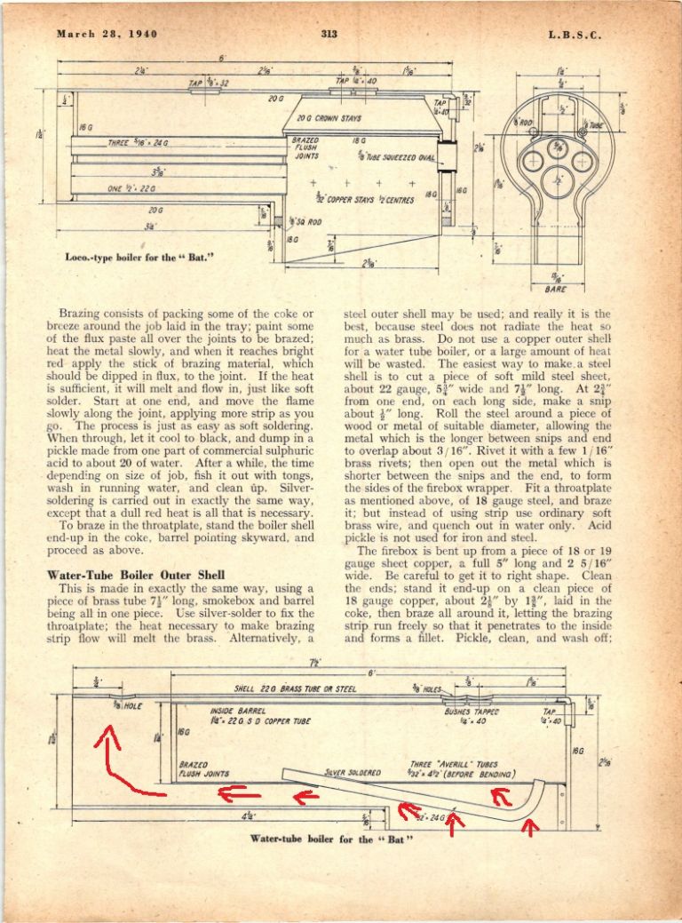

      Spend a day or two on this and there doesn't seem to be much about and to my newbie eye it simply makes no sense
      And in 80 years nobody seems to have taken a picture of their work
      If the tube runs from halfway along the boiler to beneath the footplate or firebox then is it plugged at the cab end?(must be, right!)

        #633985
        roy entwistle
          @royentwistle24699
          Looking at the drawing I would say no, it is not plugged. Water must flow through it
          Roy
          #633997
          Baz
            @baz89810
            The tube is open at both ends, water flows through it.
            #634000
            Martin Johnson 1
              @martinjohnson1
              The tubes are open. The heat sets up a siphon effect as steam is made, lost up the short leg and replenished with water down the long leg.

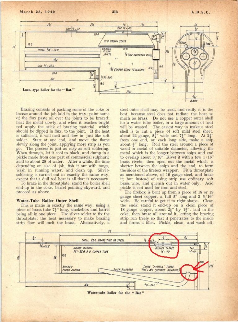

              #634003
              Ady1
                @ady1
                OMG I've just figured it out
                He's describing 2 totally different boilers
                The second one is a system I've not been aware of, the tubes dip into the fire and the boiler sits over the firebox…?
                So the flue runs under the boiler

                #634007
                Baz
                  @baz89810
                  Yep you got it ! Other bit you circled in red is possibly safety valve and steam outlet.
                  #634008
                  Ady1
                    @ady1
                    duh
                    I've just spent the last 2 days trying to shoehorn those tubes into my loco boiler, I thought they were to increase the heat transfer surface area
                    There aint much out there on these things, I'm number one on google after 1 day
                    Edited By Ady1 on 18/02/2023 14:33:47
                    #634523
                    Nigel Graham 2
                      @nigelgraham2
                      The simpler boiler with the thermic siphons was common practice for methylated-spirit (or nowadays perhaps) gas firing, not coal.
                      You are right in the tubes increasing the heating area.
