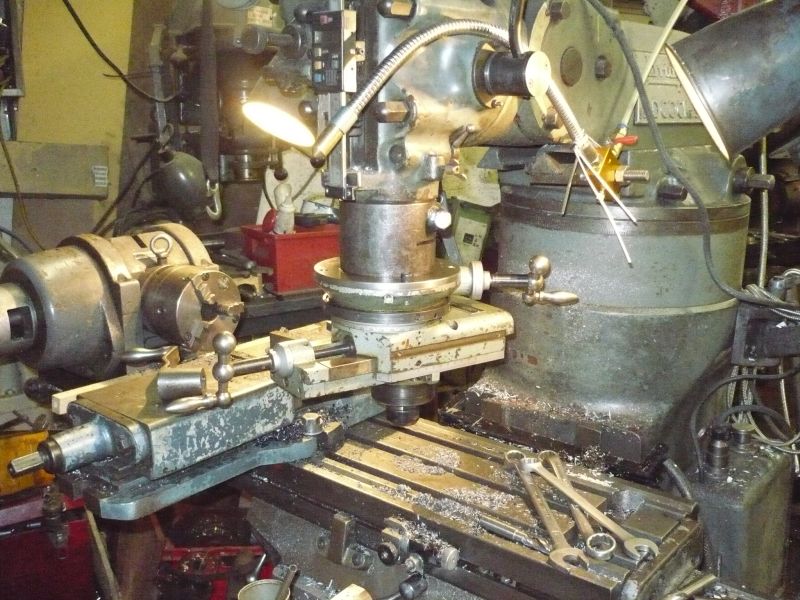

                                  MICHAEL WILLIAMS
                                    @michaelwilliams41215
                                    For another time :
                                    Delrin is dead soft compared with most metals . Mill the four straight cuts and hand cut the four corners using a scraper tool and a sheet metal template .
                                    Michael Williams .
                                    Edited By MICHAEL WILLIAMS on 05/03/2014 22:56:25
                                    #146107
                                    Roy M
                                      @roym
                                      Could you not wrk out the outside dia of the corner radius, and make a single point tool this size? You would only need X&Y moves then to achieve the correct profile.
                                      #146114
                                      MICHAEL WILLIAMS
                                        We used these :
                                        http://www.model-engineer.co.uk/albums/member_photo.asp?a=16640&p=502875
                                        Make a nice project for someone – you certainly could not afford to buy one
                                        They cost as much as the average semi but they were real class .
                                        MikeW

                                          #146116
                                          John Stevenson 1
                                            @johnstevenson1
                                            Found this on Ebay last year going cheap because no one knew what it fitted.
                                            Well it fitted my Bridgy once I'd thrown the weird mounting away and welded a new tube mounting up.
                                            It's German Wako unit which is a lot like the volstro heads and can move in arc and straight lines either independently or together if you can get your head round the maths.
                                            Personally it looks better on the mantelpiece and use the CNC for hard bits. wink
