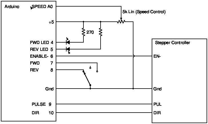

        The Arduino is controlling the stepper driver and it works but not quite as I’d want.
        At the moment I have a speed control and a push button switch that changes the motor direction.
        To stop the motor i’m using the ENABLE+ & ENABLE- terminals on the controler but this is not via the Arduino but rather directly.
        What I’d like is to do is have a single 3 position switch (On-Off-On) that controls the direction and the enable functionality.
        It would also help if a couple of LED’s were employed to show which position (Forward-Stop-Reverse) the switch was in.
        Can anyone suggest how to code this?

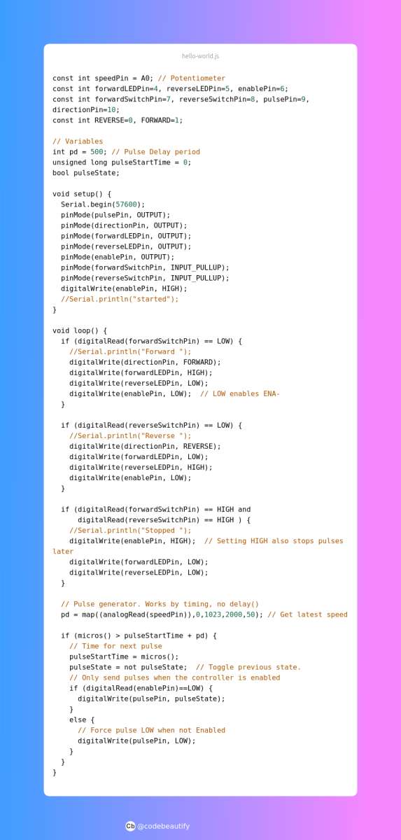

        (this is the sketch I’m using at the moment)

          A simple way to use such a 3 position switch is to connect its common to ground and connect the other two poles each to an input with a pullup enabled.  Then if both inputs are HIGH you disable the drive, or depending on which is LOW drive in one direction or the other.  No need to use interrupts for this.
          One thing to watch out for is if you have the feedrate set quite high and suddenly ask the stepper to move it may well stall.  Ideally you program an acceleration ramp and there are standard Arduino libraries to do this – accelstepper is one I recall. I think that it also takes care of all the pulse generation stuff, hopefully without using delay() function.
          One of the reasons for using GRBL to generate the pulses is that all the acceleration stuff is already taken care of.

              I think this works, and shows how to generate pulses without calling delay().   delay() is bad when the time comes to add more axes and maybe a tachometer to the code.
              Step 1, a circuit diagram.  I believe it has the hardware needed to switch FWD/OFF/REVERSE, and set LEDs burning.  I decided to control ENABLE with the Arduino rather than wiring it up to a 2-pole switch: it’s simpler.   The motor is only pulsed and enabled when forward or reverse is engaged.
              millx
              Step 2, the code:
              beautify-picture
              Generating a square wave by toggling halves the frequency.   Can be fixed by changing map() or by dividing pd by 2.
              I used INPUT_PULLUP to eliminate two external resistors, and digitalRead() on an OUTPUT pin.  It’s allowed.
              Bench checked only, so LEDs, DIR or ENABLE might be the wrong way round. If so, invert the commands.
              A rotary encoder simplifies the circuit by combining the switch and pot functionality, and it stops the operator engaging the motor with the speed set to maximum, which is roughly equivalent to flooring a car’s accelerator and letting the clutch up with a bang.  See John’s comments about ramping.    Though accelerating stepper motors is an interesting coding challenge, I’d use one of the available libraries!
