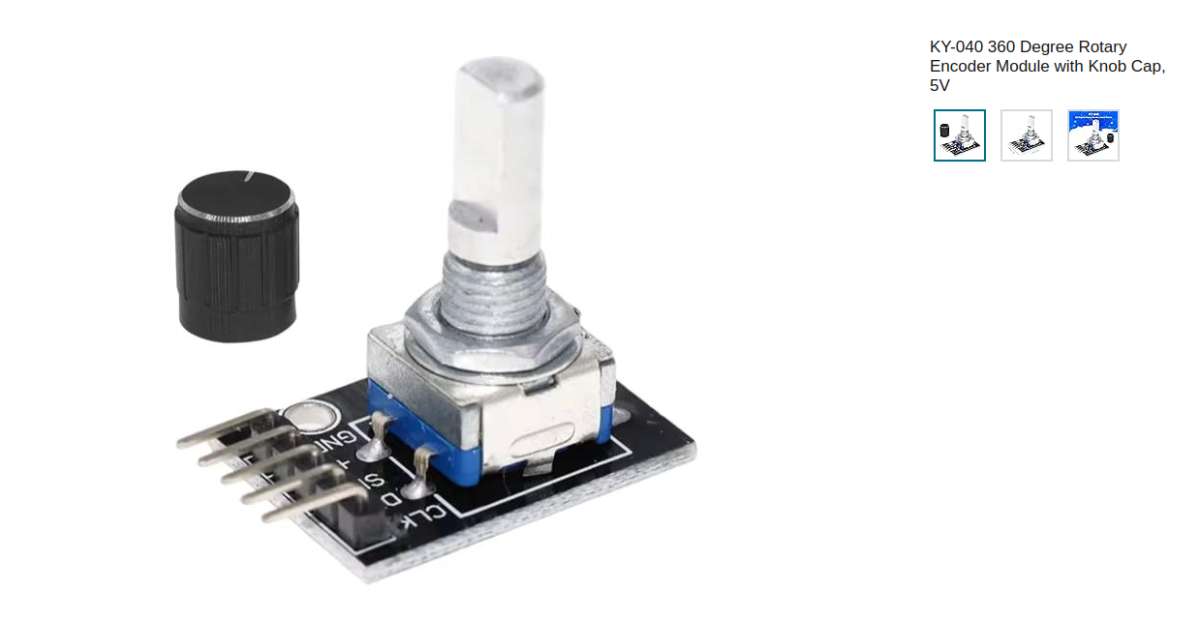

                  Rotary encoder for choice.  In addition to reporting value and direction in one,  they are easily managed with an Interrupt Service Routine.   Then moving the rotary control causes the Arduino to save what it’s doing, execute the control, and then continue from where it left off.     In contrast, the analogue input has to be polled, it’s not obvious how to manage whether the pot is moving or not when the measurement is taken, and writing the whole program to meet time constraints can be challenging.  Accuracy somewhat limited too.   Pots wear out, and the value has to be considered – 5k Linear would be OK.
                  Stuart’s momentary switches work best as interrupts too (to avoid polling), but a rotary encoder keeps the hardware simpler.
                  Rotary encoders vary from expensive when accuracy is needed to delightfully cheap.  For this application, cheap is fine.  This £4 KY040 is often found in starter kits or can be bought separately:
                  KY040
                  Code examples here, with and without interrupts.

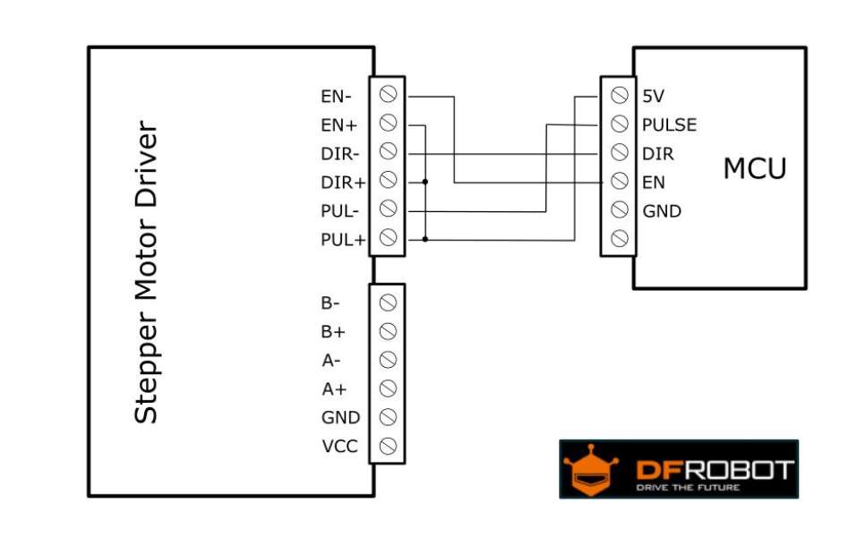

                                                      On nevillet Said:
                                                      Thanks John.   Not elegent but how about cutting power to driver?
                                                      It’s what the EN terminal is for.   The motor gets no power unless the drive is EN-abled.
                                                      A delight for those new to digital logic is that 0 and 1 can have their meanings reversed, so 0=ON and 1=OFF or 0=OFF and 1=ON.  That’s why the controller has pairs of terminals, PUL+ PUL-, EN+ EN-, and DIR+ DIR;  they decide which way up the logic is.  (Inverting digital logic may seem over complicated but it’s handy in electronics and computing.)
                                                      In this example from the T6600 manual the motor is enabled by the microcontroller; the program controls it.
                                                      Screenshot 2025-04-18 214815
                                                      The motor is enabled by grounding EN-. which could be done by a switch.
                                                      Three common ways of applying power to steppers, depending on the requirement:
                                                      • Hardwiring EN so the motor is always on.
                                                      • EN with a physical ON/OFF switch.
                                                      • EN with an IO pin on the microcontroller, you write the code, which can be as complicated as you wish!
                                                      Why is complicated useful?  One example, Enabled Stepper motors have torque when stopped allowing them to hold a load.  Acting like a brake may be what’s wanted, but if holding isn’t required it wastes power and the motor gets warm.  Therefore applications can be programmed to dis-Enable steppers so the motor freewheels. If the motor hits an end stop, not pulsing PUL will stop and lock the motor in position when it might be more appropriate to turn the power off with EN.
