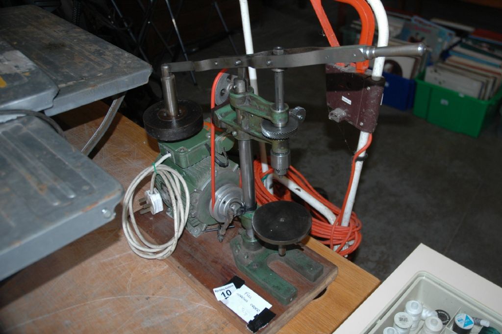

Anyone recognize this?
      #13469
      Roger Clark
        @rogerclark
        Small drill press.

          Roger Clark
            @rogerclark
            Ha ha, nice one Jason. cheeky
            #402333
            Roger Clark
              @rogerclark
              There's no id on the castings but the gears are well made, the motor looks to be french. I picked it up for £28 at a local auction, I think I can add tapping to it without too much effort.

              #402337
              Andrew Evans
                @andrewevans67134
                It's similar to something I picked up. Mine is more like a larger version of the GH Thomas sensitive drill.
                #402343
                  Nice reduction gearing yes
                  Sorry, I don't recognise the machine.
                  #402351
                  Jeff Dayman
                    @jeffdayman43397
                    I was going to say "table saw" (grey thingy at left) but Jason beat me to it with the Flymo wit.
                    I wouldn't add too much tapping to it – you'll spoil the paint and chips will fill the tappings!
                    Seriously, though – you may need to change pulleys and belt to toothed synchronous type, from the round urethane orange one, for tapping anything bigger than about M4. Not a big deal to change it over though, if need be. Try it and see – with the high reduction the round orange belt may be fine.
                    #402362
                    Nicholas Farr
                      @nicholasfarr14254
                      Hi Rockingdodge, it could be someone has modified the drive to an old belt driven drill press. The castings are not that dissimilar to my Bonds Maximus drill press.

                      #402374
                      Rik Shaw
                        @rikshaw
                        I built one of these forty years ago from a set of castings that were advertised as for a "sensitive drill". The foundry was somewhere in Lincolnshire.

                        #402384
                        Roger Clark
                          @rogerclark
                          Posted by Jeff Dayman on 26/03/2019 23:33:49:
                          Hi Jeff, I did mean manual tapping, i don't think the motor would have enough torque and there would be little control.
                          The drive shaft is held by a nut on the top and my thoughts were to make an extended nut and make a handle similar to the G H Thomas Universal Pillar Tool, and by releasing the balance weight I would have a super dooper tapping machine.laugh
