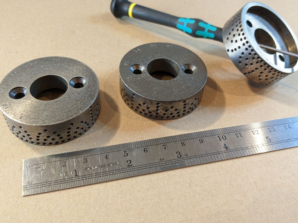

      I found these in a job lot of small lathe tooling I purchased, obviously they are for dividing but does anyone know what they actually fit? I suspect they are for a small lathe but are of no use to me. Thanks.

          They could be for a cutter grinder. See this one and note the similarity of concept and scale:
          https://toolz4you.co.uk/product/jones-shipman-raised-universal-indexing-head-attachment/

            I have similar ones on my Stent albeit homemade, they really are quite good. those look really nice .

              Agreed cutter grinder accessories.
              Something functionally similar to the J&S device linked to by DC31K came with my Clarkson.
              Nope. Dunno how you use them.

                Thanks for the replies, they do indeed look like the cutter grinder ones.
                The divisions stamped in them are:
                3, 13, 23, 33, 43, 53
                11, 21, 31, 41, 51
                9, 19, 29, 39, 49, 59

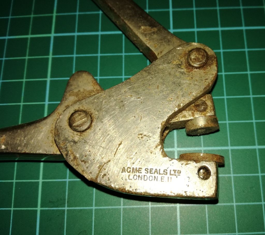

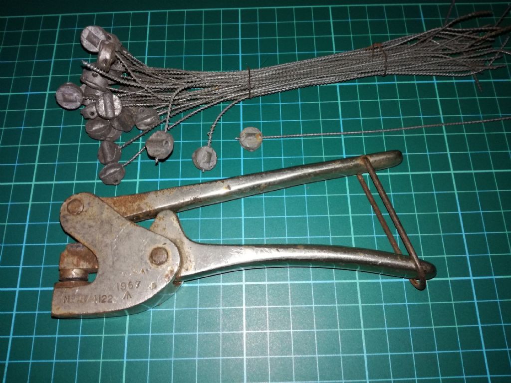

                                                  Hi MichaelG, you linked to a seal press, and as it happens, I have an old one made by Acme Seals Ltd. London, with a small bunch of lead seals. It is another item I rescued from being put in the scrap bin many years ago.
                                                  Regards Nick.
