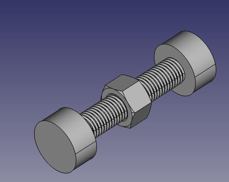

                                                  Novelty items go down well with the family (unless the kids twig you've blown their inheritance on the gear needed to make them!)
                                                  Made by turning a rod down between the two ends then sawing in half and drilling and tapping both sides to take a hidden length of studding. Screw the two halves back together and cut the outer thread. (No need to take the thread all the way to the end-flanks as the image suggests. Unscrew the two halves and put the nut on one of them before reassembling. A dab of super-glue on the inner stud is enough to prevent casual dismantling. The join is hidden by the thread.
                                                  Double headed coins are popular with children, less so with rough men in pubs who've been conned into buying all the drinks. Made by facing off two identical coins and supergluing them together. A useful exercise in work-holding thin objects; it's done by superglueing the coin to the end of a rod gripped by a chuck. The glue joint can be broken by Acetone (Nail Varnish remover), boiling or with a blow-lamp.
