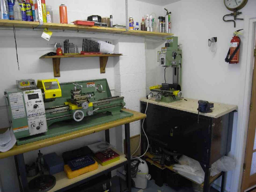

              Set up my workshop a year ago with a Warco WM14 and have been very very pleased with it as a newbie to model engineering I can’t say I’ve much experiance with any other modern model engineering machinery but I can remember using a wide range of machines at work. As an apprentice my favorite been the Davenport miller – way out of reach price wise and size wise
              I’m not even going to compare the two but for shear value for money and size I’ve enjoyed my first years ownership with the WM14, had no problems and it has been most useful in the workshop
              My advice is buy the one you can afford (price and size) and just start making models
