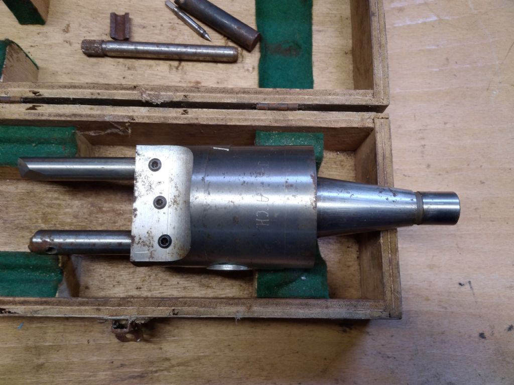

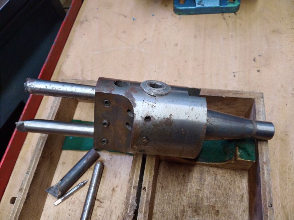

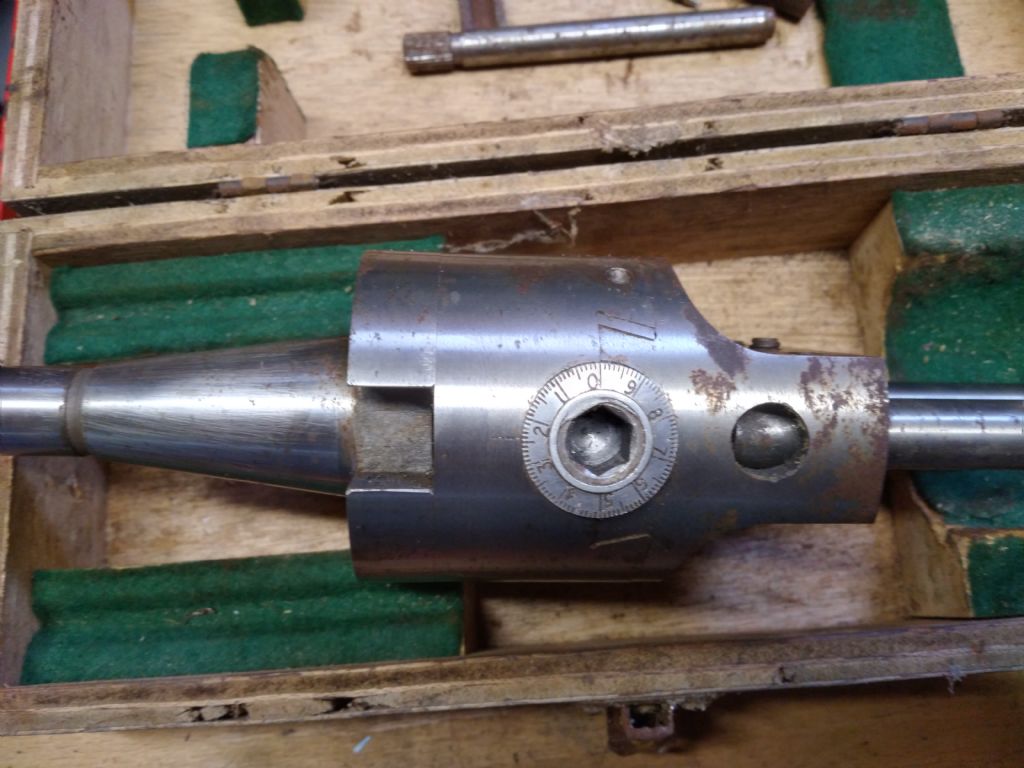

      20200824_171852.jpg20200824_171918.jpgAlong with my recently arrived ML7 was a small plywood box and in it was this thing.
      Somebody took a lot of time producing it and even engraved their name on it.

          That's a boring head although it wouldn't be used with 2 tools in it. Are there any makers markings?
          Brian
          #492566
          Dave Halford
            @davehalford22513
            Boring head for a mill 40int or 50int taper

              No makers nam at all. Just "J.S. Hatch" engraved on it, one with a hand held tool.
              The box is neatly made but dosn't look a factory job.
              I can't imagine I'll ever use it so its up for grabs if anybody wants it.

                Taper could be 30int?
                #492580
                Emgee
                  @emgee
                  Boring head with 2 cutting diameters, the lead tool will be roughing and the 2nd tool finishing.

                    Posted by Emgee on 25/08/2020 17:47:00:
                    Emgee
                    LOL I don't think so.
