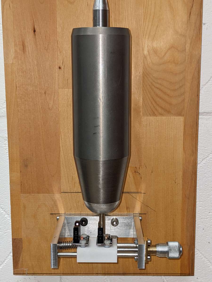

                            #677672
                            John Haine
                              @johnhaine32865
                              PXL_20221119_175710132
                              Just as a test a photo of the pendulum bob and sensors
