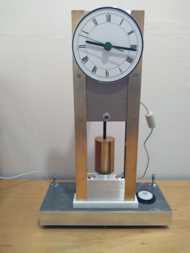

      A while back I posted a couple of replies in the thread that SoD created on his experimental clock on something I was playing around with. I thought I'd create another thread with more details to avoid confusing Dave's thread. The photo shows the nearly complete clock which is now sitting on my desk keeping reasonable time. It doesn't actually lean over to the right, that's just the photo!
      The pendulum is to the rear of the clock, suspended from a bracket mounted on two brass channel uprights. Also attached to these is the dial, a commercial dial plate from Meadows & Passmore mounted in a shallow tray CNC millied from 1/4 inch aluminium. Movement is a converted quartz, with the stepper coil disconnected from the IC and brought out on a couple of thin wires. Arduino Nano is mounted on a small bit of perf board on spacers from the plate below the dial. Pendulum rod (bit of 6 mm CF tube) suspended from double spring, brass bob about 75mm long clamped by set screw from behind. 12 x 3 mm Neo magnet in the end of the tube.
      This is the back view of the former lash-up. The white block at the bottom has the impulse coil directly below the centre position of the pendulum, and a Hall effect sensor to the right that detects the magnet on its swing extreme to control amplitude. The block is now mounted slightly differently with adjustable height from the aluminium base.
      I was very much using bits from the scrap box in making this and focusing on getting it finished so not much "design" but I think it looks at least OK. Still need to polish up all the metalwork, hide the power cable (currently running off a USB lead to the Arduino) and make some sort of "dome" to keep the dust out. Also of course get it regulated!
      I'll write another post about the software.

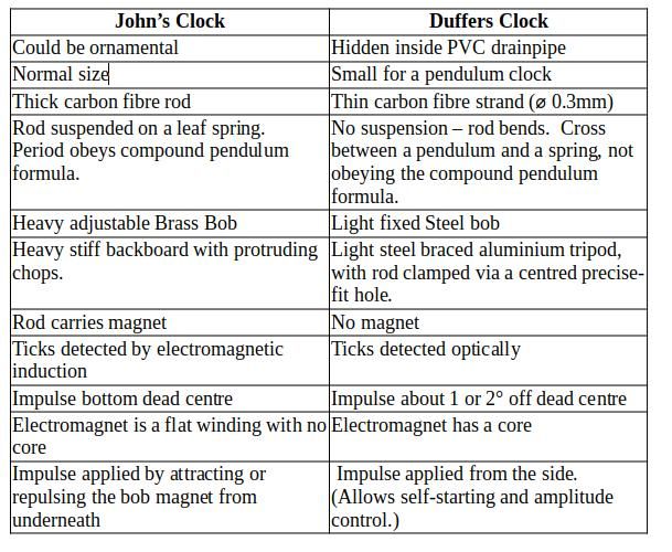

        #508174
          May be of interest to compare my Arduino Pendulum with John's.
          John is more certain of success because his clock is based on best practice. Mine is experimental!
          Current status, it's being run by a Nucleo rather than an Arduino at the moment because the faster microcontroller has a resolution of about 1µS compared with 4µS. Still not good enough, I'm after 100nS or better.
          John brought my attention to the picPet, which uses a different technique to measure times. I'm trying to replicate the picPet method on an Arduino. Appears possible and Arduino should be capable of somewhat finer resolution than picPet because it use a faster clock. Few examples on the web so I've been forced to read Data Sheets and experiment. Have been getting reasonable approximations for some time but was baffled why they were erratic. Twigged last night I've been reading the wrong register, the one that carries on counting after the event, instead of the snapshot. Will modify the code and try again tomorrow.
          #508185
          John Haine
            @johnhaine32865
            Thanks Dave, a useful comparison. Nice to say "could be ornamental" – in the eye of the beholder I suspect! Actually the backboard has gone back underneath the bench so everything is supported by the brass channel pillars now. The bob is adjustable in principle, but the idea is for regulation to be digital by skipping a dial pulse every so often – at the moment every 132 cycles but that needs probably to be 133. The impulse is notionally at BDC but in fact is slightly later. The electromagnet is more solenoidal than flat – about 12mm dia and 16 mm long. I'm not sure the shape is optimal.
            Would be interesting to have an ArduinoPET! One would ideally need an external clock input so one could feed it 16 MHz from an OCXO or similar.

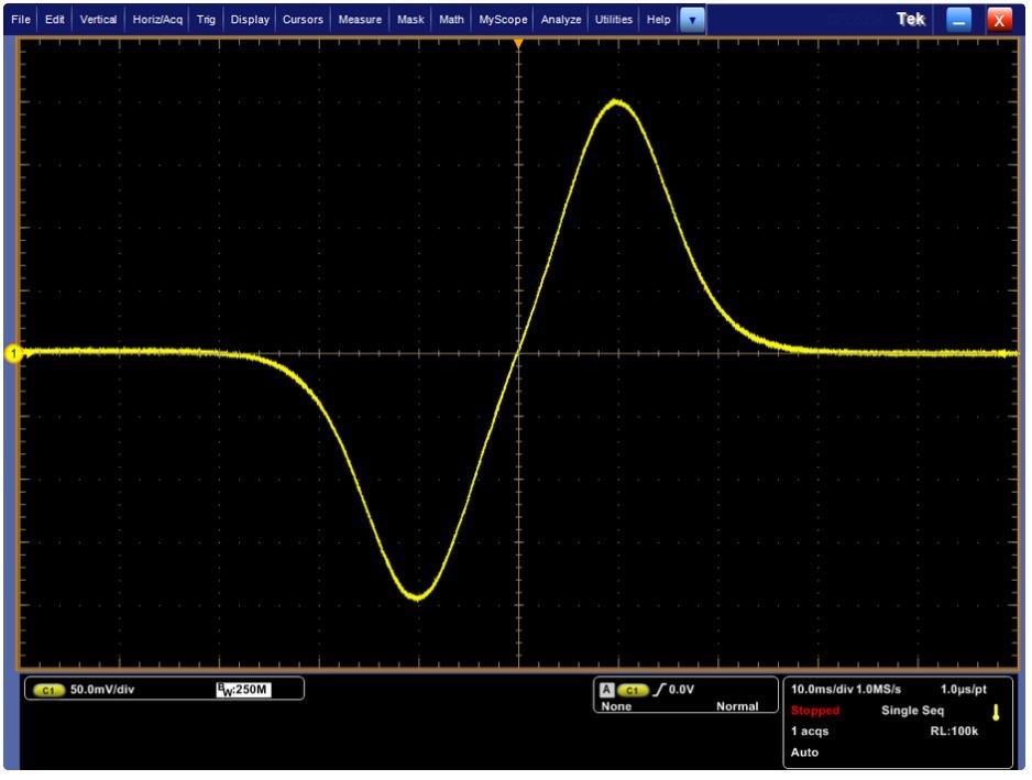

              Software is based on the very simple scheme I posted back on Dave's thread. The coil generates this sort of waveform as the magnet passes over it (not mine but from the web article with the simple software).
              This applied to an Arduino analogue pin through a 220 ohm resistor and the Arduino samples this at about 2 kHz. During the first negative-going bit of course all the samples are zero. Just after the zero crossing when the voltage is changing quickest, when it reaches a sample value of "10" the analogue input is changed to a digital output and driven high for a period (10 ms currently). Current during this period is ~15 mA, with the 220R plus the 120R of the coil itself. The coil inductance is negligible so there are no time constant issues. At the end of the pulse the pin goes low and remains low (inhibiting sampling) for ~470 ms.
              There are 4 other software functions.
              • Every 2 pulses from the coil (i.e. every second) a 20 ms pulse is sent to the clock movement coil with a 270R resistor in series. This advances the movement by one tick.
              • Slight complication is that the current direction has to be reversed on alternate ticks so this takes 2 Arduino digital outputs.
              • The seconds pulsing function is inhibited for 1 s every "N" seconds to adjust the rate, the pendulum period being set slightly short. Currently N is 132 but needs some tweaking.
              • Finally the digital output from the Hall effect device, which goes low at the extreme pendulum swing if the amplitude exceeds a limit, raises an interrupt that inhibits impulsing (but not the other functions) for the next two centre crossings. When the clock settles down then roughly there are 7 swings or so without impulse followed by slightly fewer with.

                I like the double suspension, should keep it in a very straight line, could John tell us what length/width/thickness the shim is, and how wide spaced.

                  The active bit of the shims are 10mm long IIRC, 6mm wide, 0.1 mm BeCu sheet. I found a supplier some time back, after discussion with a sales guy he said it wasn't worth selling me any so he'd send a sample. I was expecting a couple of square inches, but he sent the end of a coil of 2" wide stuff with several metres on it! Shims are spaced 15mm apart, soldered between brass strips in a little soldering jig. Here's a rather poor photo of the top end of the pendulum.  Main benefit is the pendulum doesn't twist, but it can still swing back and forth on 2 pivots.

                    As for the movement I was planning to make one but expediency won out over perfection. Anyway it would have been driven by a stepper motor, which I'd have to buy, so why not use an old movement which I've got? The hands are horrible, I need to make some better ones.
                    Every time I meet Martin at an exhibition he wants me to write up a clock – but I've made 2 since we last met…

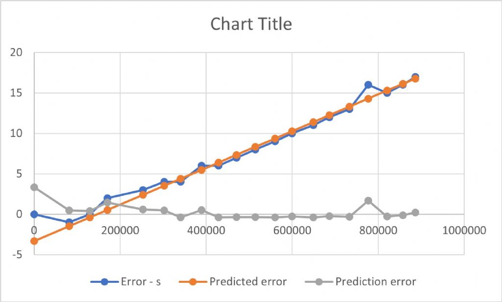

                                        Just an update after 10 days running.
                                        I've been taking twice-daily observations of the displayed time by taking a photo of the face, which my phone labels with its internal time that's locked to NTP (with a small error usually about 1.5 seconds lag). This is with the correction counter modulus set to 133 for a measured period (based on long term average) of 0.99246 seconds. The orange line is plotted from the calculated regression slope and gives a remaining rate of ~22 us / s which amounts to about 1.9 sec/day. Though the clock seems pretty stable obviously I don't want to be resetting the time every few days. I'm just about to upload new software that adds an extra counter to inhibit the correction every so often. So the main counter will omit a dial pulse every 132nd swing but every time the counter goes round 204 times it doesn't. So the 132 count will make the clock a little slow but every 204 x 132 = 26,928 seconds it'll effectively be advanced a second to make up. We'll see how this works!
                                        #511659
                                          Looking good, John
                                          … any idea what caused those two anomalous bumps ?
                                          #511841
                                          John Haine
                                            @johnhaine32865
                                            I've no idea Michael – of course if the rest of the numbers after ~5 days weren't so flat I wouldn't be surprised to see them! There is an inherent potential error in the reading process in that it involves taking a snapshot, which might be just as the second hand has moved; or just before it does; so that's +-1s. Then there's usually a small difference between "atomic" time (NTP) and phone system time which varies by a second or so. Put those together and you could easily account for +- 2s, but then the rest of the numbers look very stable!
                                            New software is now working, after a false start when I produced a new version with too many things "tidied up" that didn't work at all. So I went back to the previous working version and put in just the changes needed and it seems to be working OK now. I'll go back later and tidy things up. As always with clocks, time will tell!
                                            #511893
