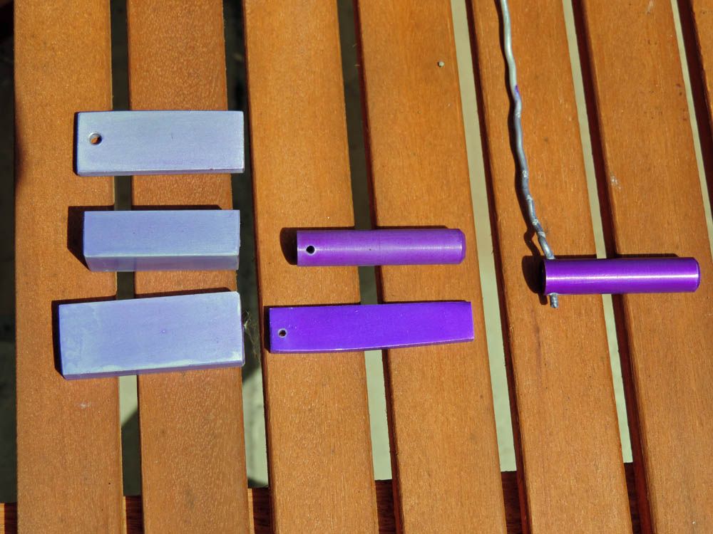

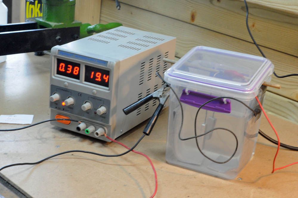

      I've been having a first go at anodising. I've been intrigued by a few comments on the web about using Sodium Bisulphate as a substitute of Sulphuric Acid. My setup is a 30V 5A bench power supply and some lead cathodes in a plastic food container.
      I used a commercial dye bought, like the Sodium Bisulphate, from ebay.
      Results are as follows:
      On the left are the first attempt in 25% Sodium Busulphate. A 720 rule calculator suggested 0.3A for the size of specimen. Very disappointing. I used some Ti wire to support the specimens and it seemed to be very difficult to maintain a current flow.
      I have some legacy Sulphuric Acid which I have diluted down to the legal (in the UK) 15%. The middle specimens were anodised in this solution at 0.5A and I used Al suspension wire. Very happy with the results.
      I then tried again with the Sodium Bisulpahte but with Al suspension wire. Again, it was tricky to get a really good contact with the specimen to achieve a current to flow. The maximum current I managed was 0.3A with the voltage turned up to the 30V max. The result was the specimen on the right, indistinguishable from the middle specimen.
      I'm afraid the "experiment" was not very well designed – too many variables changed at once but it does seem that, given the right conditions, Sodium Bisulphate does work for anodising. 15% Sulphuric Acid is also perfectly good and would appear to be a little easier to use but not so nice to handle and store. I also don't know where one could buy even the legal 15% solution.
      Anyway, I hope this helps anybody wanting to do some home anodising. Look out for model engines with purple heads and spinners.
      Cheers,
      Rod

          I too have seen the use of Sodium Bisulphate on the web and have also bought some of it to experiment with but have not got round to trying it yet, so your efforts have encouraged me. I was wondering what strength of solution to use and see you opted for a 25% solution. Was that percentage based on anything other than a stab in the dark?
          I have heard that the solution does not keep well which may be a disadvantage. The chemical is not that cheap so could be quite expensive if it is a case of use it once then have to throw it out. It might however be the only way to anodise if Sulphuric Acid is impossible to source.

                I used diluted Sulphuric at about 12%. I found that I had to 'polish' the Ti wire and bend it into a 'springy shape' to ensure good contact. The work MUST be freshly 'stripped' in NaOH or you won't get any current.
                You can tell if it isn't working as the current will be very low. The middle diameter tube here is 76mm and I only used a 4A 12V transformer so you can do pretty large pieces. By the way I had no trouble getting 3 to 4A at 12V:
