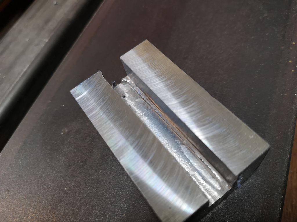

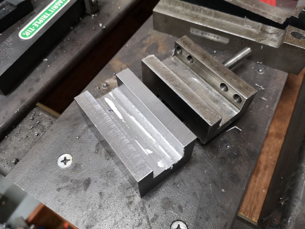

      After taking the time to clean, square-up, mill to size and slot a part:
      When it came to widening the slot (from 10mm to 22.8mm), the 10mm 4 flute milling cutter decided to dive into the work:
      … and I have no idea why.
      The part didn't move (it was still tight on it's parallels), so either the cutter was pulled from its holder or the quail was pulled down. However, although the quill was not locked (is this compulsory?) it was set to wheel (rather than big-pull-down-leaver-thing [scientific name]).
      Any ideas?

            Looking at the picture seems you were climb milling to increase the slot width.
            Edited By Emgee on 19/05/2020 13:54:53

                  The bottom picture, looks like the tool grabbed as soon as it got into the cut with travel from left to right.

                    No, that's the end of the cut. It started shallow then went progressively deeper.
                    The cutter started to spin in the collet near the end, then carried on going, then span at the very end.
                    I was cutting from right to left on the edge closest to me – I think this is conventional milling.

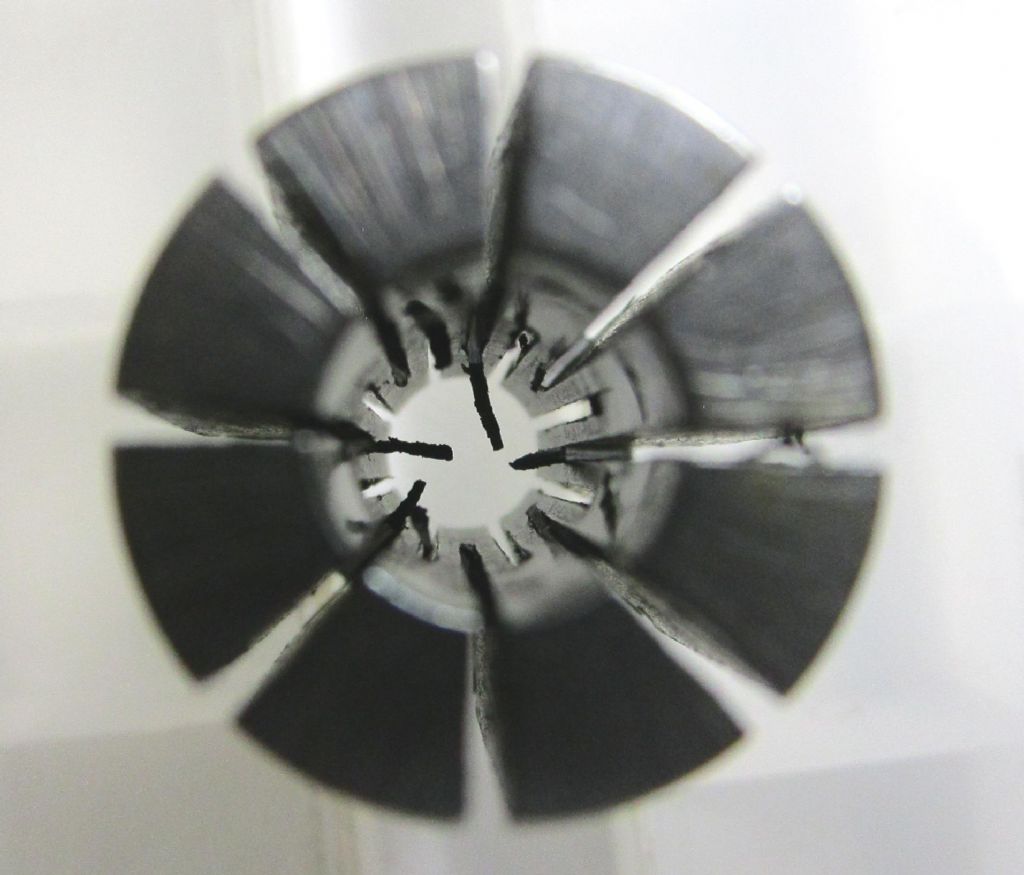

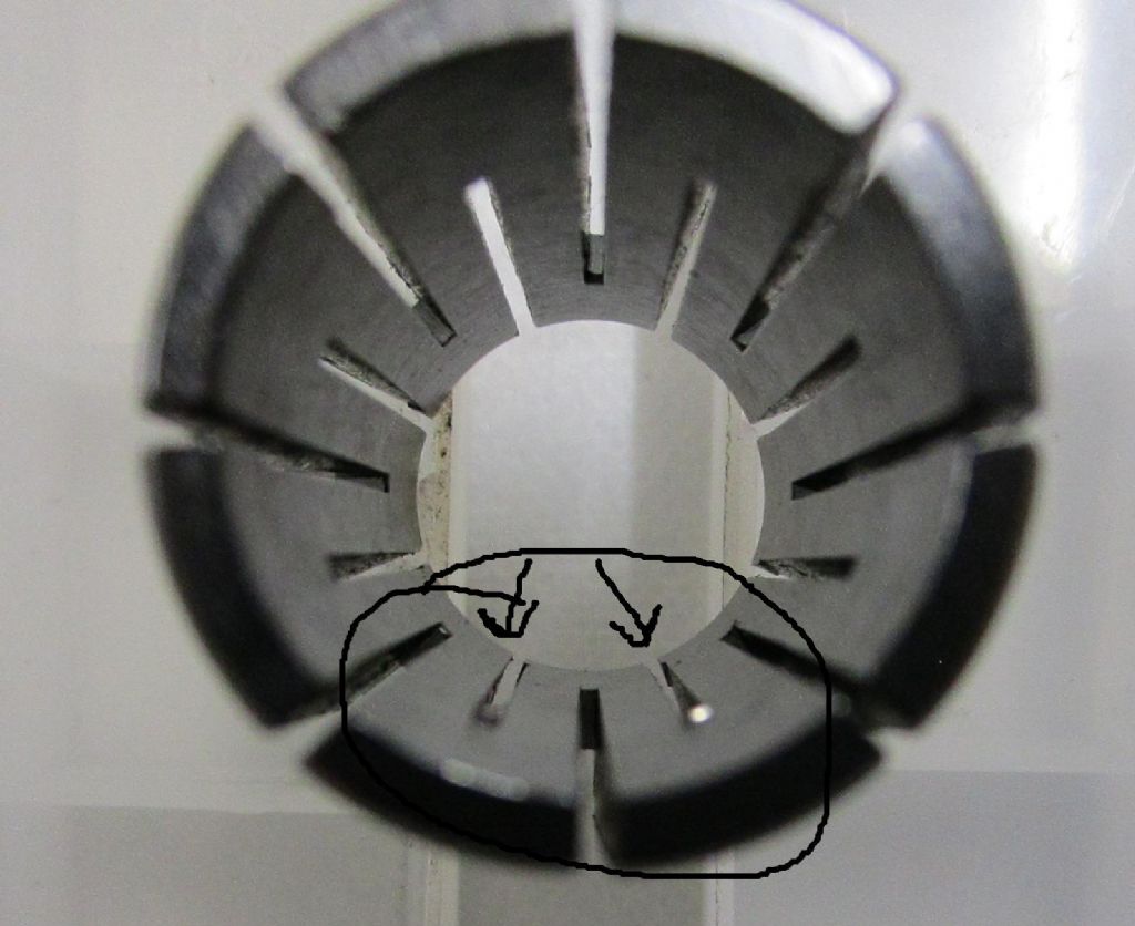

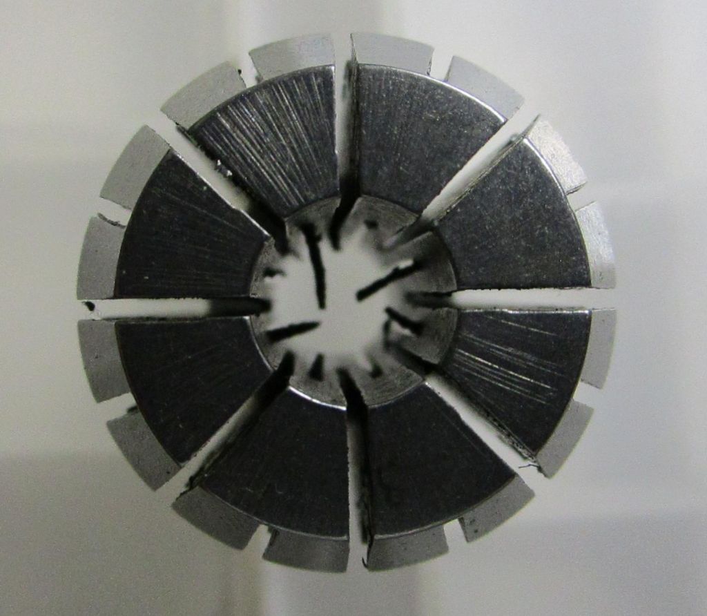

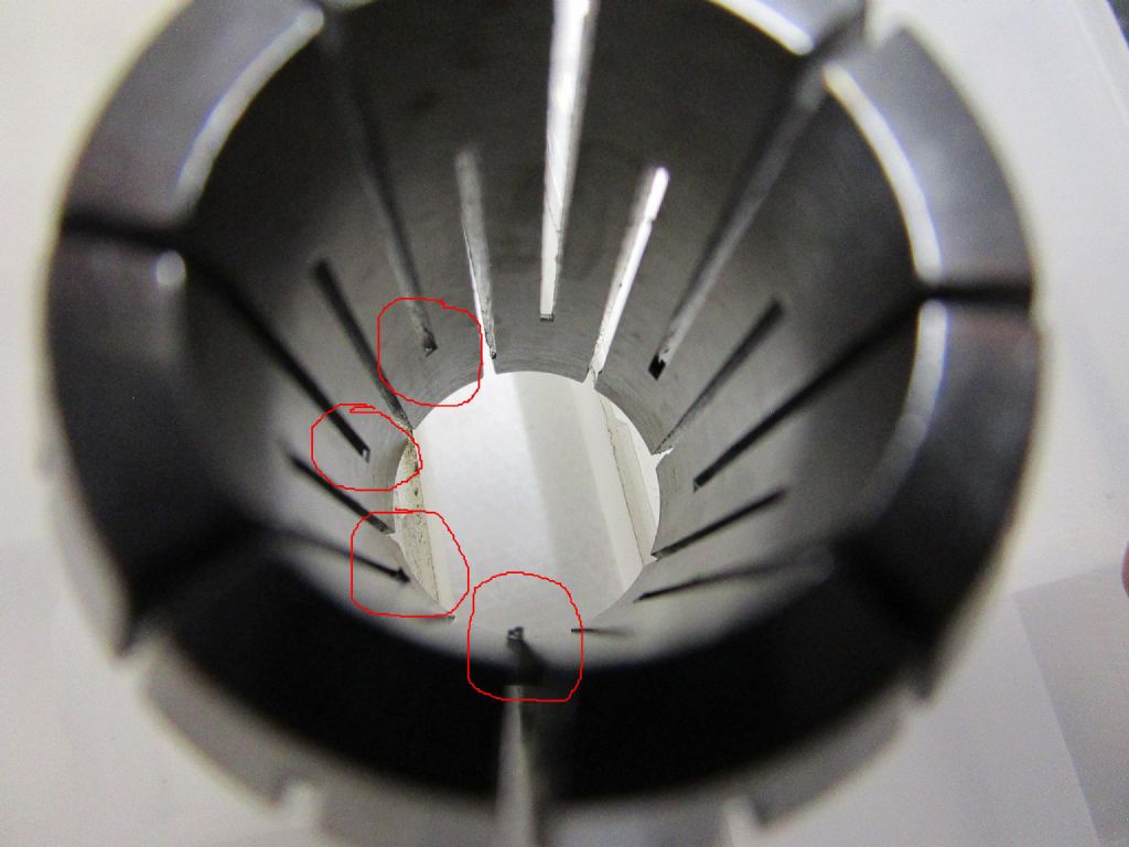

                          One other thing with cheap collets, check them very carefully for burrs and swarf in the slits. I use a Stanley knife blade to make sure that the slits are clean and burr free. It doesn't take much for a loaded cutter to pull down.
                          I thought that I had posted some pictures showing some of the worst of mine ! After cleaning properly they are fine.
                          This is the sort of thing that will cause all sorts of problems. If the collet has been used before checking, these bits of swarf will get squashed and be both hard to see and even harder to clean.

                                Oh my goodness. Talk about a case of you don't know what you don't know!
                                • A 10-11mm collet was used
                                • The collet was not properly inserted/clicked properly into place (at least not intentionally!)
                                • The collet needed de-burring
                                Right, what else do I need to know – tell me everything! smiley

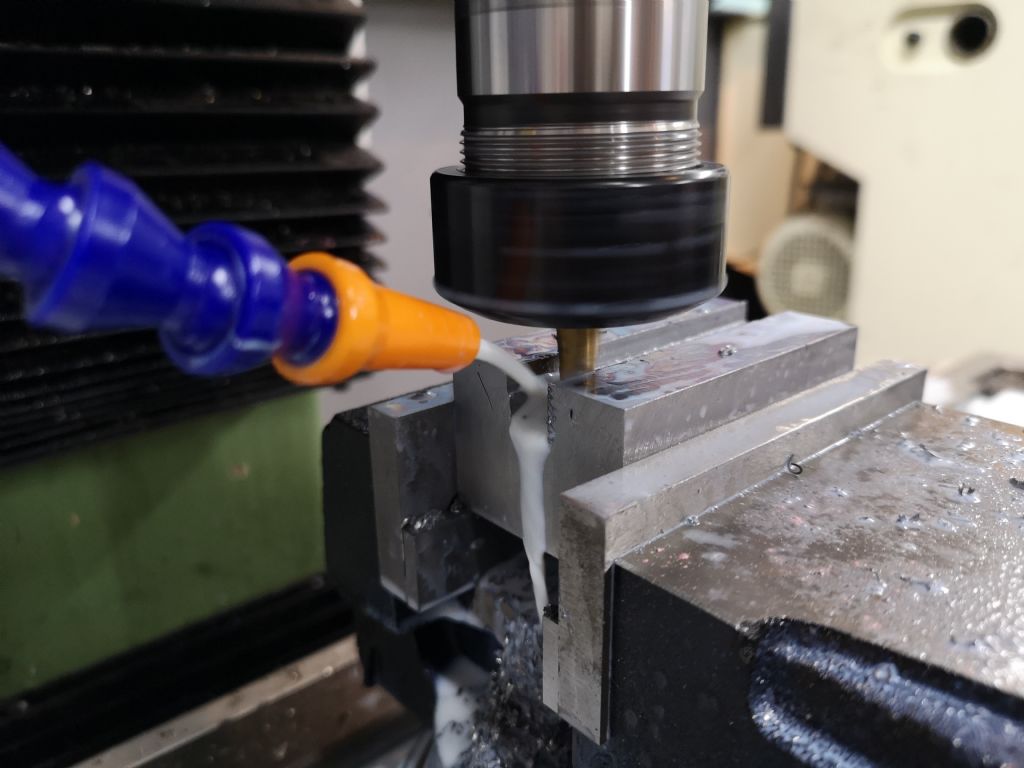

                                                Grabbed a new, never been used before cutter (12mm 4 flute) this evening to clean up the mess.
                                                Made sure to deburr the collet, put the cutter in properly into the holder and had at it.
                                                Pretty happy with it in general (cuts are on the flanks of the slot – not a lot I can do about the bottom).
