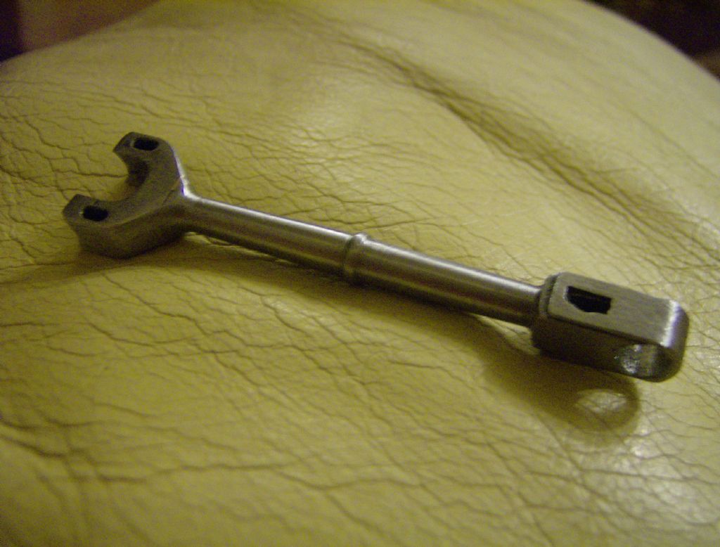

      And just finished the strap for the big-end. You can see a bit of an error on the slot in the strap

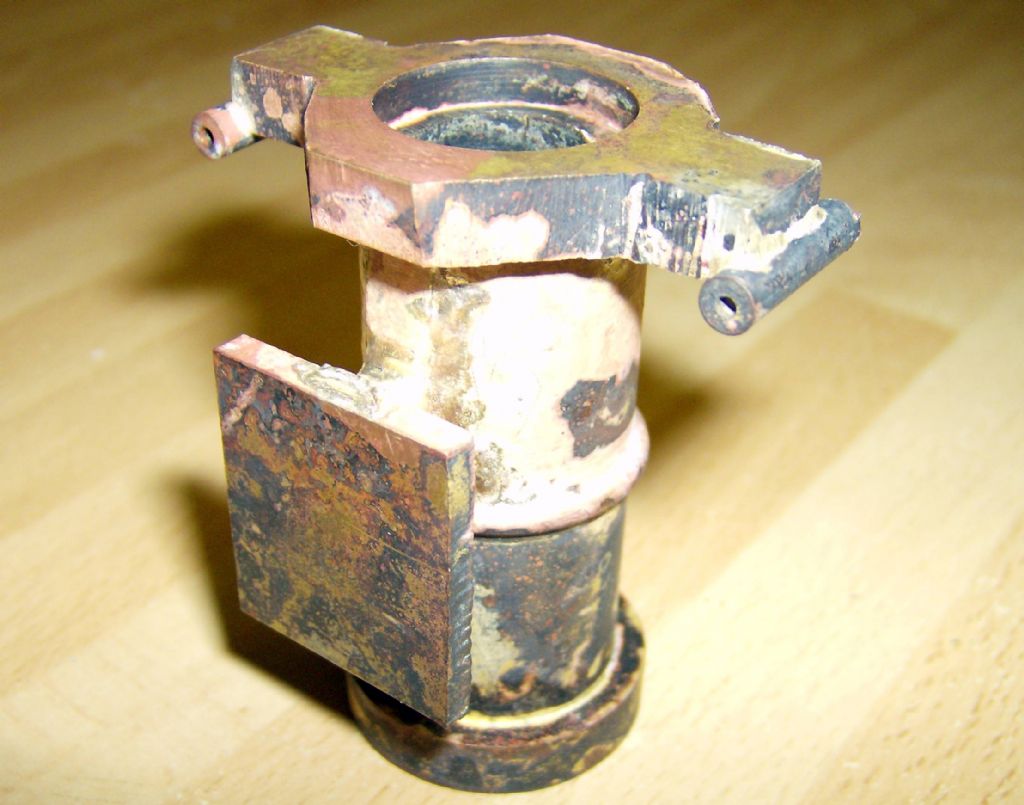

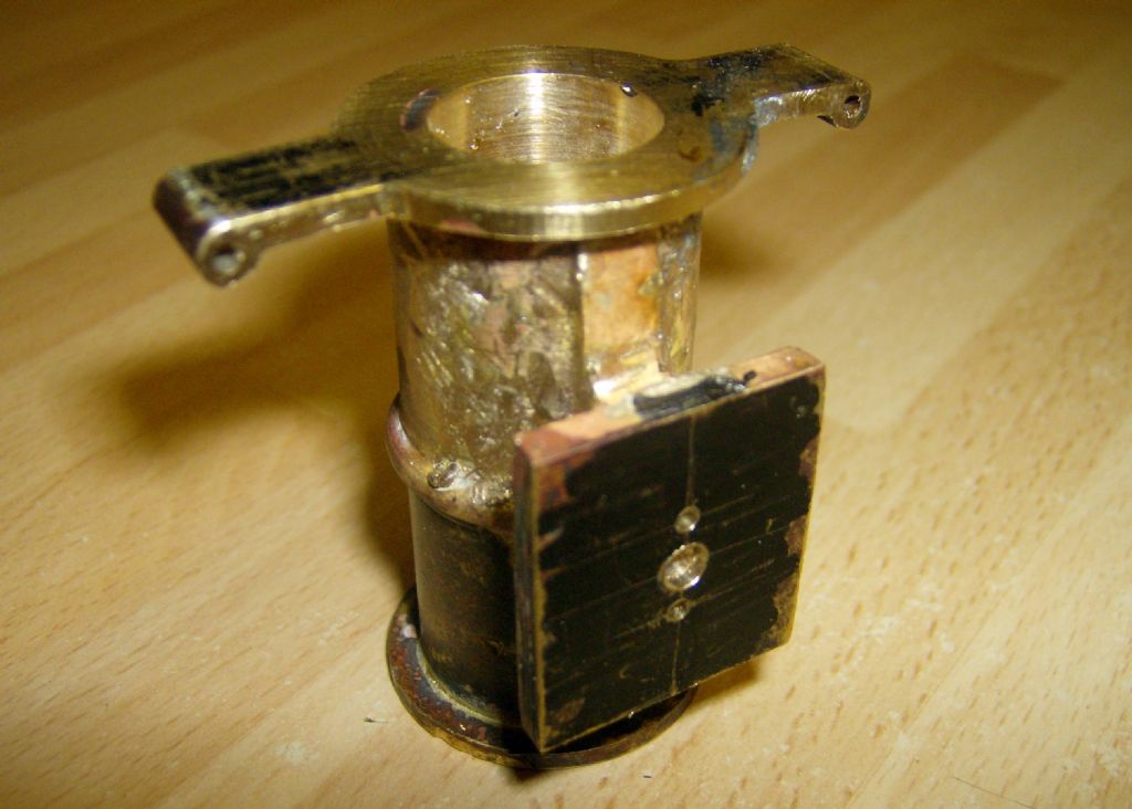

            The a-frame was cut from 3mm plate, plus additional strips for the ribs. I shaped these over the plan and drilled them and the farme about number 60 and used soft iron wire to tie everything together. On silver soldering the holes filled up. Afterwards I cut off the wire and filed it down, then milled the frame to width (the ribs are thicker on one side than the other).
            The cylinder is a fabrication as well.
            Fabricated cylinder unmachined
            After partial machining:
            Fabricated cylinder part machined

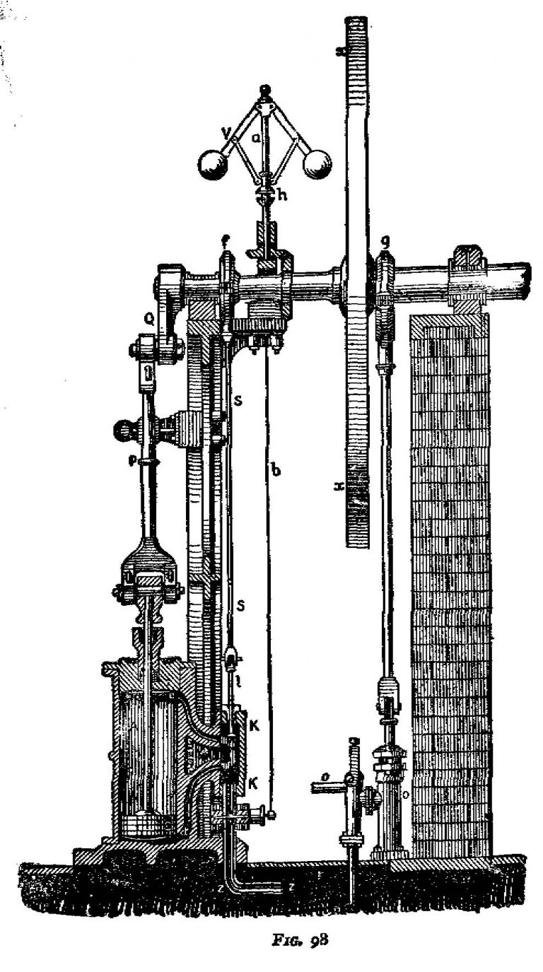

              This is one of the engravings. if someone can identify the source (I can't find it in any of the old classics, like Tredgold), I'd be really grateful:

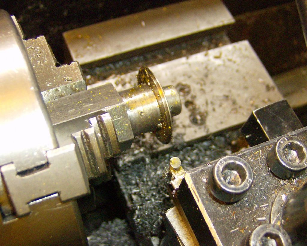

              Some pictures of bits along the way. Making a gear cutter:
              Making gear cutter
              The governor gears (80 DP, 50 and 25 teeth):

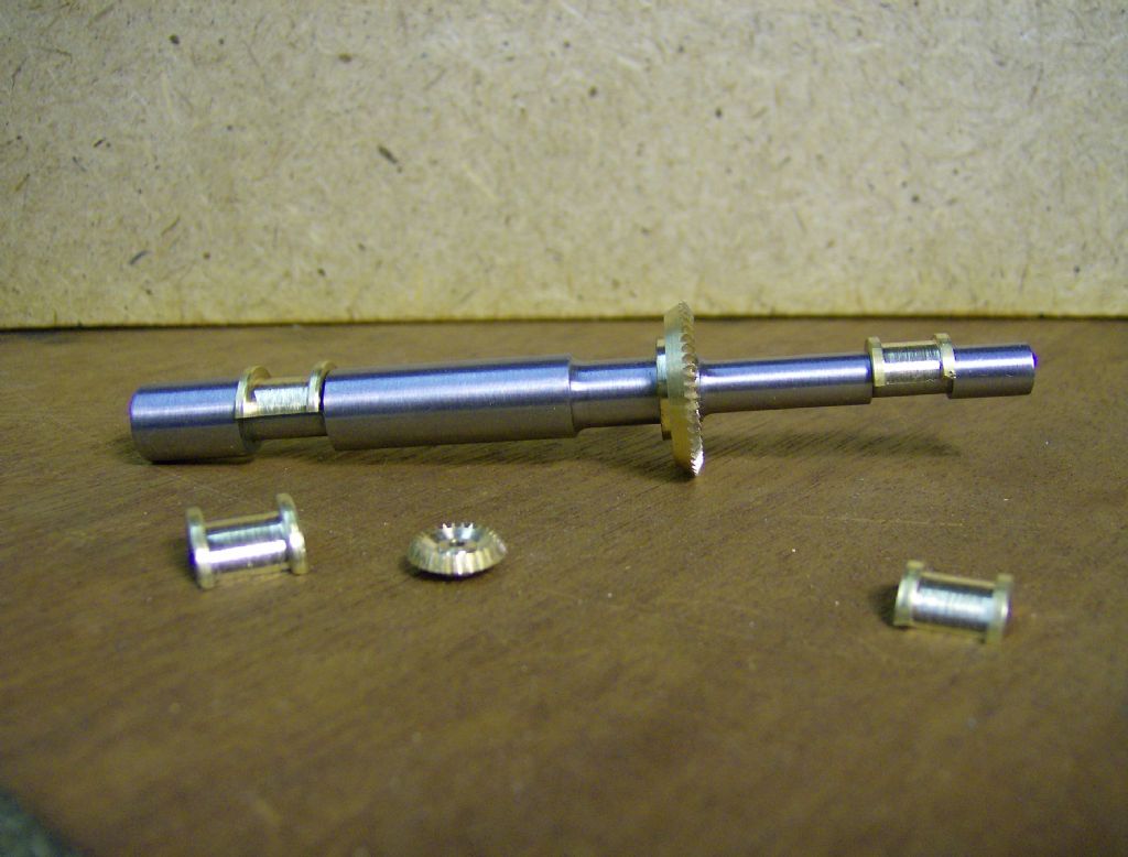

              And the crankshaft with its unusual journals:

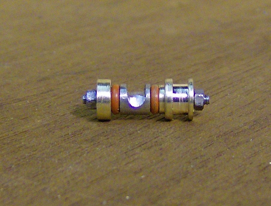

              These are the internals of the governor valve:

                I fixed the strap – by soldering a chip of swarf into the notch, and then filing to shape.

                  #214702
                    Hermann Von Helmholtz, on the Application of Force.
                    #214712
                    KWIL
                      @kwil
                      Hermann V H of Resonator famesmiley
                      #214720
                        I knew I'd heard of him before.
                        Sadly the paper contains no information on the engine, it's just used to explain how they work. All it does is date it to pre 1862-63.
                        Lot's of interesting stuff in the full book if you go up a layer.
