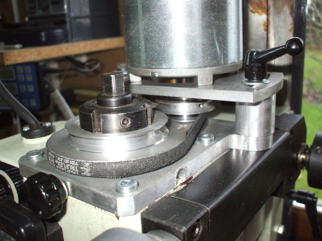

            I bought one of the earlier ones the same as the mill referenced in Dave's link. I note that the report is dated 2017, however the comments are still valid. The model I bought was a two-speed geared one. I broke the nylon gear in pretty short order, most probably due to my inexperience and I replaced them with a pair of steel ones ones which were intended for one of the mini lathes around at the time. They shared a lot of parts. Not entirely happy with the geared head I made my own belt drive conversion which transformed it into a quieter machine. The latest incarnation with its modern motor and associated electrics looks to be a step change again. A big advantage is the square vertical column but I found the spindle travel notchy and not easily controllable. Otherwise it did what I wanted it to do. You're never going to rip great chunks of metal with it but if you are prepared to accept its limitations, I'm sure you'll get along fine.
            I added a digital caliper style 3-axis DRO system form ArcEuroTrade which was a useable low-end arrangement but never entirely satisfactory. I sold the machine when I returned to the UK from France in 2015, replacing it with a Warco VMC.
            Here's the mill belt drive conversion:
            Belt-drive conversion
