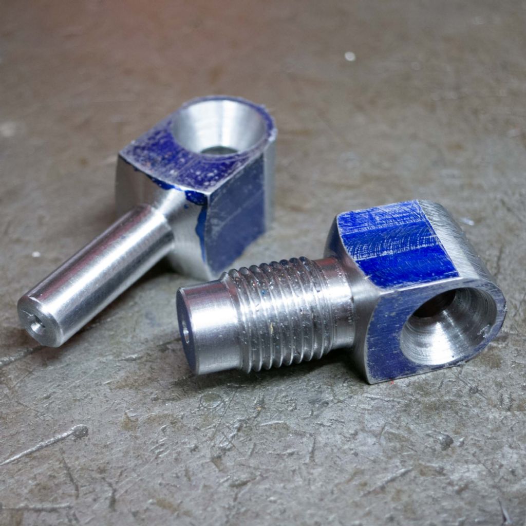

    William Chitham
      @williamchitham75949
      I am making a DTI holder from drawings by Stefan Gotteswinter. He specifies that some of the parts should be hardened and, presumably, tempered. These bits (not finished yet) are made from 01 Tool Steel, I am pretty confident I can harden them by heating with a torch then quenching in oil but not so sure how to go about tempering – or if that is even necessary? I understand the principle of reheating and watching for colour change but that usually seems to be done on larger parts where the heat can be applied at one end and the colour change observed as it migrates up the part. These are only 30mm long overall and besides I think I want the whole thing at the same state. Any advice would be welcome.
      Edited By William Chitham on 17/03/2021 11:23:55

          You should be able to take them down to about 60 Rc in a domestic oven on max (c. 250 C)?

            Tubal Cain (T.D. Walshaw) in one of his books, Workshop Practice Series No.1 on Heating Tempering etc suggests that one could boil the parts in water: this would achieve some grain refinement, achieve some minor tempering and presumably reduce the brittleness.
            Another idea would be to heat in a tray of sand until the items achieve the same colour as the sand.
            I should point out that I haven't tried either idea – they are "parked" pending a suitable opportunity to try them.
            Also, as Mick suggests, you can stick them in the oven! Again Tubal Cain has some pertinent remarks as to the best time to do it, eg when the household cook is making scones, roast beef, or whatever!

              Hii William, I've done a fair bit of heat treatment in my time and would definitely recommend the use of hot sand.
              I have a tin of dry sand which I heat before the parts are introduced. The sand does need to be quite hot throughout beforehand otherwise there will be a temperature difference which, depending on the shape of the part may induce a colour variation .
              I heat mine on one of those small gas camping stoves. Once hot the part, previously heat treated and cleaned back to parent metal and devoid of any oil (most important) is pushed down in the sand and constantly turned within it to ensure even heating throughout. Depending on the size of container you should be able to do both parts at once to get a degree of similarity but personally I would do them singly keeping a very wary eye on the colour changes. Drop the part in oil as soon as the colour desired is reached
              One thing to particularly note is – if you are not happy with the degree of colour once quenched eg not dark enough the part will not change colour further if reheated unless the colour as first quenched is removed back to shiny metal again. It will just remain at that colour but it will continue to temper further.

                I have tried boiling parts in water as Peter suggested but found the tempering effect to be rather small ( only 100 C ) and parts of any complex shape still broke. It might work okay on "blocky" shapes not subject to shock loading. The oven ( up to 250 C ) works better.
                There are Youtubes on making simple muffle furnaces from baked bean tins and fireclay, and powered by a propane torch which should give more controllable results, up to maybe 650C, which might give a tough result rather than a brittle one. Might more consistent for the initial hardening, at a higher temp, as well as the tempering. Not tried this myself.

                              Thanks for all the suggestions. I don't suppose I would ever wear them out if I didn't harden them but I am using the project as a way to learn new things and I haven't tried heat treating before so… I think I will go ahead and harden them then heat treat in the oven, not least because that will be an excuse to cook a pizza this weekend. In the oven is it a case of holding them at temperature for a certain time then letting them cool gradually?
                              Of course I might be remaking the parts as tonight's challenge is to mill the dovetail slot in the end of the threaded one with a home ground cutter.

                                William – your original post suggests you wanted to 'colour' them so I suggested hot sand as the best method of controling that in the home workshop. You can indeed put it in with your pizza but the temperature required to get the part to a decent blue black will give you a very crusty edge and topping!!
                                Colouring as you describe, by heating and watching the colour rise up is usually carried out when making tools – quenching usually occuring as the 'pale straw' reaches the tip. That is not tempering in the true sense in that the part has not had time at temperature to temper fully. I first saw that done as an apprentice on the shipyard by the blacksmith heat treating my new chipping hammer made from an old file!
                                At one time In my working life I made, on a daily basis many, many small parts from various tool steels but mainly B01 Arne (gauge plate equivalent). These were heat treated correctly and tempered accordingly – usually for two hours per inch of ruling section and twice at that ie quenched after two hours and then repeated. Colour of course was none existent just a manky oily black but hardness was checked throughout the batch to ensure uniformity.
                                To achieve a colour, and a uniform one at that, the temperature has to be even and specific to have any degree of control (of the colour). Kitchen ovens aren't usually hot enough to reach a dark colour.
                                You could, as said, leave them as they are – unhardended. I have collets for my mill that I made circa 1984 from the same unhardened 01 tool steel and they are still in use today. Colour or even blacking could then be done by gentle heating and quenching though it will not be hard wearing or by any of the cold blacking methods which will fare much better

                                  Sorry Tug, thanks for your informative replies but my reference to colour was just in terms of using it as a guide when tempering. I plan to cold blue these parts when finished, I have some Phillips bluing solution which works well.
                                    William.
                                    Wouldn't be the end of the world if the items were left unhardened because they're unlikely to wear much in ordinary use. No harm in hardening of course, but it wouldn't be the end of the world if you didn't bother to temper them either! Hardening tends to leave metal too hard and a bit brittle, so tempering sacrifices some hardness in exchange for improved toughness. Hard working components benefit from this trade-off, but a DTI holder doesn't sound critical.
                                    All good experience though, but the timing is important.
                                    1. Pre-heat the tempering oven to about 200°C
                                    2. Heat the items slowly* to about 800°C, and hold them at that temperature for 1 hour per inch of thickness, plus 15 minutes per additional inch. (*Slowly means raise the temperature by 200°C per hour per inch of thickness.)
                                    3. Plunge the items into oil and then immediately transfer them into the tempering oven. Don't let the temperature of the items drop below about 50°C, so work quickly!
                                    4. Leave in the oven for 1 hour per inch of thickness, and always for at least for 2 hours.
                                    This complicated recipe is needed to harden and temper for best results and it's a good deal more scientific than what I do with a blowlamp! In practice, small items don't seem particularly fussy, but I don't have any way of measuring how hard and brittle my results actually are. All I want is the metal to be a bit better than the un-heat-treated version, i.e. harder, and not too brittle. It mostly works.
                                    My limited experience for what it's worth: 800°C seems important, over cooling in the quench is definitely bad, and not letting metal soak long enough at 200°C may explain some disappointments. I'm not sure about getting the item into the oven before it drops below 50°C because I always bung it in as soon as possible, and in any case have no way of confirming if the metal really is still hot enough. Results are mixed, most common problem is too brittle.

                                                The critical point is to get it hot enough, and heat it long enough to allow the transition from face centered to body centred (or the other way – I forget which).
                                                I always quench to full cold then temper. Tubal Cain actually writes quench to not more than 50 degrees – I.e. cooler than 50.
                                                Now I have a kiln I tend to use that – it’s got good control and I can bung the parts in and ignore them without risking overheating the tempering.
                                                I did have a deep fat fryer – turned up to 190 and again little risk of over temperature. Not good for higher temperatures, but “yellow” for most things I do seems enough. The parts don’t change colour unless exposed to air as the colour is caused by the thickness of the oxide forming on the surface.
                                                There is no problem with the length of time at temper temperature as far as I know, just that higher temps draw the temper more.

                                                  Well, as I said I spent quite a lot of time at work responsible for the heat treating and grinding of small parts from Uddeholm 'Arne' B01 as well as other tool steels from the same supplier.
                                                  That was twenty plus years ago but to my surprise the heat treatment sheet for Arne as provided by Uddeholm then was identical to the one I have just looked at now here – page 4
                                                  We followed this procedure to the letter heating in Wild Barfield ovens to very controlled temperatures before quenching to room temperature in (whale) oil and carried out the tempering in a separate oven designed for that express purpose. When we began this process at first the initial batch went into the tempering oven with residue oil on it which created a considerable amount of smoke. From that point, after the initial quenching, these parts – they were mainly punches and anvils for small press tools and would be done as batches of twenty hanging in a mild steel carrier, four carriers to a load so eighty parts in all – would be dropped into very hot water and a product called Citri Kleen. This was a potent degreaser, the oil being rapidly dispersed and the parts were allowed a short time to dry off then placed in the tempering oven. As previously said that would be done twice so the parts would see a Citri kleen bath three times before grinding.
                                                  Arne B01 is basically the same as guage plate and is ideal for home based heat treatment. What is difficult to obtain and be aware of when flame hardening is the actually temperature at which to quench. 'Cherry Red' is an oft quoted state but that can vary as much as the amount of different people attempting it. What I can say – with certainty – is that when these parts came out of the oven having been at the correct temperature 800-850 depending on harness required they came out a very dull red indeed. Over heating then to a bright red or leaning toward orange is too much and will, if overdone, lead to a crystaline and brittle metal structure.
                                                  As Dave S has just remarked, time at temperature does not affect the degree of temper but a variation of temperature most certainly does which brings me right back to the beginning – the best thing outside an oven in the home workshop is a tray of hot sand for about as best control as you can expect

                                                      Posted by Dave S on 17/03/2021 22:16:46:
                                                      I always quench to full cold then temper. Tubal Cain actually writes quench to not more than 50 degrees – I.e. cooler than 50…
                                                      An apparent contradiction, easily explained! I said don't let the temperature drop below 50°C because William said he's using O1 which is an Oil Quenching steel.
                                                      I should have mentioned the type of steel matters, for example, I don't think Silver Steel (Water Quenching), is as fussy as O1. One source says of Silver Steel 'temper as soon as possible after hardening preferably before the tool reaches room temperature'. (My bold)
                                                      Hardening and Tempering are achieved by manipulating the metal's internal crystalline structure and the desired properties result from a careful mix of controlled temperature change and timing. The exact mix depends on what the steel is made of. Although getting consistent results to a specification requires rather careful control, home-workshop methods seem to work reasonably well for our unmeasured purposes.
                                                      There's skill and judgement in it; I've improved with practice, not because I'm doing anything clever, rather that I don't dither : heat, plunge, temper all done roughly at the right time and temperatures. Turning the lights down to judge the hardening temperature helps, as does turning them up again to judge edge tempering oxide colours.
