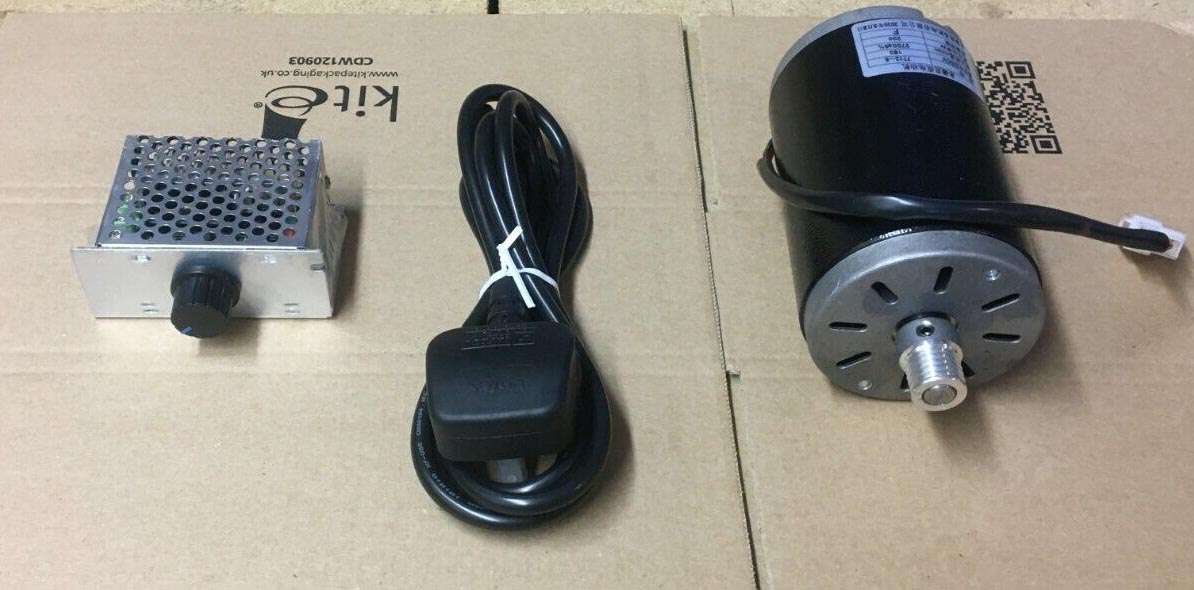

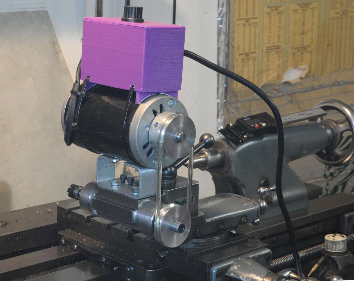

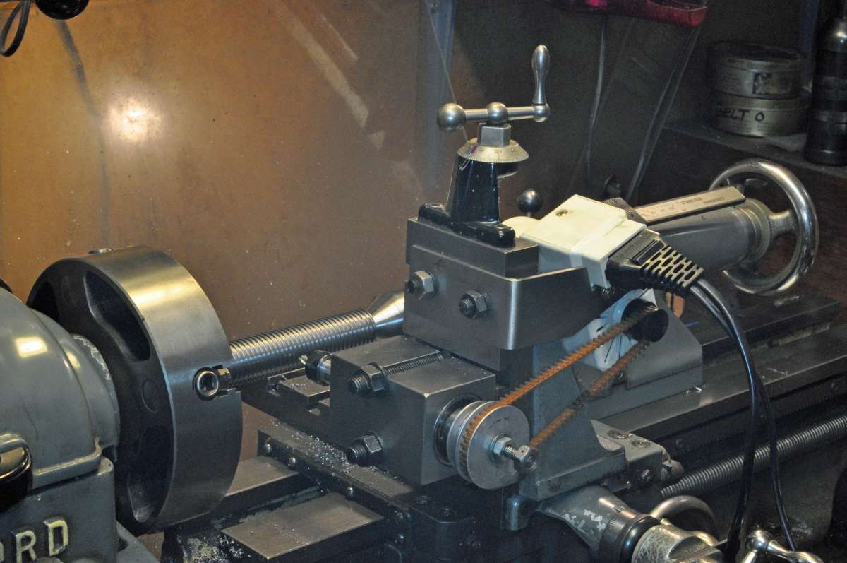

        Hi Mike,
        I’ve used a 120W sewing machine motor which works fine but the foot control is a little awkward.  Be sure to order the correct rotation direction.
        Arrand milling
        I think this is a better solution which I use on my home made tool post spindle
        tool post spindle
        https://www.ebay.co.uk/itm/256130971430?hash=item3ba2987726:g:zhoAAOSwV6VfU9NI
        motor
        Hope this helps,
        Rod

          Hi Rod, really appreciate the effort in your response and your photos, I had also found the same Ebay listing but seeing your installation has given me the confidence, thank you!
