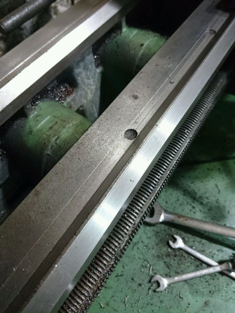

      This is a very, very open post/question, I welcome any comments, shared experiences, advice, warnings, anything, This is new ground for me and I'm not sure what to expect.
      I've received a quote to have my lathe bed reground (a Myford 280). The bed wear on the front vee is visible to the naked eye with a lip on top. I love the lathe, everything else is in fine fettle although I will be rechecking a few things when it comes to stripping it down to send the bed and saddle castings off.
      The regrind includes flats, angles and underlip on the bed, plus a record of home much was removed. It also includes regrinding the flats and angle of the saddle followed by application of Turcite B followed by regrinding again but allowing for the material removed from the bed so the leadscrew/gearbox will realign.
      I was intending on leaving the headstock and tailstock as they are. I will check the fit of the headstock onto the vees and flats and panic as required if/when I discover the fit is not exactly the same? (Is this silly?)
      I don't know what to expect, will the spindle bolt back down nicely or will it need scraping in – would it benefit from scraping in anyway (I like scraping, but some things are just best left alone/to the professionals!)
      Overall, I'm really looking forward to it but I'm a bit unsure what to expect when it comes to bolting it all back together.

              Bazyle thanks, they have assured me they will be grinding the minimum possible off the bed. I did think about the tailstock and if needed, I will (attempt) to make a new base from scratch and hand scrape it to fit. (attempt being the key word here)
              I need to make a fixed steady so I will get a bit of practice in on something less important first.
              Below is a photo of the wear on the front of the vee, as you can see from the lip on top it's pretty significant thus I doubt just a few thou will do the job. The lip is so big I originally thought it was supposed to be there till I noticed the tailstock end has nothing!
              The quote has jumped from a little over £600, to a little under £900 (as he thought it was a different machine) Considering the only other Myfords all have flat way beds, the increase in price is very small when taking in to account the additional work required to grind the 4 vee faces on the bed and apply and grind turcite to an additional 4 faces on the saddle – he's going to be a busy boy!
              Still, I think I will then have a nice metric machine that will last me a lifetime with ample TLC and im only 29!!!
              Peter,
              You just replied as I was writing this. I have spoke to him and he said he will take care of it, but that doesn't mean anything if you ask me and that has made me think, I'm going to have to do a bit of scraping. I find this daunting but I'm very good with metrology so I'll just take my time – measure thrice, scape once – measure thrice again!

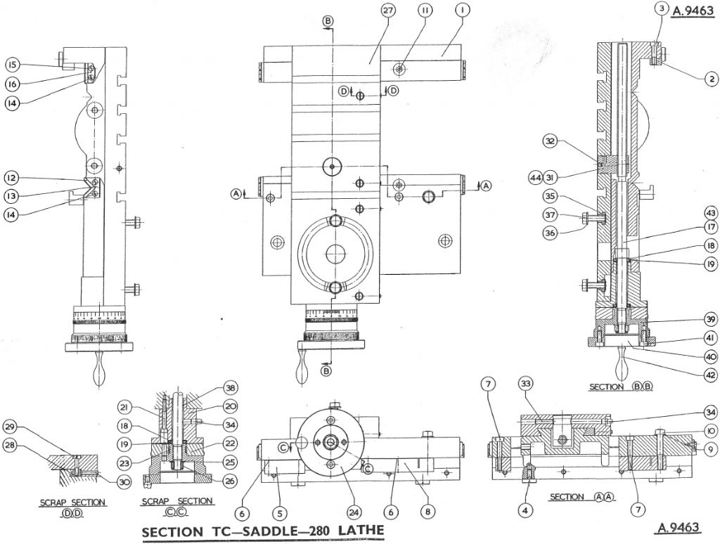

                      John, you deserve a medal for that explanation – It's like I was with you in the room!
                      My bed ways extend end to end and the headstock simply sits on the vees and maybe it touches the flats but I haven't stripped it down yet. I have been leaving the stripping job till last in a (vain) attempt to ensure I can machine/scrape any templates/standards/jigs I need before I start – its almost like I actually believe things will go according to a plan!!!
                      The process of machining the jacking plates and fitting them to the saddle sounds very very much like the easy part. This Moglice certainly opens doors and given my limited budget, and limited confidence in "as ground" fits – this is right up my street.
                      I think the cross slide will need quite a bit of scraping in anyway. It is visibly worn. I think it would be unwise to take reference from the cross slide dove tails or the bearing vee's underneath.

                        The cross slide will have to be done first because it generates a line at 90 Degrees to the spindle axis. When setting up the saddle to the bed the cross slide must work perfectly, that defined line is used to set the cross slide to face a work piece flat or a tenth or so dished over 300mm . The cross slide is almost certain to be worn at the point where most average tools hit the average bar turned. Somewhere towards the middle of its travel. Try to keep the original 90 degree geometry, take a little of each side. Remember the apron and lead screw must remain parallel to the bed.
                        By adjusting the gib's to a good fit in that so called normal average position you are almost certain to find it binds at the extreme in and out position. Any binding indicates wear. I would disassemble clean and reassemble before performing this test in case a bit of swarf is the culprit.
                        It is important the slide and dovetails are scraped so that the slide describes a perfectly straight line from end to end. Use a known straight edge and a dial indicator mounted on the slide to test for this.
                        The contractors you are in discussion with have indicated that they will use Turcite and grind it in. I guess the real question is how accurately will they align the saddle? setting it up against the spindle axis. Will they do it to the Lathes original specification?

                                                    I'm just about to leave to go to the Doncaster model engineering show so I'll be brief.
                                                    The saddle sadly is not toolroom class, as can be seen from the detail drawings I posted earlier the wipers are positioned on the front vee and the small rear flat.
                                                    Regarding the saddle extending beyond the headstock, I agree, and this must be a cost saving excercise – it would also tends to shield the ways from a lot of fine swarf.
                                                    My scraping skills are ok but I'm very good at the manual aspects of spotting which is more important in my inexperienced opinion. I'm extremely sharp when it comes to deriving accuracy and generating standards from scratch. I was a civil engineering surveyor before I got (willingly) dragged in to mechanical R&D. I have an obsession with not relying on anything for accuracy. If you have me a surface plate I wouldn't believe it was flat till I'd tested it myself and only then I'd rely on it for a short time till it was retested. This is less of an attitude/approach and more of a disorder….

                                                      Posted by Nigel B on 20/05/2016 19:21:46:
                                                      It unusual to find lathes where the saddle rests on 2 V's
                                                      The Southbend & clones / derivatives (Boxford, Denford etc.) use a "3 vee + flat" design, with the saddle running on the outer vees & the tailstock / headstock on the inner vee + flat.
                                                      On the pre-gearhead Boxford (and presumably the others) the whole "formation" was gang milled at one setup on a duplex head horizontal mill.
                                                      Nigel B
                                                      blushI must have been in cheap chinese lathe mode and thinking of various things I have seen. I have a boxford and yes the saddle does run on 2 V's. The 3rd V is added to align the head and locate the tailstock – less wear on that as it doesn't carry the saddle. The slideway grinder sub table can automatically take care of aligning the saddle V's with the bed.
                                                      I had a long chat with some one in Worcester some time ago who at the time had recently bought a brand new slide way grinder. I vaguely remember him saying that the tailstock can also be done at the same time but not sure about the head. The company seems to have disappeared.
                                                      The Boxford saddle slides do pass the head. All it means is that the head needs to neck in at the bottom or be narrower than the outer V's. One interesting aspect of that on a Boxford is that a lantern toolpost would place the cutting loads more central than a quick change. The travelling steady is designed to be used with a lantern tool post as well. It mounts on the tailstock side of the saddle and doesn't reach far enough for a quick change. Really they should have changed this sort of thing when they started supplying 4 way tool posts.
