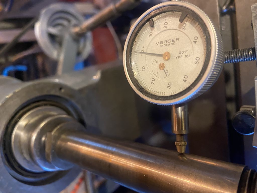

      It was inevitable really that the proper fun and games would start once I had got it back together. Any mill manufactured in 1941, with bearings marked 1939 is going to be a challenge.
      I have done some test cuts – not too bad but a little chatter and a “throbbing” noise which indicated (I presume) that something is not quite aligned right. I adjusted the belts which improved it somewhat, but it’s still there.

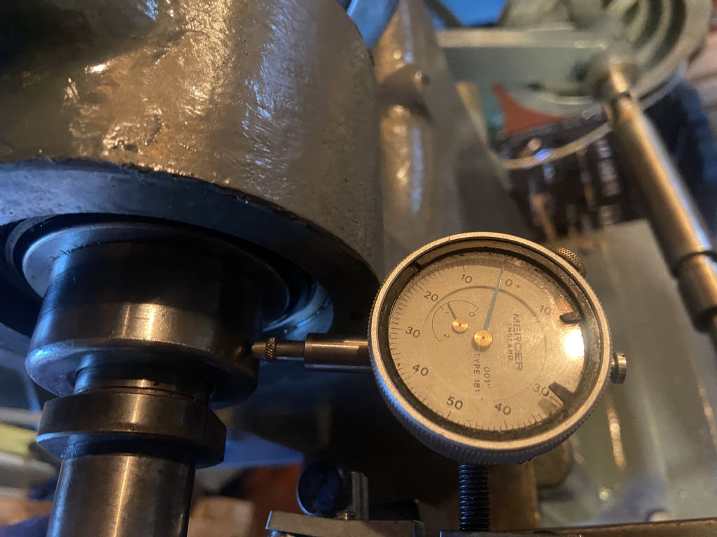

      Putting the dial indicator on the spindle I get 0.001 runout.
      on the flange (?) of the spindle, I actually get more runout, about 0.00175
      But interestingly, on the spindle near the *rear* bearing I seem to get no perceptible runout…
      All this seems to indicate that the front bearing isn’t quite seated correctly, or is not adjusted / malfunctioning.
      I suppose the spindle could be bent.
      I didn’t manage to get the front bearing off when cleaning up the parts. It was well and truly stuck on the spindle and I didn’t want to bash it and risk damaging it. I don’t really know how to remove it.
      Spindle out and reseat the front bearing?

          What runout does the arbour show?
          The drive pullies will show more than 1 thou runout and the belts won't care.
          BTW there are some £25 gear cutters out there that have a lot more run out than that.
          When you cleaned the bearing did you spin it dry on the shaft? Damaged ones will catch.
          Whats the end float on the shaft?

            Looks like I fixed it, disassembled, cleaned it all up, put it back together very carefully. Now I’m getting less that 0.0005 runout at the spindle, which is probably surface imperfections.
            The mill still makes a throbbing noise though, but the surface finish looks a lot better.

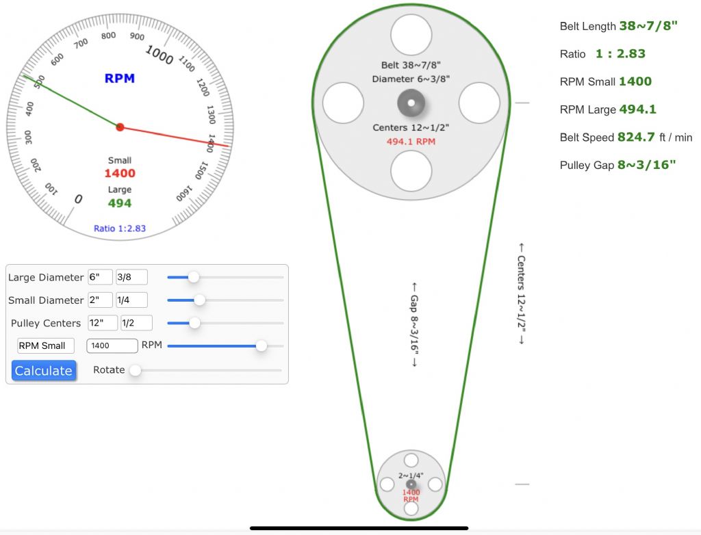

                                              #578112
                                                Posted by Steve355 on 02/01/2022 14:59:36:
                                                But the fastest it can go is 3 ipm at 250rpm.
                                                Something is not right about my mill!
                                                You said the 3" was with it in the slowest speed of the feed pullies, what is it in the fastest?
                                                #578204
                                                Steve355
                                                  @steve355
                                                  3” is with the pulley that gives 250rpm on the spindle
                                                  Obviously with the spindle running faster the feed will be quicker. But as I understand it I need the spindle running slower (say 120 rpm) and the feed running faster, or at least the same.

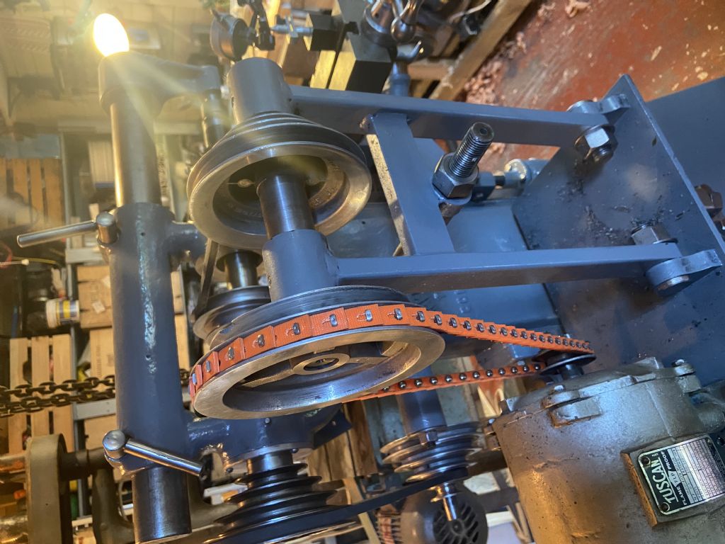

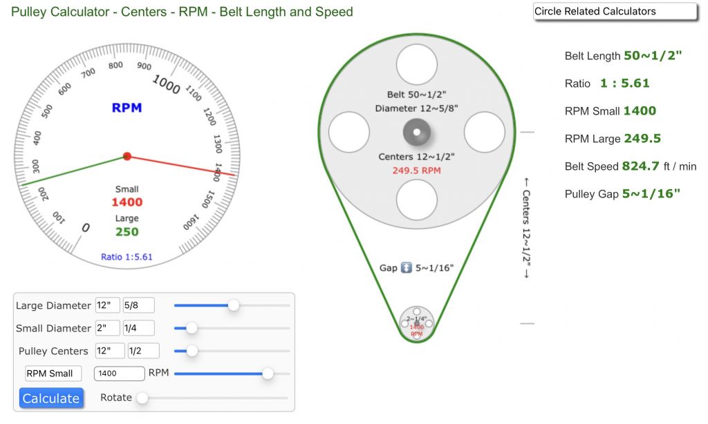

                                                  Right now it’s like this, with the motor pulley being the small pulley and the large pulley being the driver for the countershaft… this gives 250rpm at the spindle.
                                                  Perhaps the easiest/cheapest way to fix it is to increase the size of the countershaft pulley…
                                                  Which would give 125 rpm ish at the spindle, a lot closer to the ballpark needed. But the feed would be 1.5 ipm.
                                                  I saw an advert for later versions of the mill, which had a hydraulic system for feeding the table. Perhaps that was a solution to the inherent difficulty of having a suitable feed rate and low spindle speed.
                                                  thoughts appreciated 🥺
                                                  Edited By Steve355 on 03/01/2022 10:40:18

                                                    #578217
                                                    Steve355
                                                      @steve355
                                                      Posted by Dave S on 03/01/2022 10:49:20:
                                                      How is the feed taken off?
                                                      Could you change the spindle pulley and a subsequent feed pulley to give a more appropriate ratio?
                                                      I don’t think so, the feed pulley for the spindle is about as small as it can be and the spindle pulley is about as big as it can reasonably be. See pic below.
                                                      I feel a vfd coming on, wallet is getting worried.
