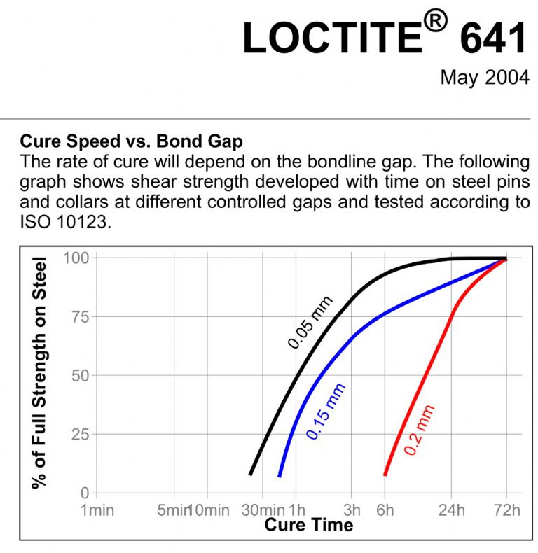

      Maximum gap fill on diameter for LOCTITE 641 is quoted as 0,2mm or 0.008" .
      Sorry to labour this, Neil, but may I ask how you came to that conclusion. question
      My working assumption is that you must have mis-interpreted this graph from the Technical DataSheet:
      • Bondline gap is [in a typical repair situation] a radial measurement, not a diametral one.
      • Three representative examples of curing behaviour are shown … but these do not represent the extremes of its useability.
      ​If you have supporting evidence for your claim, I would be very keen to see it.
      Until then, I remain very confident that 641 would do what Frank needs.

            Hi Michael, that's a very good question and I hope that I can answer it.
            If you follow the link in my previous post it will take you to the LOCTITE Retaining Compound Design Guide. If you look at the bottom of page 14 you will find a paragraph on joint gap where it refers to the gap as being "diametrical". Also the chart on page 17 refers to "maximum gap fill diameter".
            My personal view, and it is only my personal view, is that the graph on the data sheet for cure time against gap is misleading, unfortunately there is no graph for bond strength against gap, which would be more informative. Yes, LOCTITE will cure in large gaps, but its bond strength decreases with increased gap.
            In my work and in my contacts with LOCTITE it has always been understood that the gap figures were diametrical as we were usually discussing the fitting of cylindrical components.
            Of course, what we do in industry may not always applied in a home workshop. In industry "might be alright" is not an option, but at home, where you can monitor the success or otherwise of your work it is a different matter.
            You will understand that the opinion I offer is from my own experiences in specifying LOCTITE in industrial applications. But, as my old boss would say, "design specifications are not tablets of stone". If you find that the larger gaps work for you, then go with it, there is probably some latitude in the LOCTITE specification, but not for industrial use where the product has to perform to the specification or you might be in trouble.
            Well Michael, I hope that has explained my statement, sorry if I have rambled on too much.

                  Strangely, Neil, there appear to be inconsistencies within the Loctite documentation.
                  In the document that you linked:
                  On page 14 is a general statement regarding "Joint Gap:
                  Joint Gap: LOCTITE® Retaining Compounds are versatile. They are recommended for gaps ranging from zero (interference fit) to 0.5 mm (0.02 in.) diametrical. Optimal bond strength is typically achieved at a diametrical bond gap of 0.075 mm (0.003 in.) or less. Total strength decreases as diametrical gap is increased.
                  Page 16 shows a 'Clearance' of up to 0.15mm for 641
                  Page 17 shows a 'Maximum Gap Fill Diameter' of 0.2mm for 641
                  … and neither of these terms is defined.
                  Any offers ?

                    Hi Michael,
                    I suspect that I'm being over cautious, probably comes from working on the design of large high speed diesels engines. They are not very forgiving and will always find any weakness if you let them.
                    All I can really say on the subject is that the success of these retainers is down to the people machining the parts and applying it to the cleaned surfaces, not the people like me who only specify where to use it.
                    Just spotted you last post. It does look as if the left hand does not know what the right hand is doing!
                    Perhaps we should both say that these data sheets seem to be more of a rough guide and go by our own experiences on how we decide to use them. I suspect Loctite would hedge their bets if asked them directly.
                    All that I am really sure of is that any solvent you use to degrease the surface needs to have evaporated completely, otherwise you end up with a sticky mess, and that's from experience!

                          So give the gaps quoted above will the stuff actually go off in a 0.47mm gap? My thoughts are that it will remain sticky for ages and possibly set up in a week or so. That is provided you can stop it all running out of the large gap in the mean time.
                          I suppose if you have some 641 to hand then give it a try, if it won't set it can be cleaned out and you can go and buy some 660 that is made for the job of large gap filling..

                              Posted by JasonB on 08/12/2017 07:28:44:
                              No guarantee expressed or implied [!] but I have every confidence that it would.
                              The brass locating pins that I proposed would:
                              1. locally reduce the bondline gap, and
                              2. introduce a copper catalyst into the area
                              Note: In case there is any confusion about the pins:
                              Looking at Jason's sketch two pins would be pushed 'into the page' to maintain 'three point' location of the bearing whilst the 641 is curing.
