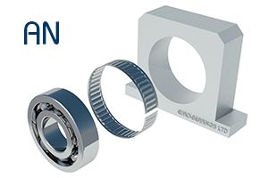

                    Have a look at tolerance rings, these are made to fit bearings in damaged housings after remachining.

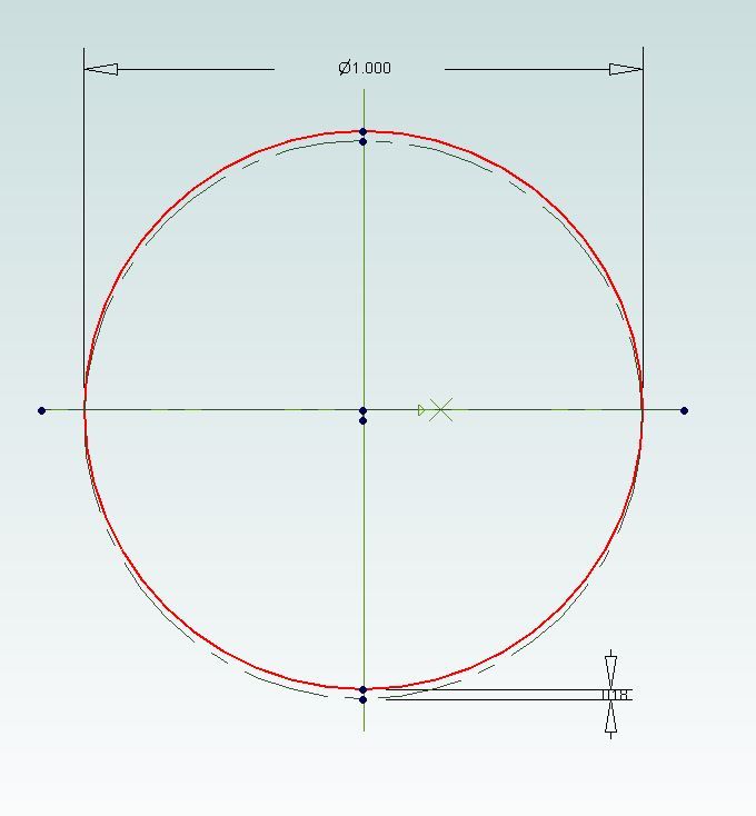

                                    You are right Michael I have not been clear enough.I was 18/1000" low on the correct position I milled the bearing housing to this amount leaving a gap of 18/1000" below thw fitted bearing.I hope this makes it clearer.
                                    Frank
                                    #330874
                                      So are you saying you have the original hole and a new one bored 0.018" higher in which case you will not need to fill the top but will have a max gap of 0.018" at the bottom.
                                      In which case I think your best option is to bore alarger hole in the correct position so that all trace of the old hole is removed and then sleeve it or find a bearing with larger OD
                                      Edited By JasonB on 07/12/2017 13:26:45

                                          Thanks to all for your suggestions I will have a ponder on what to do next.Jason has drawn exactly what I have ended up with.

                                                A tolerance ring is a thin piece of Spring steel with a pressed in design to grip the housing and the bearing. Concentricity should be good as long as the housing is true. They can be useful where there is not enough housing to bore and fit a sleeve and also it is not critical to bore the housing to the quite tight tolerance needed for a correct fit of a bearing.

                                                  Mike Poole- the op has stated that his hole is bored off centre as Jason drew up.
                                                  Tolerance rings WILL NOT fix off centre holes. They can take up undersize holes bored on correct centres.
                                                  #330935
                                                    Jeff, how do you get the bearing and a tolerance ring in an undersize holesmile p
                                                    #330936
                                                    Mike Poole
                                                      @mikepoole82104
                                                      I realised that Jeff, the point I was making is that a tolerance ring is useful when there is not much meat in the housing to fit a conventional type of sleeve. The housing would need another visit to the lathe to make a fully concentric housing. I personally would prefer to only use the adhesive solutions when the fit of the housing is insufficient to prevent rotation of the bearing. Despite impressive claims for gap filling I don't feel this is a job for adhesive. I did say the housing needed to be true in my post.
