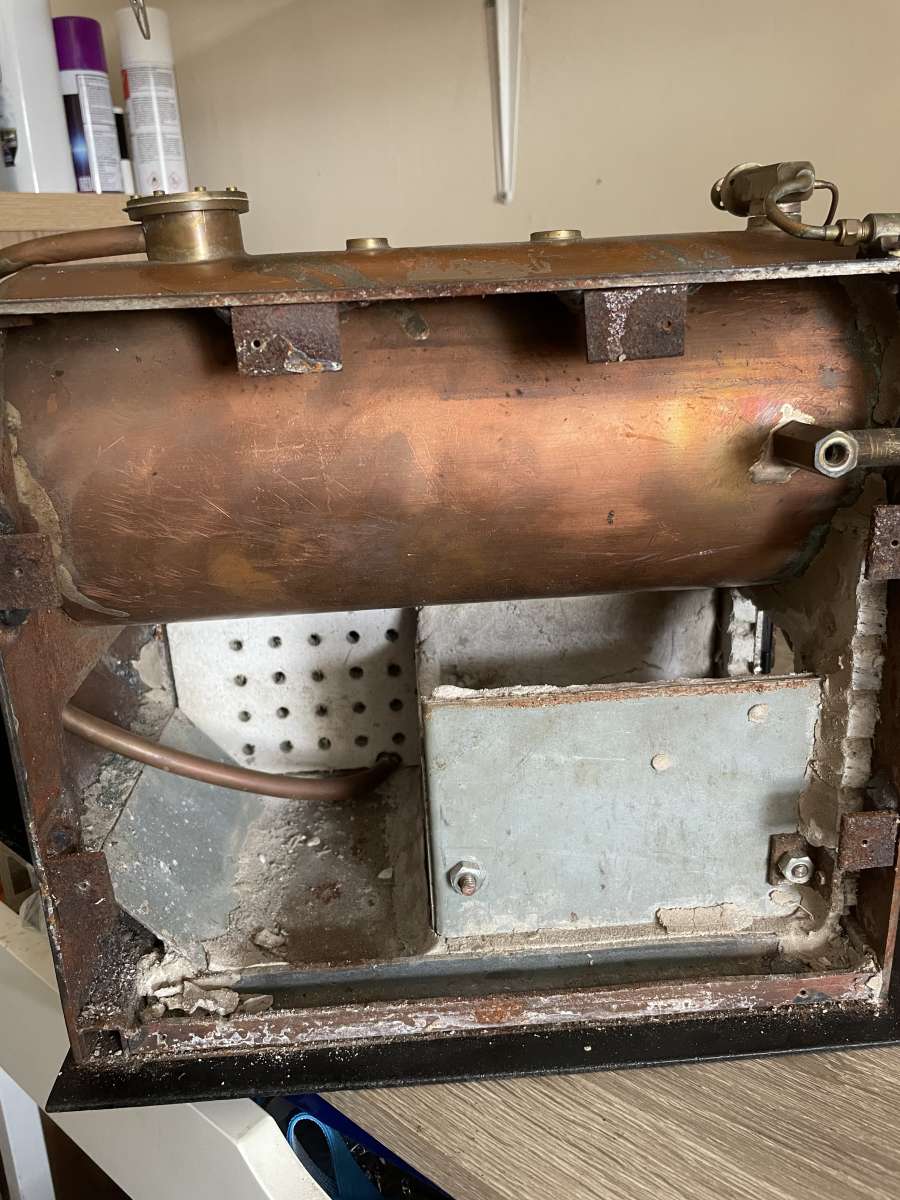

        Yes, it’s an interesting design, nice to know someone who actually worked on them! The more I uncover, the more questions I have! It will be nice to get it steaming one day, still a fair amount of work to do, new fittings ect, and still wondering about insulation and firebox lining material which extends to boiler sides, easier to see once covers removed

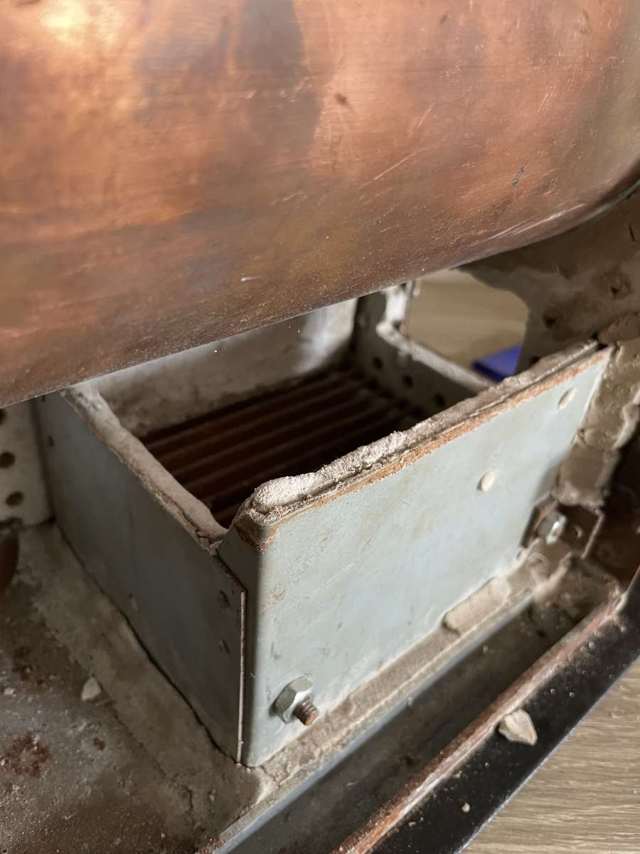

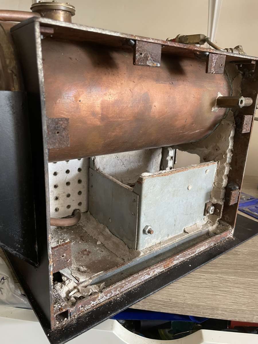

        #811329
        endckr111
          @endckr111
          One side removed revealing fireboxIMG_1783IMG_1784IMG_1785

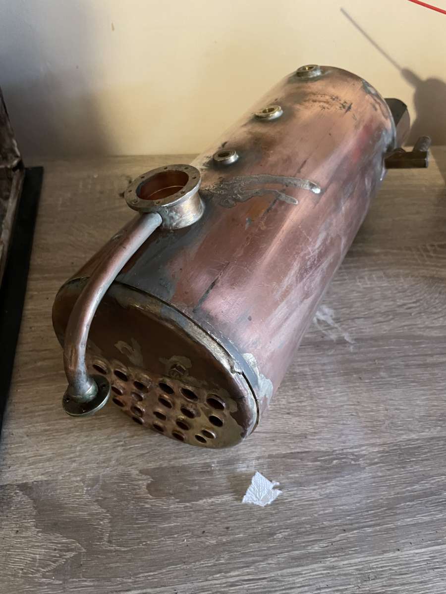

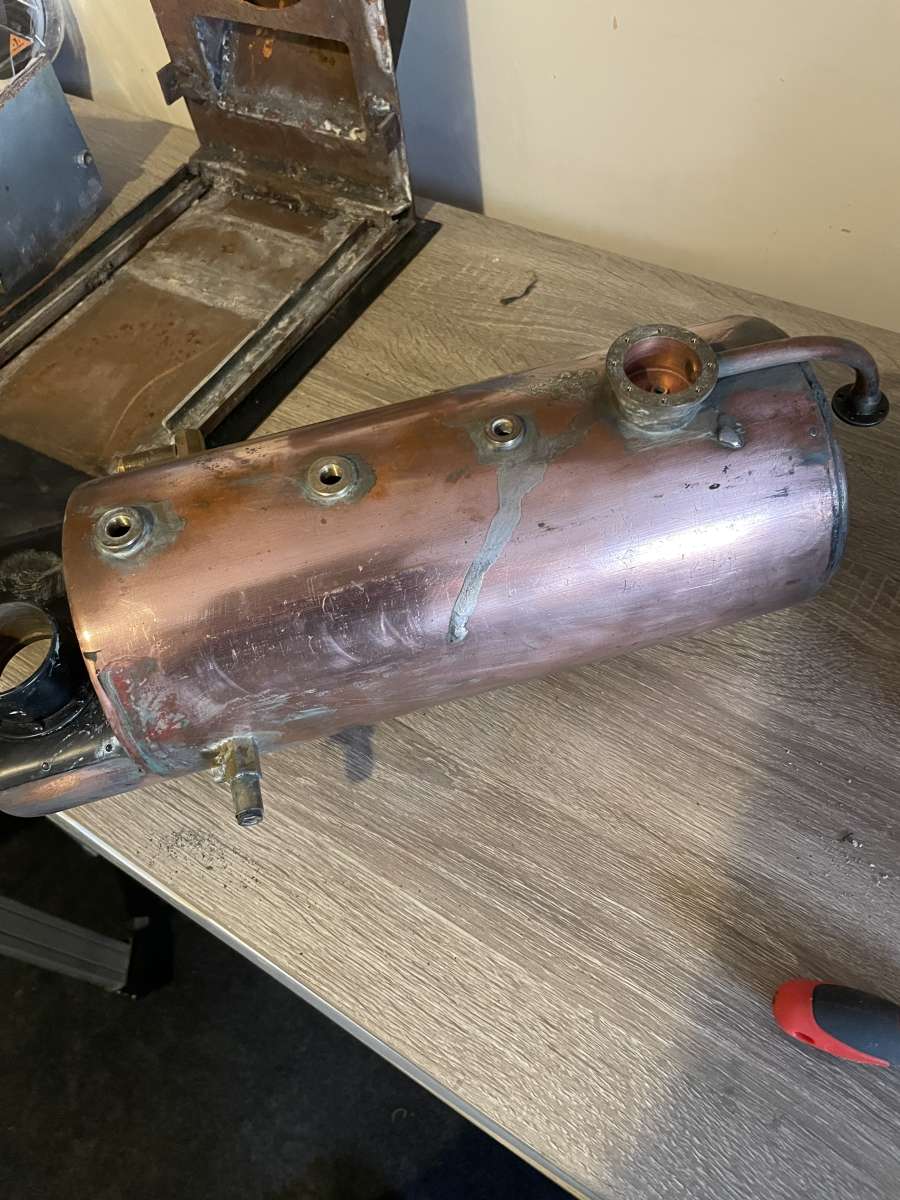

          #811335
          endckr111
            @endckr111

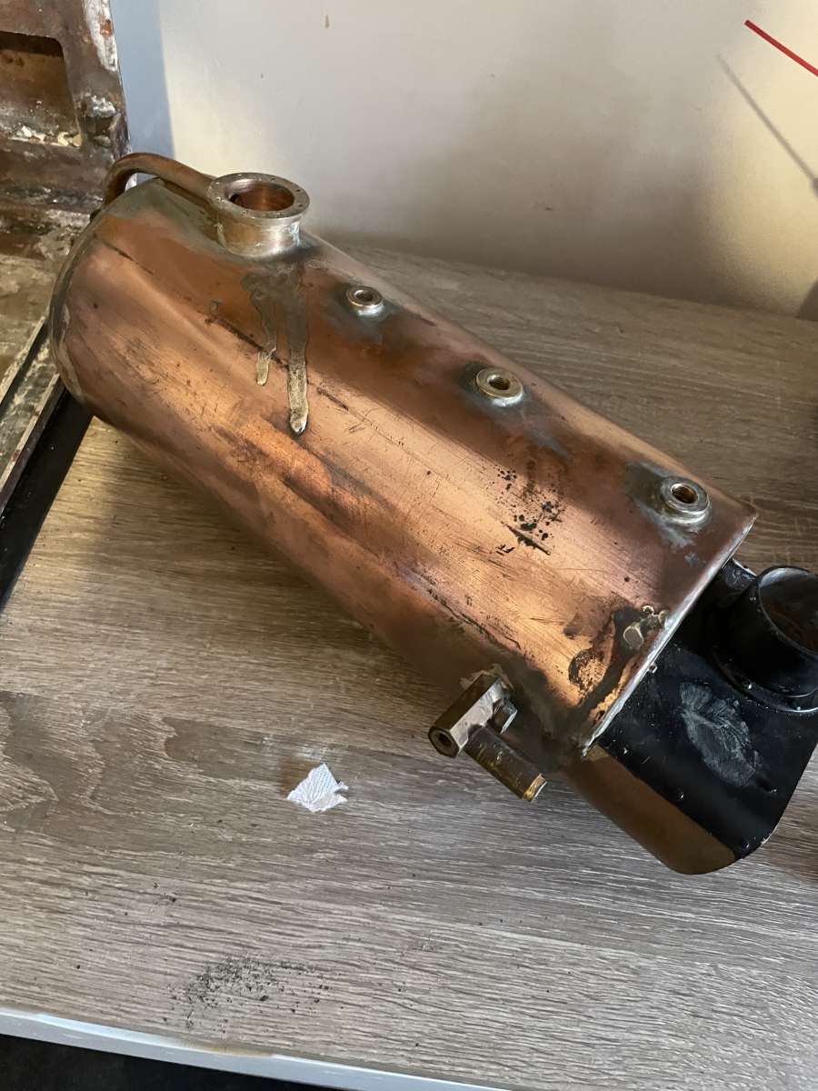

            <p style=”text-align: center;”>Just noticed the water level take off from boiler, that doesn’t looked-bushed but silver soldered directly, maybe it’s stepped down and soldered? Is it worth drilling out and bushing?</p>
            #811341
              Probably more trouble than it is worth. There is a risk of melting other joints as you try and solder in a new bush which may then be hard to rectify.
              #811350
              endckr111

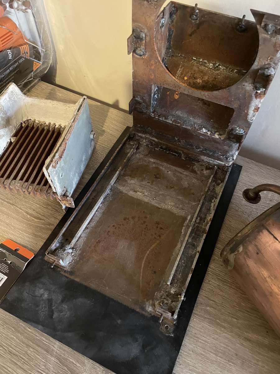

                @endckr111
                <p style=”text-align: left;”>Well, I’ve disassembled it, taking precautions! A lot of very small screws holding everything together, which I will replace. As you can from photos boiler looks ok, and there’s two silver soldered extension (not sure if it’s a brazed or silver soldered that goes for all the boiler)IMG_1792IMG_1789IMG_1791IMG_1788IMG_1790one each side, and as pointed out I think best to leave them in place, one I think will be for hand pump , the other possibly an injector. The main manifold which needs to support pressure gauge and blower, and water gauge top fitting,needs replacing, so I will look around for some suitable fitting, first job, blanking plugs ect!</p>

                  #811364
                  Nigel Graham 2
                    @nigelgraham2
                    The gauge-glass fitting in the side looks to me as if screwed, possibly soldered, into a bush that itself is silver-soldered into the shell.
                    I’d be inclined to leave that alone. It obviously withstood the hydraulic test, although it is not in the best position functionally.
                    The gauge-glass fitting itself though should have a simple blow-down valve below the lower glass elbow, to flush the glass through and ensure it is working.
                    #811366
                    endckr111
                      @endckr111
                      I agree with you Nigel, not worth the hassle re-bushing, and as you say, if it past hydraulic test, then leave be. Also agree with gauge glass blow down valve, that should be an easy fix!.
                      #811528
                      noel shelley
                        @noelshelley55608
                        While the pressure vessel may be professionally built, though I doubt it but the welding of the firebox and casing is definitely not. It’s inside so not important. An interesting boiler that will do credit to a working steam plant. Good Luck. Noel.
                        #811546
                        endckr111

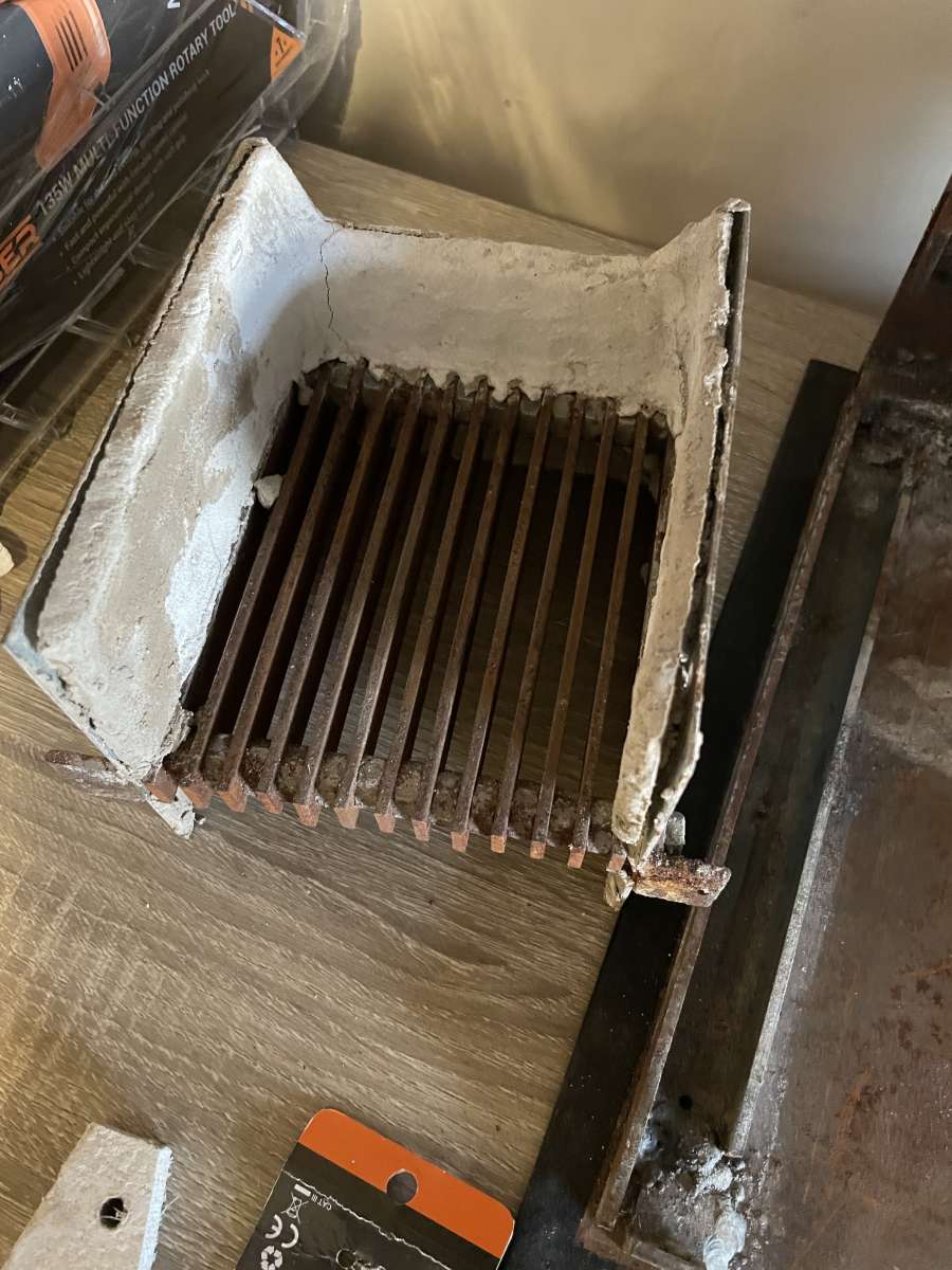

                          @endckr111
                          Thanks Noel, the firebox is alittle rudimentary which I will possibly upgrade, definitely re line with fire cement,and to be able to remove grate might be of benefit, it’s a work in progress as you say!
                          #811550
                          endckr111
                            @endckr111
                            Has anyone have any thoughts on improving the firebox, I did think of of extending sides, maybe at an angle to boiler centreline side, only a thought, or just re construct with a removable grate? Need some inspiration!
                            #811555
                            noel shelley
                              @noelshelley55608
                              2 long pins straight through the sides and fire box under the grate. Make the grate a loose fit in the fire box and widen the ashpit door so the grate can be slid out . This will give the facility to drop the fire if there is a problem as a bonus.
                              A simple tool made to hold the grate from below will make replacing the grate easy. Good luck. Noel.
