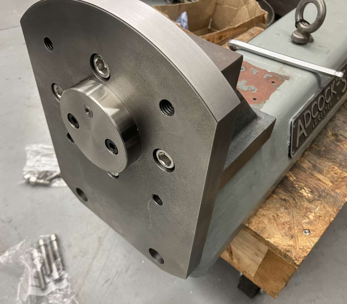

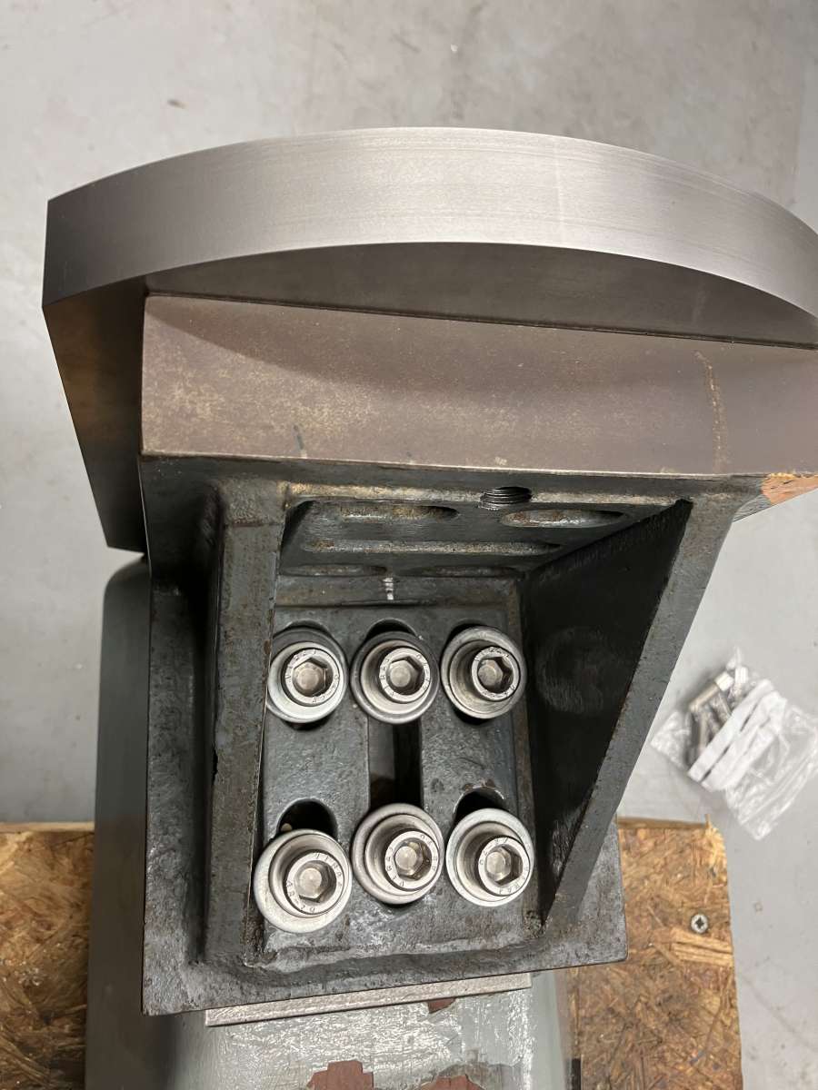

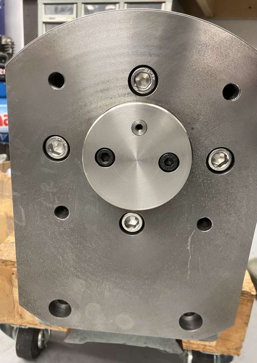

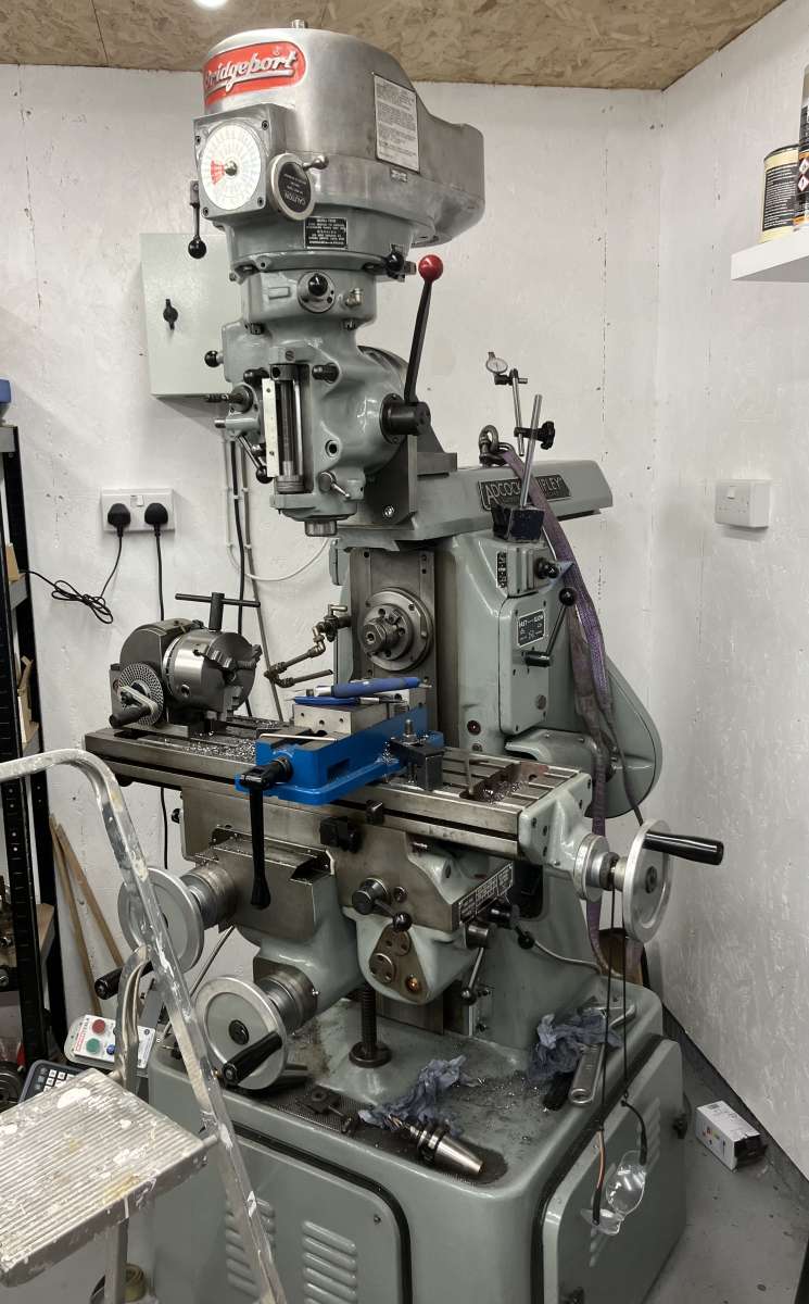

Finally got around to making a plate to mount the Bridgeport 2J head.
Just got to get motor on.
That looks very familiar………..Glad you got there in the end, you now have a very versatile machine.
Phil P
Thanks Phil for the inspiration.
yes so much more room in the z axis then the 1ES head. Got to adjust the z dro as out of travel now lol.
