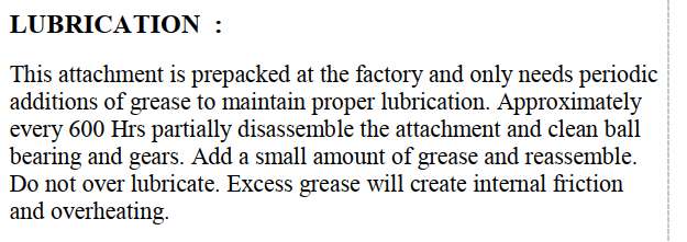

      Does anyone know the lubrication scheme for the Ackworthie Reversing Tapping Head#0 model?
      It has an oil port (oil daily), but only signs of dried grease inside around the gears. The clutch ring is good as in no scoring.
      Oiling the input plain bearing has dropped oil onto the clutch and causing it to slip with a spiral flute tap.

        I have a 6 page pdf of instructions for models HR 1 & 2, but not sure how to attach it here, or even whether they are applicable to your model.
        Feel free to PM me with a real email address and I’ll pass them on.

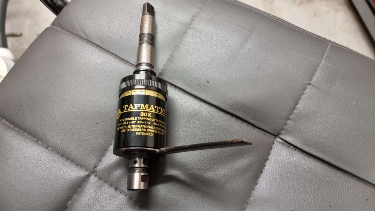

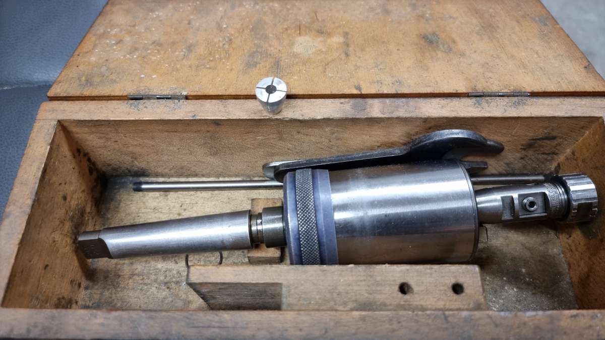

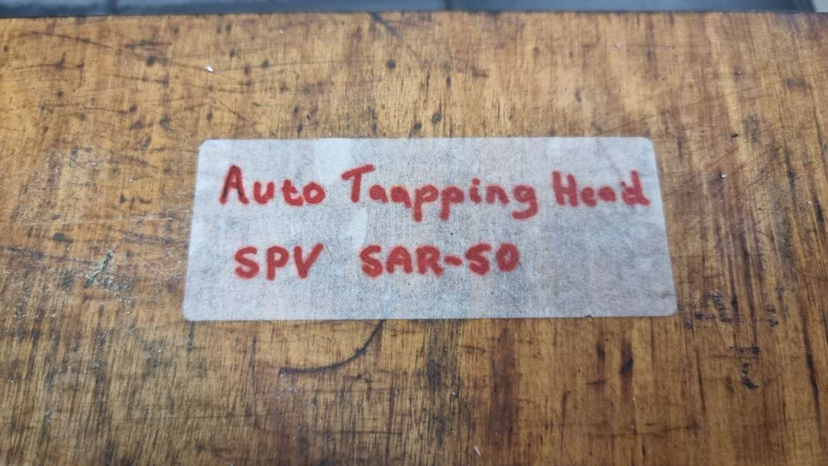

                I bought a SPV tapping head at an auction some years ago , it was not very good & slipped badly + no collets. I did a full youtube video on stripping & repairing it. I also 1st made some collets from delrin which were not very good. I then made some from alloy & split them for better grip. It works quite good now. Since then I was given a nearly new Tapmatic with all the rubber collets which is superb.
                Steve.
