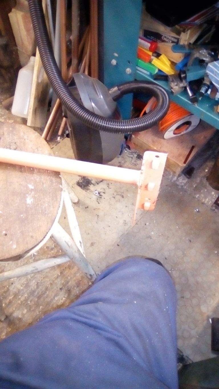

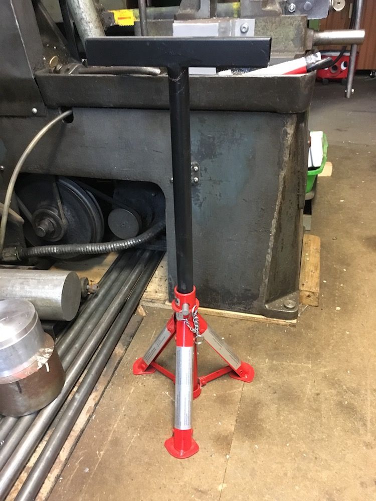

        Gentlemen,
        This maybe of no interest to anybody but I'm about to start cutting long lengths of 4" x 4" box section to make an engine trolley for my Lister M ready to show next season, I needed a stand to support the steel box whilst cutting to length and came up with the following.

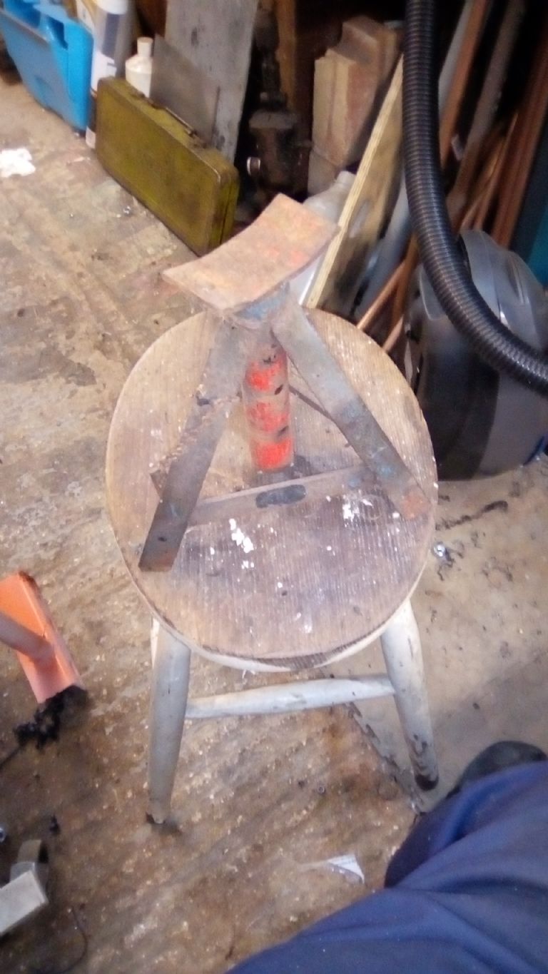

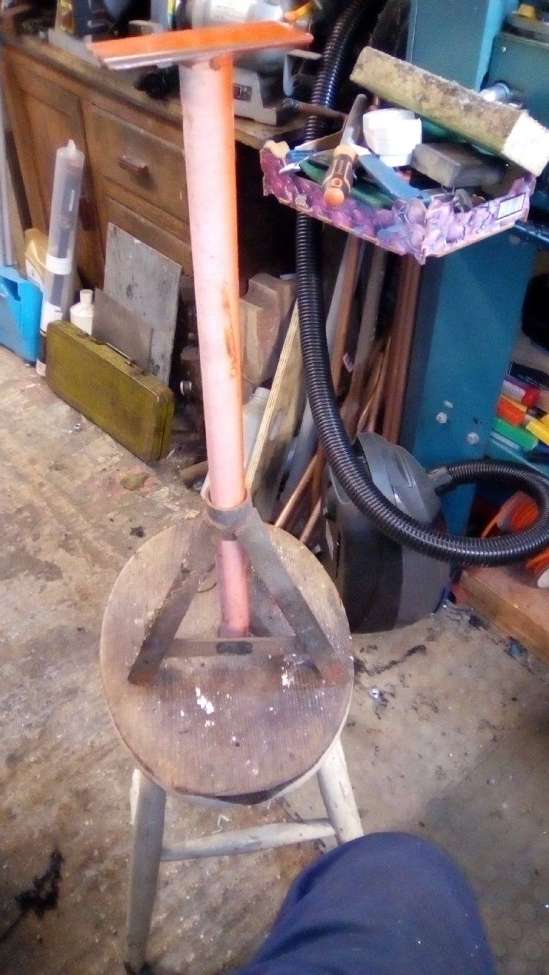

        I have a pair of axle stands, (1st picture) I took one as the base of the stand and removed the piece the car sits on, (2nd picture) I then took a Dexion tension piece that holds self assembly racking together and after measuring the height from the floor to the saw vice table cut the tension piece from the top of the flat face to the correct point along the tube, I then cut off the upright angled piece off and cleaned up the edges and (3rd picture) finally placed the the tube into the stand.
        One simple but useful support for my saw and its also still an axle stand.

          Hi Martin
          Good way to use axle stands for a base. A Three Legged Base is always better than a round base. If the load becomes unstable and is all on two legs they will not be on a single point as with a round base that becomes a wheel.
          Eric

            Those stands will come in handy for a lot of jobs, I would think. Nicely done.

              Good idea!
              I think I would not modify my axle-stands themselves but make longer-version columns that can be swapped with the originals as and when needed. (On mine, the columns can simply be lifted out.)
              I've often resorted to clamping battens across the workshop doorway at the right height, not just for the band-saw but also the bench-drill.

                I think that is exactly what Martin has done.

                    That is what I did do, I still use the axle stands so they are now duel purpose.

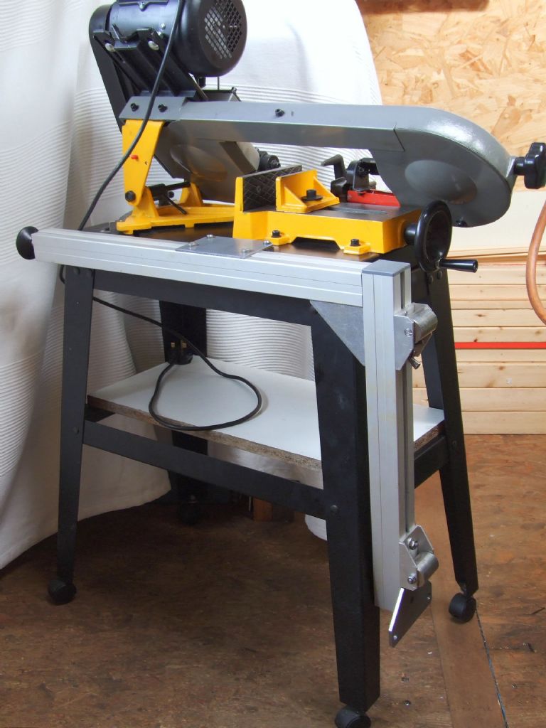

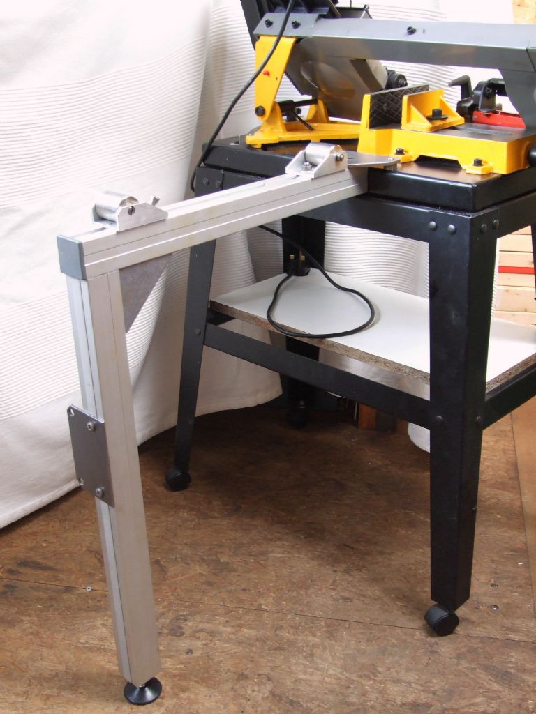

                      This may be of interest for those who have 4.5" Metal cutting saws.
                      It was made using structural aluminium picked up at a local scrap yard.
                      Regards

                        From old aluminium window frames might be an alternative? Perhaps joined back to back if not sufficiently rigid?
                        Neat storage.smiley
