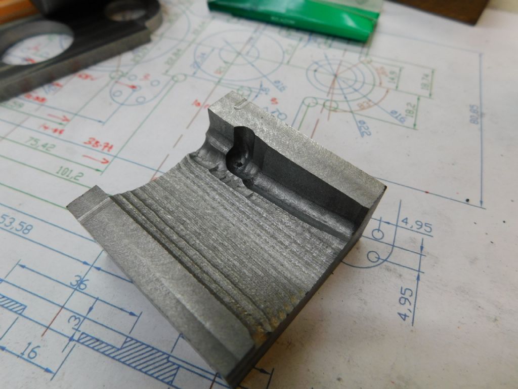

        Hi, I thought some might find this unusal situation of interest.
        When I began my machining career some forty odd years ago one of the very early things I was shown was the correct way in how to place a cutter in an autolock screw type milling chuck. I have contiued to do that since safe in the knowlege that any cutting forces that were trying to 'pull' the cutter out of the chuck due to the helix would infact screw the cutter tighter into it's thread and subsquently push the collet into the nose piece tightening itself in the process – a state of equilibrium if you like. In all that time I have never seen a cutter move outwards from such a chuck. In fact until yesterday I would have said it was impossible but yesterday I had it happen not once but twice!

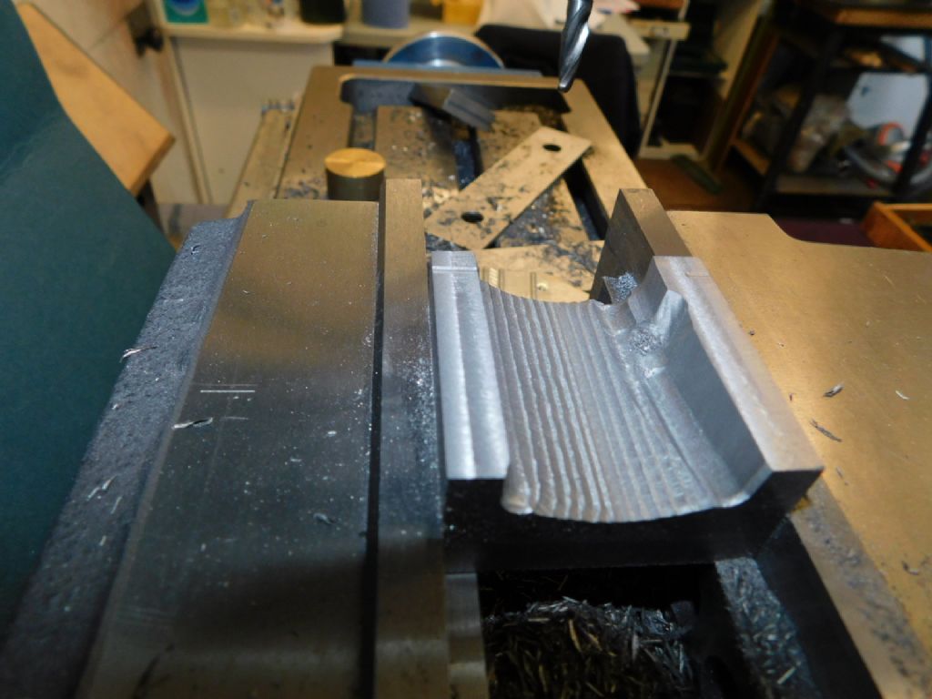

        I was step milling a concave radius in cast iron using a fresh long series Clarkson 1/4 dia ball nose slot drill. Step over was 2mm at the depth required from an initial 10.7 mm depth. At around 1000 rpm the cutter was chattering – it sounded as if it was almost plucking at the material but did not appear to being stressed. I was climb milling to ease the pressure on the cutter and the surface finish was not great but I put that down to the long series cutter and the longish side cut with that fair amount of overhang I had. Feed was by hand and steady for the situation – ie not being forced or rushed
        On a cut on the hidden side the noise slowly increased so stopped only to find the cutter had pulled into the work and was loose in the collet. The nose piece itself had tightened substantially on the chuck but the cutter was removed by hand. I put this down to possible carelessness on my part in putting the cutter in and not tightening sufficiently so reset every thing paying particular attention to that and continued in the hope that I would be able to use the part if the score was not too deep. Obviously approched this the second time with caution but within another cut on the other side and back again for the next on the hidden side the same thing occured again but with a vengeance. – this is the resultmarine compound (41).jpg
        It wasn't until I took it out of the vise to photograph that I noticed the run off (bottom corner) and began to think this was definitely due to cutter deflection and vibration but it didn't explain how a cutter can unscrew itself from an auto lock type chuck and penetrate the work – yes, the quill was very firmly clamped and no, the head did not move.

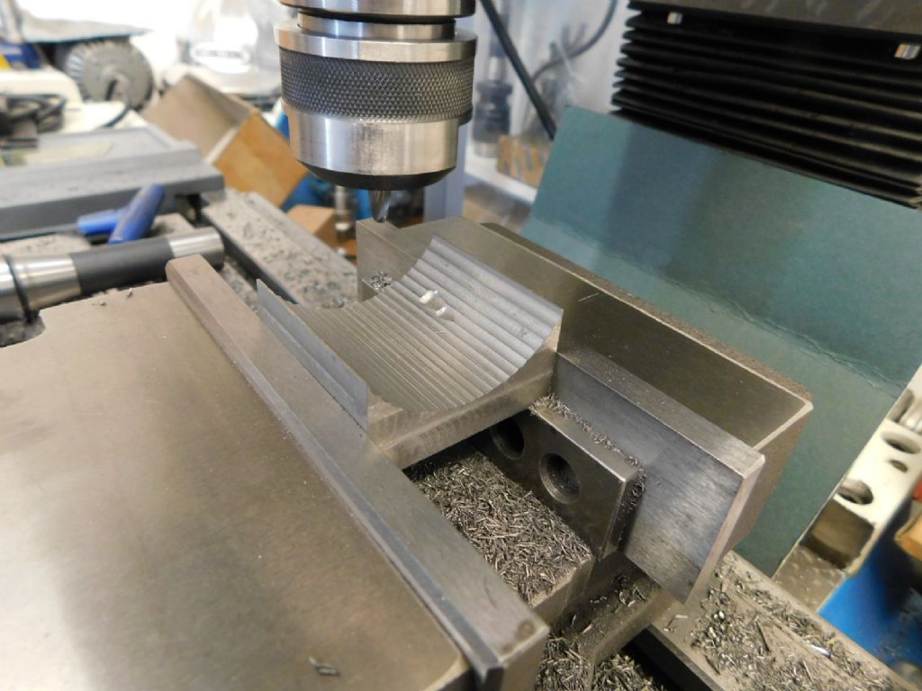

        I reset everything again and continued but this time milling conventionally – a slight improvement but no pull out – until that is the cutter snapped – this wasn't my bloody day. I found a standard cutter I didn't know I had which performed much better and managed to clean it up considerably so part saved.
        But the mystery remains – how does a threaded cutter pull itself into the work from a screw in collet chuck.
        If I had't witnessed this nyself I would have said it was not possible but the proof was right there.
        Any thoughts?
        Hope that's of interest – Tug.
