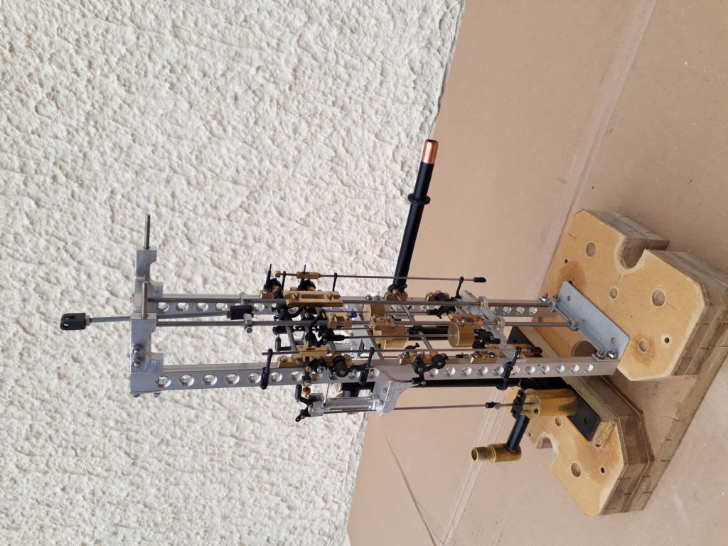

                              Thanks to all who tried to help in spite of my rather vague question. Maybe a bit more background would have been a good idea to start with. I intended to post this last night but tried to show off by spending hours making a fancy meal and then fell fast asleep. Maybe some things should be left to the experts.
                              I'm trying to build a small scale (1/30) model of the biggest steam engine there is and using compressed air rather than steam. I went for the Cruquius engine because of the fascinating control gear and the excellent web site (**LINK**). I chose a small scale because I didn't think I'd get it through the door otherwise. I haven't built the cataracts or the hydraulic stays yet and, as someone said, miniaturising the cataracts will be interesting. The rest of it is working apart from the problem with the inlet and equilibrium valves.
                              With air, I don't need the condenser or the exhaust valve and I consolidated the annular piston and the main piston. The original was 12 feet across.
                              This is the cylinder before I put it in the engine:
                              And one of the control gear (sorry its on its side):
                              And the model so far with the cut-away building – an attempt to show off the 7-foot thick walls:
                              In this engine, the piston moves the valve control beam, which moves the plug frame. The plugs move the horns, which move the angular transformers and close the valves. The cataracts release the scoggans and that lets the counterweights open the valves. So my problem is to persuade the engine to keep moving enough to close the valve while it needs air to keep it moving.
                              Incidentally, the last sub-page on the Cruquius site is the detailed restoration report and is a really interesting read. I've learnt a lot from project already – I even discovered that "junk" is a perfectly good engineering term.
