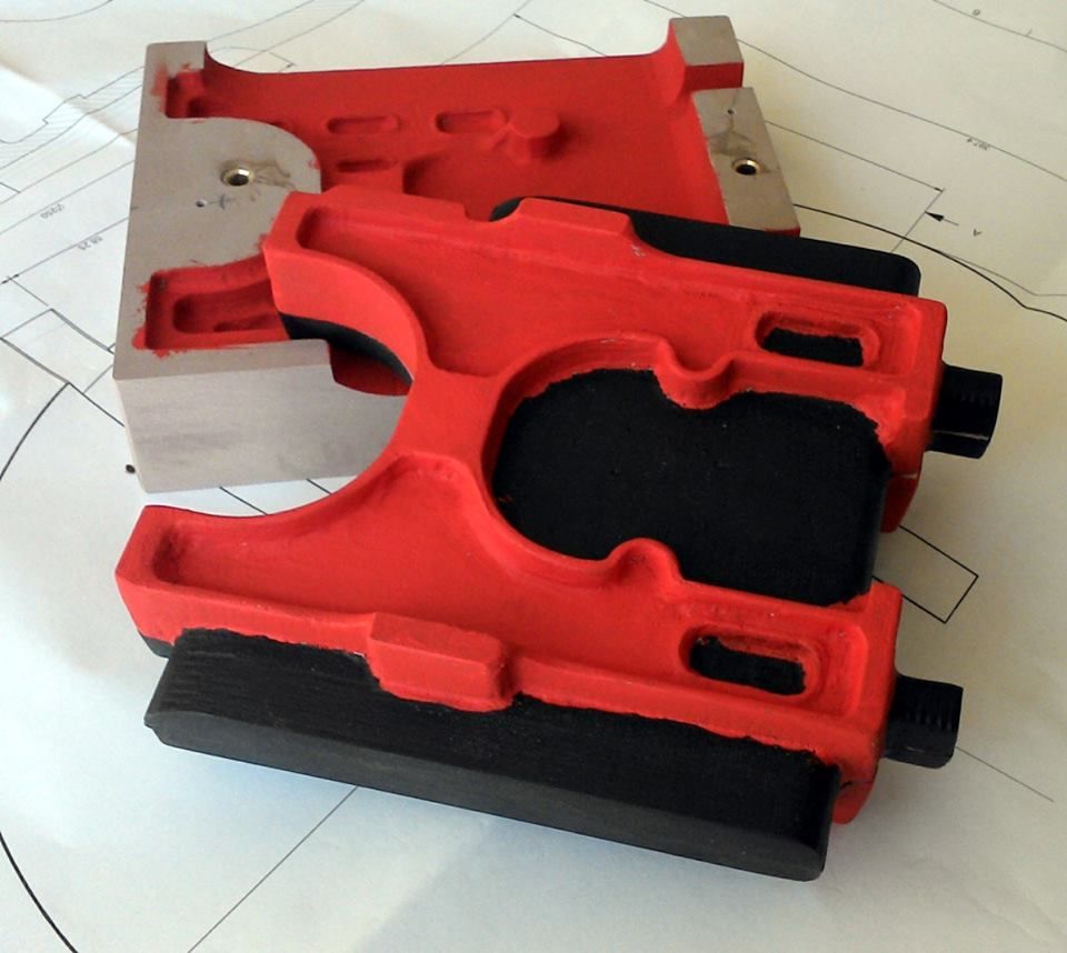

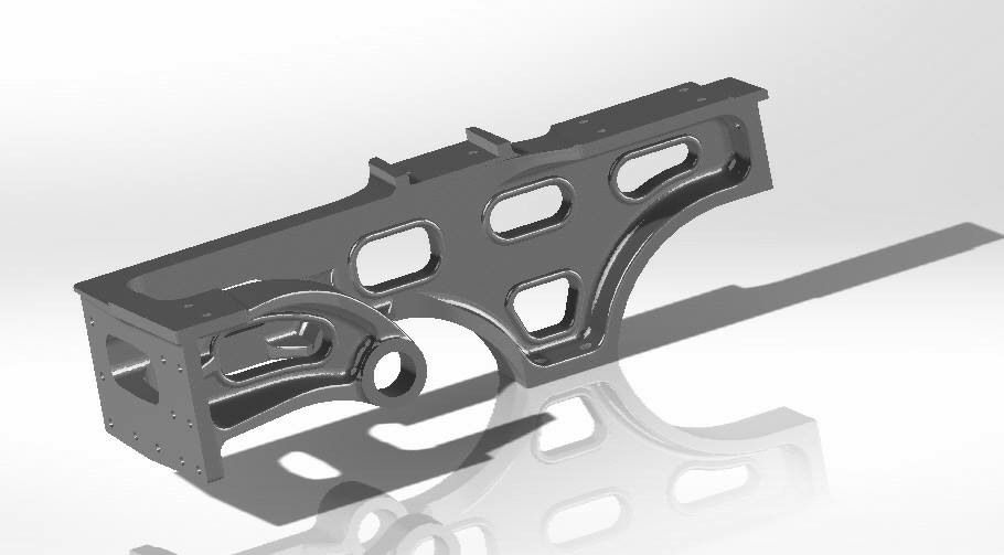

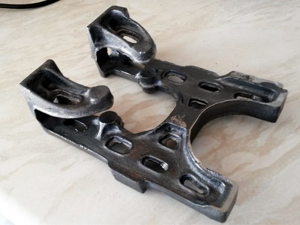

              Whilst waiting for the storm to abate (referring to the weather) I was musing about a discussion which took place elsewhere regarding model loco building. A man was asking what is took to construct a model loco. Another contributor answered that all he had to do was to get hold of the works drawings, find a CAD technician and a 3D printer and hey presto he could then trot off to the foundry and get castings made! If only life was that simple. It helps if a knowledge of how foundries operate. A case to illustrate this if this motion bracket casting:
              The CAD model took quite a bit of figuring out.
              The pattern and core box for a combined left and right hand casting
              The casting straight from the foundry.

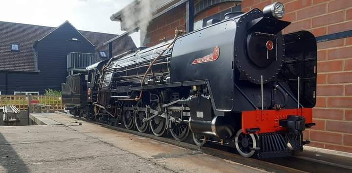

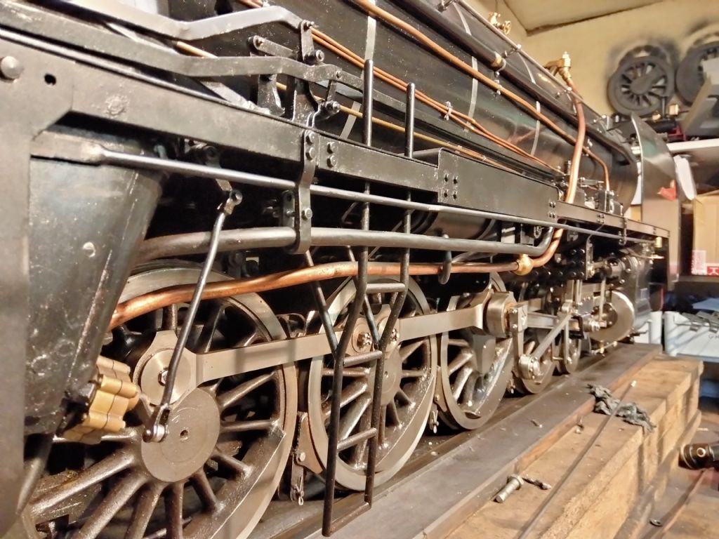

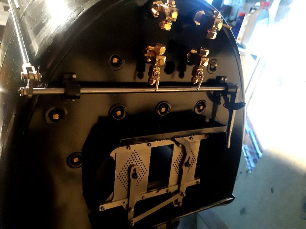

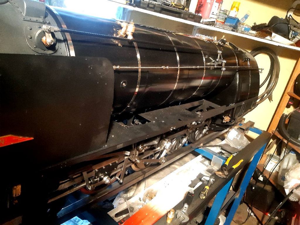

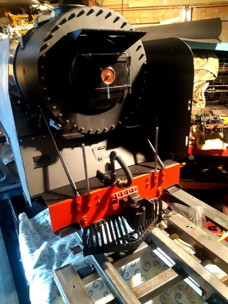

                  It's been quite some time since Eric's original development of these castings. I am, as far as I know, the only person so far to have built a model using some of these castings, so out of interest I thought I'd post an update.
                  I can't remember exactly when I took delivery of the castings but I think it was around 2016, but in fact it's been about 3 years building as it was shelved for various reasons for about a year.
                  Around the same time as I restarted the project, I learned CAD design and so for the remainder of the build I often didn't use the castings as it was easier to fabricate to ensure good fits and more detail. The wheel castings and cylinders were in the end the only ones to be used, with some modifications made to the cylinders to improve faithfulness to the prototype.
                  Only the pipework remains to allow it to steam. It runs smoothly on compressed air. Some photos attached and hopefully the short video uploads, let's see.

                    I would use the word impressive but that's not a a big enough word
                    holy smoke
                    Are you going to run this thing too?? edit yes he is
                    edit: I got the full set from the original website when it was shutting down because I thought the resource might disappear into a private hands black hole. It's all high end originals in dire need of updating into cad apart from a couple that were already done at the time
                    Great to see that this very advanced part of the ME community is still being continued
                    Edited By Ady1 on 10/09/2020 10:16:34

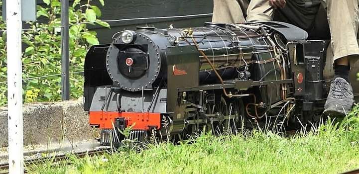

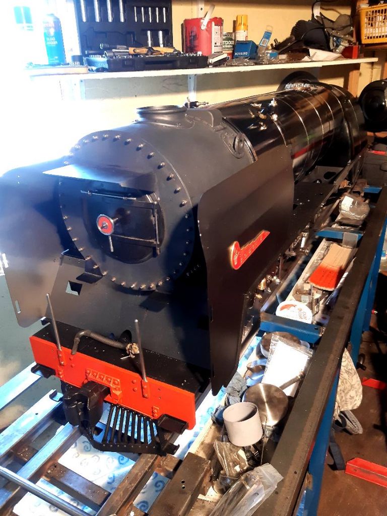

                          As a final update, she's in steam and running nicely, looking forward to some public running in the summer.

                                  The completed locomotive, although if you like detail, there is almost no end to the project. There is a lost wax casting in bronze of the vacuum ejector so if that can be made to work, all the linkages are there to the vacuum cylinders, which are also now fitted.
