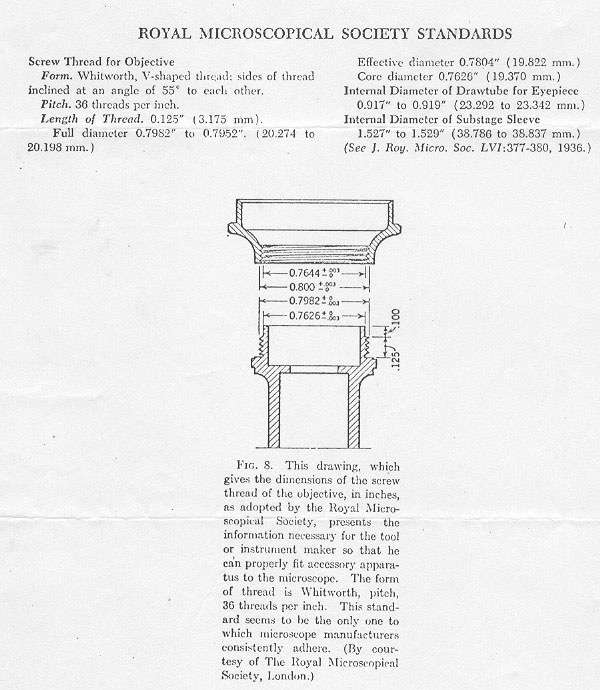

                              If it is a 1940s to 70s BSA motorcycle it could be anything. I remember the bolts holding the chain wheel onto the rear hub on my Bantam were …… (not in any book). Just a comment, there is a standard 36 tpi Whitworth thread – microscope thread (51/64″ x 36tpi). I cut one a couple of weeks ago. It was also common practice for threads to be cut on larger bolts by opening up the die box (1920s AJSs and Bristol piston aeroengines at least).

                              #725793
                                Just to support JA’s microscope comment:
                                .IMG_5941
                                … and the reference gauges that were supplied to the major British manufacturers were produced by the Whitworth company.

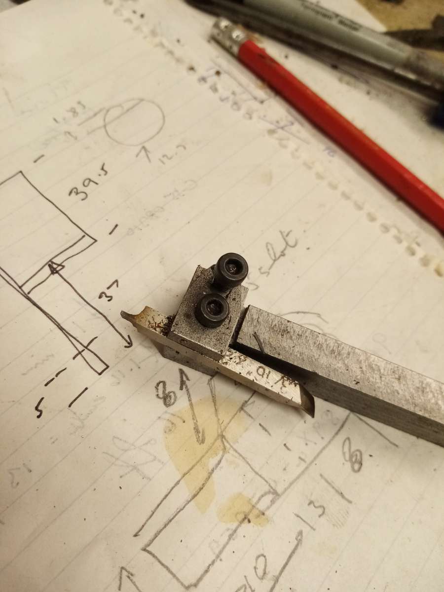

                                duncan webster 1
                                  @duncanwebster1
                                  As it’s a left hand thread you will be cutting away from the shoulder, so no need for crank handles. Here’s a photo of my holder for 3/16 bits, as someone else said, grind the point off to the left hand side and you don’t need to go down to really small bit. IMG_20240414_132818

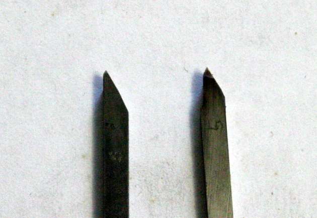

                                    John Purdy
                                      @johnpurdy78347
                                      Here are the tool bits I use to cut fine threads up to a shoulder ( 40 ME and fine metric), 60 deg. on the left, 55 deg. on the right. Notice the 6 and 5 etched into the top so I can tell them apart! They are ground on 3/16 sq. HSS blanks. Initially I ground them free  hand (with the assistance of a loupe ! ), but I now do it on the Quorn. I hold them in the Dickson QC tool holder shimmed up to centre height.
                                      tool
