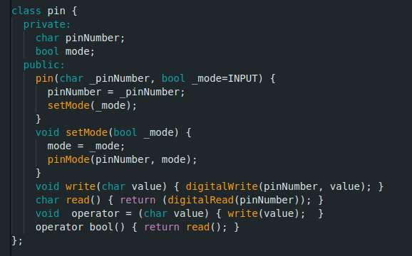

                                Just for fun, it’s not difficult to extend C++ so Arduino supports similar syntax.
                                After declarations like LED = pin(13, OUTPUT)  P12 = pin(12, INPUT);
                                then
                                LED = HIGH;  // set the LED pin HIGH
                                int i = P12;      // read pin12 and copy the result to i.
                                My implementation below is only syntactic sugar in that it simply wraps digitalWrite() and digitalRead().  But I could do the reads and writes  with Duncan’s much faster register bit twiddling.
                                pinobj
                                The last two lines overload the = operator, changing it’s built-in copy behaviour to either read from or write to a pin. Unlikely that a BASIC compiler supports operator overloading.
                                Whilst there’s little point in operator overloading in an NE555 replacement project, the capability (and other advanced compiler features) become extremely helpful in larger projects.  Like writing a BASIC compiler so busy people can program a PIC to do PWM without needing a degree in Computer Science…

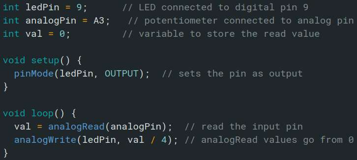

                                      John Haine
                                        @johnhaine32865
                                        potpwm
                                        Or even…
                                        analogWrite(ledPin, 0.25*analogRead(analogPin);
                                        I’ve got a job coming up where in response to a pulse every second I have to output 13, 13, 14, 13, 13, 14…. pulses.  Easy (probably) on a PIC and it only needs one input and one output pin so an 8DIP package would do fine.  But I’ll actually use a Pico or (maybe) a Nano, because I have spares, I know how to program them (actually I have code which does it), I’ve got the tools, and they can do other functions.
                                        No prizes for guessing what it’s for.
                                        But this has been a very useful thread and now I know how to turn PIC 12f675s into precision timers!

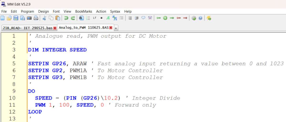

                                        #802467
                                        IanT
                                          @iant
                                          Not ‘C’ I’m afraid but on a Picomite (in very simple terms) it could look something like this.
                                          I’m sure there are other/better language solutions – but this is the one that works best for me.
                                          Analogue2PWM
                                          Regards,
                                          IanT
