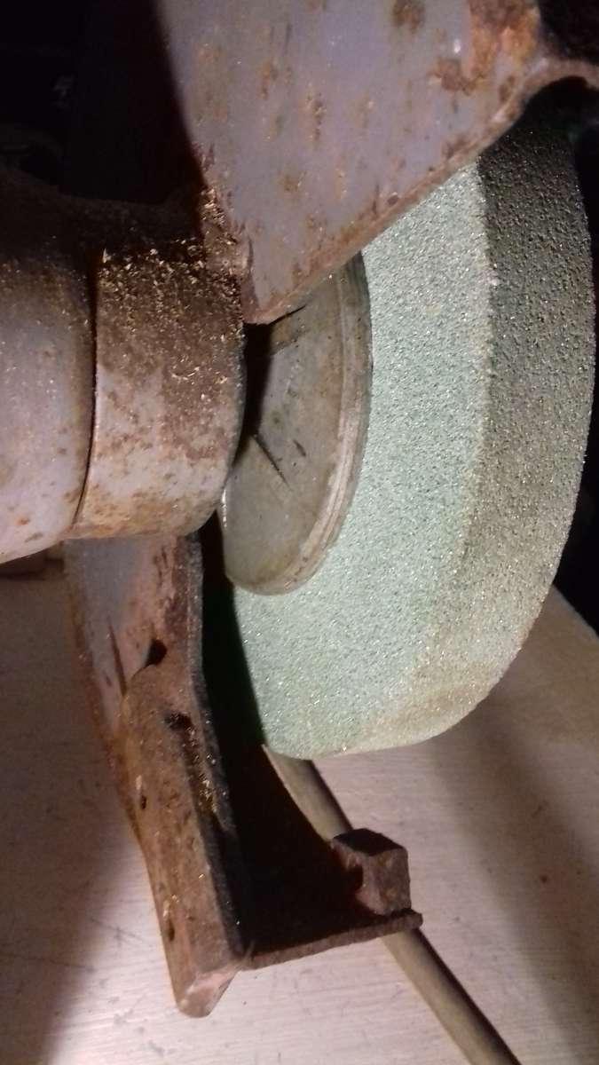

      Thank you, You were both correct, I had made a serious error wiring it up and I am an idiot for not doing a thorough check. good lesson for you Noel, when you get to the testing stage.I knew something was wrong but missing a wire was a dreadful error. My Bench grinder seems ok. I ran it four times on the Start Capacitor for no more than 5 or 6 Seconds on each occasion. perhaps I got away with it, I have read somewhere but can’t remember where, that more than a couple of Seconds running on a Start Capacitor can destroy a motors windings. I rescued that B&D 7″ 3 phase Bench Grinder a couple of years ago from a skip  the stones thrown in seperately and luckily they had put the nuts and washers back on the spindle. no idea why they threw it away, Although the tool Rests are missing, AS ARE THE END COVERS  does anyone have a grinder like this that they could take a picture of the tool rests for me, to give me a rough idea what to make

            Trevor, I’m glad all is well and it now works. Running it for a few seconds should do no harm so long as the insulation could stand it. Good Luck Noel.

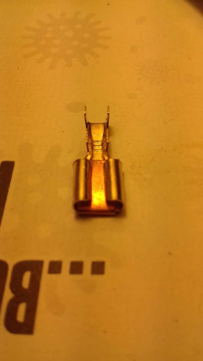

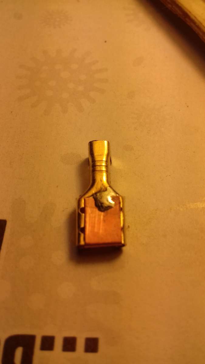

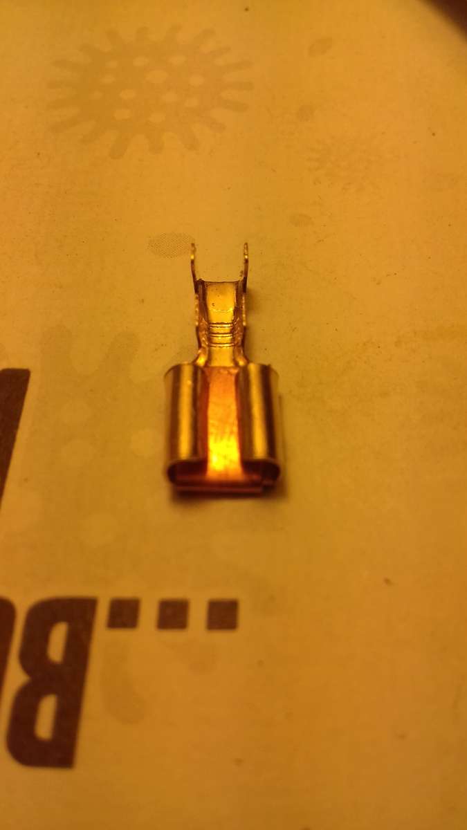

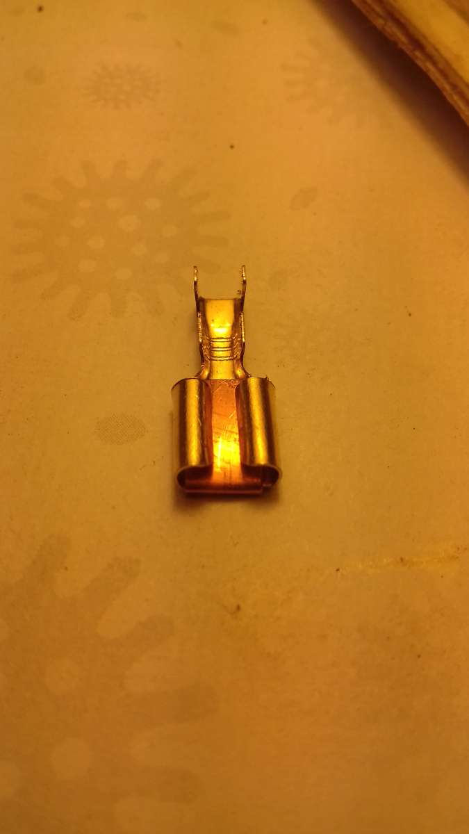

              Thanks everybody, I am relieved that I have got it working. Here is a good Tip, I used Crimp On connectors for the Capacitors. I think this is safer than getting the terminals very hot. but what I did was to solder a small piece of Sheet Copper folded over the edge of the female spade, This has two advantages. First it increases the gripping pressure and second it disables the locking tab so the spade can be more easily removed without ripping the terminal from the Capacitor.

              The wires going into the motor have really old brown rubber insulation with a cloth outer which is all falling off,  but I don’t know if I have caused any damage inside , I did stick my nose in but could not smell anything untoward, If I had a Mega Tester I could do some insulation readings. It never occured to me that the 3000RPM was uinusual, I have tried to find out about ithe grinder on line, but can’t find any information

                    Adding strips of copper to female spade connectors is unlikely to help as the two rolled over edges that hold it all together will be strained beyond their elastic limit and with the lock disabled are more likely to come off. Soldering was considered good enough for the 40 year old unit I have and only by very poor practice will the terminals be over heated. If I have to replace any capacitors they will be soldered in. Noel.
