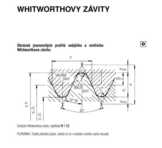

      Perhaps Parker Hale chose to use [almost] the full 'fundamental triangle' of a Whitworth thread-form; so as to give longer flanks to a thread which needs a precision fit.
      As illustrated here [borrowed from Wikipedia];
      the Whitworth truncation of the fundamental triangle is H/6 which, for 40tpi I calculate to be roughly 4 thou.
      [someone please check this figure]
      That would make a 'fully extended' version of the 7/32 40tpi thread
      0.21875 + 0.008 = 0.22675 inches, outside diameter.
      … a tiny rounding of the crest then takes us down to 0.225"
