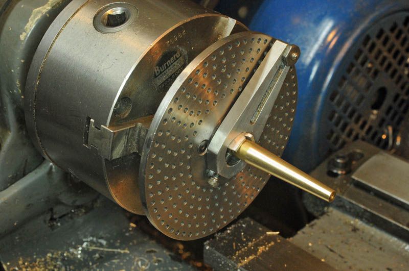

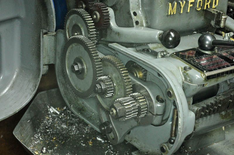

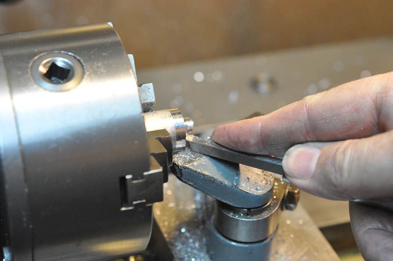

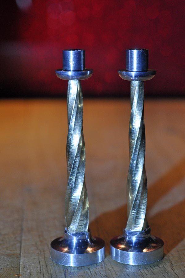

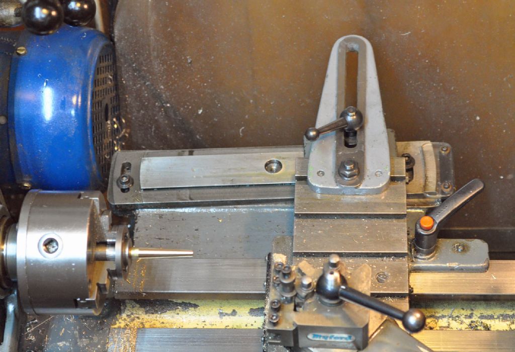

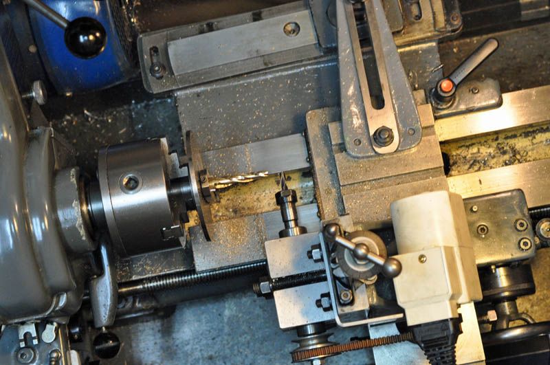

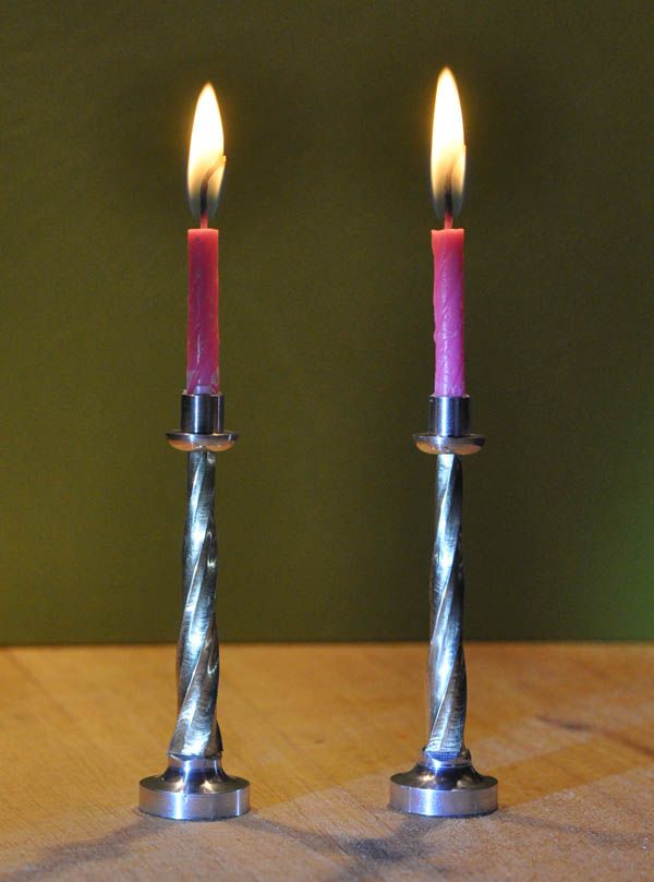

      Stems are brass, tops and bottoms ally. I used the gear I put together to mill helical gears for the stems. First I turned a 2.5 degree (5 inclusive) taper using the taper turning attachment.
      Then set up a gear train with a lead of about 3 inches.
      I reduced the taper to 1.5 degrees and set up the milling spindle to follow the taper and used direct indexing to mill 4 helical facets.
      The curves on the ally top and bottom were done with a hand graver.
      The top is held on with a screw and the bottom with Araldite.
      Of course, I could have made the pair with opposite helices, but that wouldn't fulfill the briefwink
      That was fun smiley
      Rod

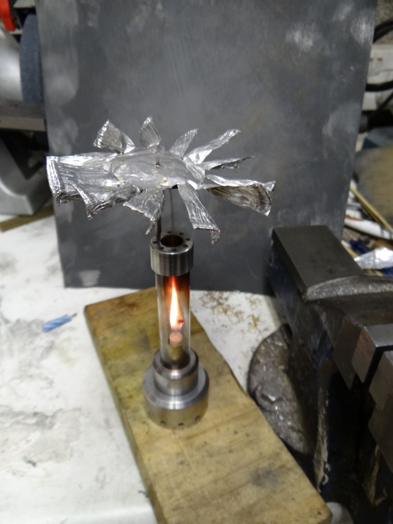

        Hi Dave, I agree with David Standing 1, your pivot point must be above the fan, otherwise unless it is already spinning it will topple.
        Regards Nick.

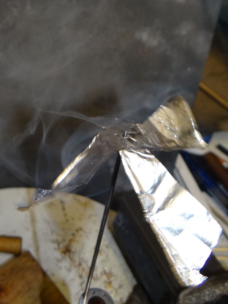

          Wasted a couple of hours experimenting with fans taking into account David's advice. The original design in 0.6mm thick Aluminium sheet is too heavy at nearly 3g. Kitchen foil is too floppy. A very thin foil fan spins well but it wins no prizes for appearance and suffers from severe over-heating!
          Most annoying I don't I have any thicker Aluminium Foil. A bit of old pie dish would do the job, but there's none in my recycling bin. It seems I have crashed in flames!
          laugh
          I like Rod's elegant solution and the way he made it.
          PS post crossed with Nick.  Agreed.

            Oh dear, I'm struggling to find something positive to say about the SOD Mk II fan, crap would be accurate, 'foiled again' would be the humorous reply!
            A 3 gm fan is fine, you just need a candle ten times the size of your existing one to propel it devil.
            Back to the (virtual) drawing board wink 2

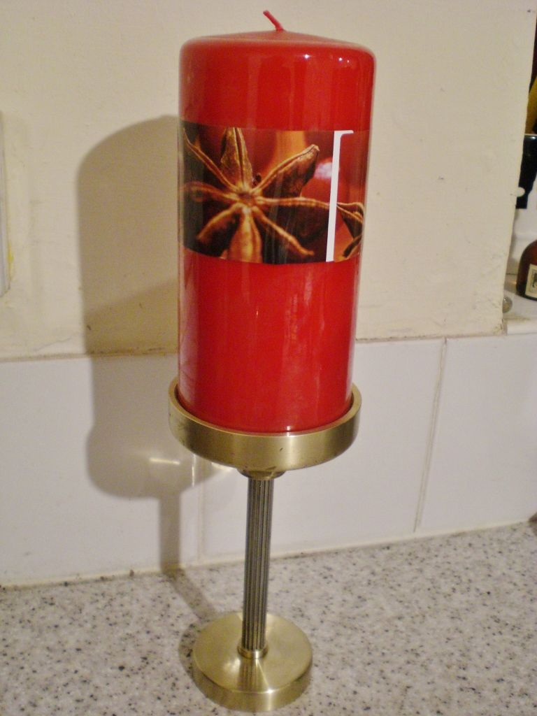

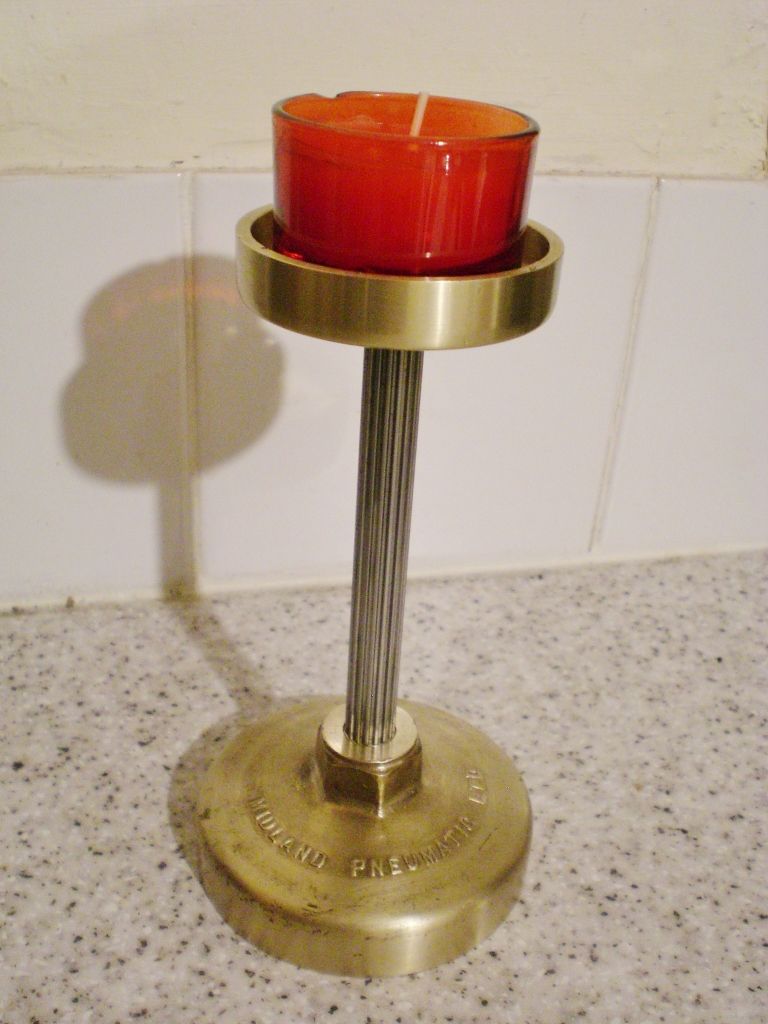

              Hi, yes, Rod's look good. Well! I have finished one of mine, although it needs a bit of polishing around the edges and I still don't know if I'll get them both done in time. However here's a cold run of my first one, first photo is with a small pillar candle.
              Next photo is with a Tealight type.
              The last one is of a large pillar candle, which by a shear fluke in design, can be held by inverting the candlestick and using what was originally designed to be the base, the candlestick can be tilted over nearly as much as a double-decker bus, before it starts to topple, with this big candle in it.
              Regards Nick.

                                    I hate mince pies. And Christmas. Cruel, cruel world – I ate my first mince pie of the season just to get its aluminium cup for this project and the sacrifice was wasted. Another crumby fan design that won't spin properly despite attempts to Whittle it.
                                    The disaster is getting on my wick so I'm going to taper off.
                                    The only good news is Neil opening the door to virtual entries again. I reckon I can rush a couple of hundred out by midnight. That'll lighten his darkness.

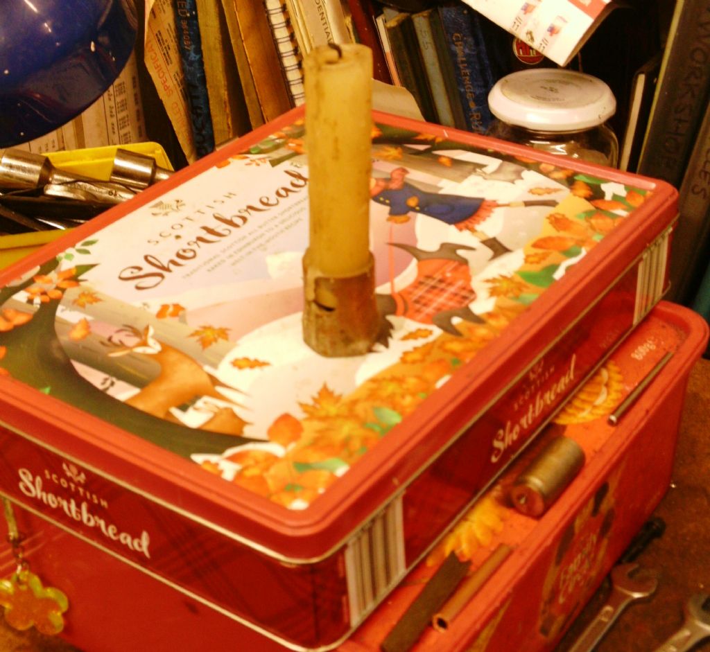

                                      pict1288.jpgThis is my candlestick. Couldn't be bothered to make one so I stuck a candle in a short tube spanner. Its been like that for years, occasionally useful in the workshop when a gentle heat is needed. Please note the christmassy background!

                                        Is the candle under the tip of the blades? It looks like it is near the centre of the tinfoil abortion fan blades, and it won't work if it is – it needs to be near the tips.
                                        Oh, and didn't Neil say that any more virtual entries will result in a life forum ban?! wink 2

                                            Is the candle under the tip of the blades? Not in that particular photo, but I've tried it all ways, with different heights and offsets from the chimney. Thin foil fans work OK if I quadruple the height of the lightning conductor but they look horrible. I'm pretty sure I could make a good looking working fan from a thick foil dish used to roast a turkey but I won't get to the shops until late tomorrow. That's my excuse anyway!
                                            What's typical of this latest Flambeaulox is me assuming that the fan was the easy bit; actually they're harder to make than they look, specially if you haven't quite got the right material.
                                            As to the possibility of a life forum ban, perhaps some good will come of this after all!

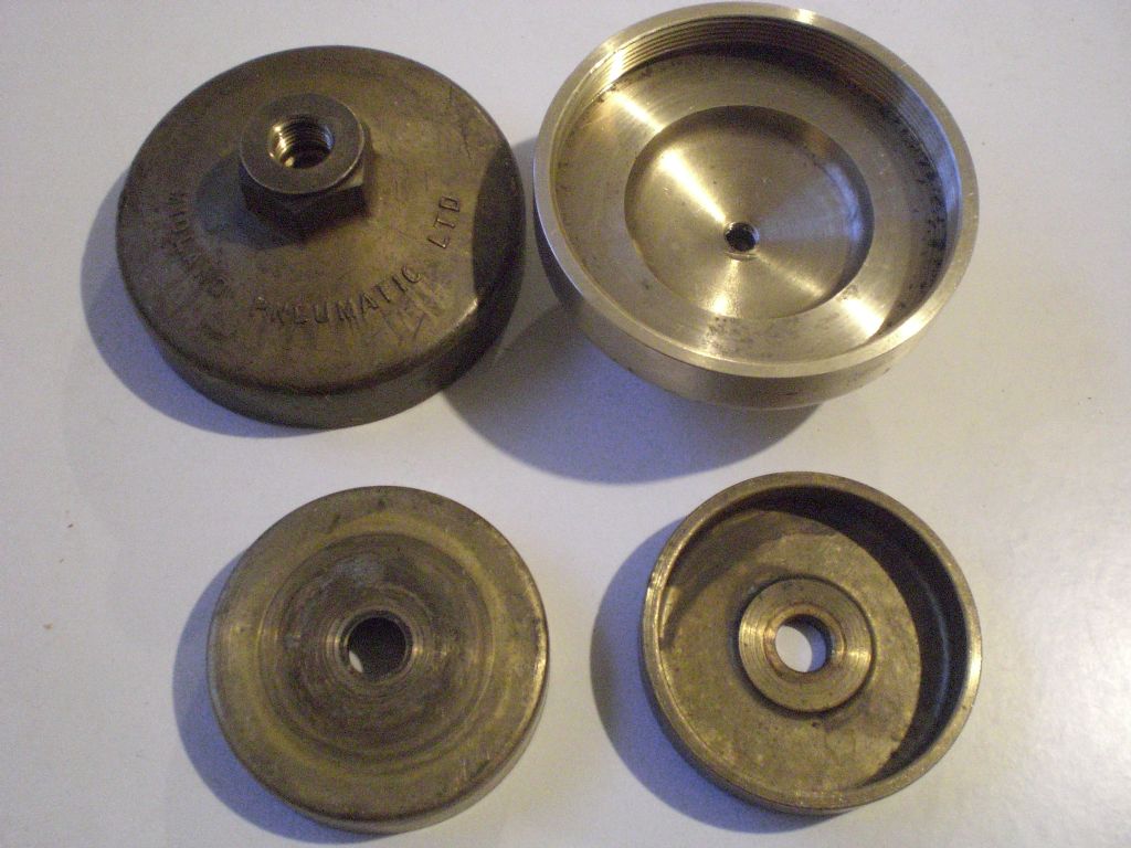

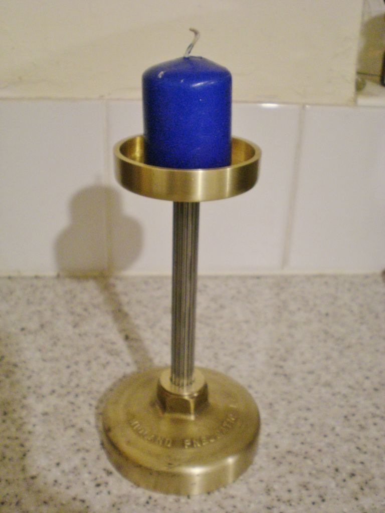

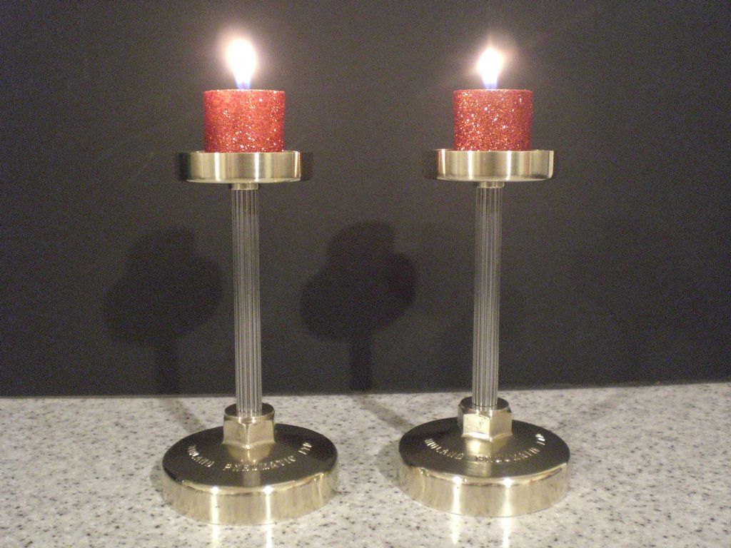

                                                      Hi, well hears my effort in all there blazing glory.
                                                      Probably not as good as Rod's, but I like them and I've finally found a use for this industrial scrap that I've had for the last 15 t0 20 years, I knew they would come in handy one day. Might even make a couple more one day, but they would have to be shorter as I haven't got enough of the stainless steel splined rod left to make them the same height.

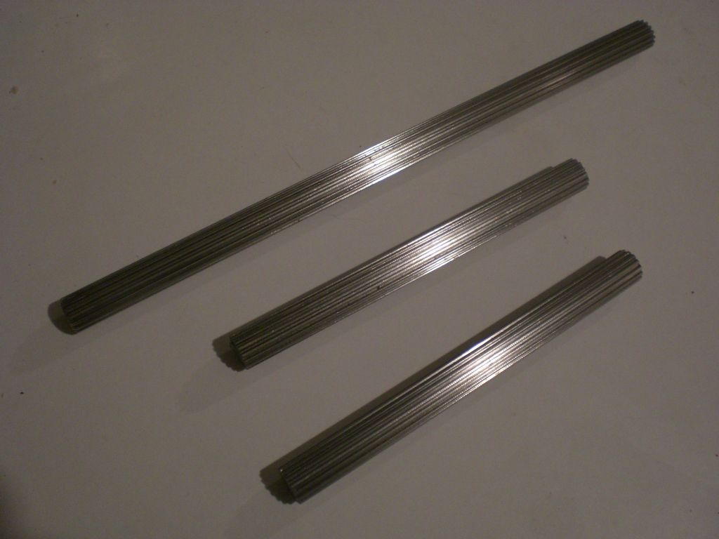

                                                      Here's a couple of photos of the main parts before reworking them, although the base on the top right had already  been machined when I took the photo, so it looks much the same only cleaner.
                                                      Regards Nick.
