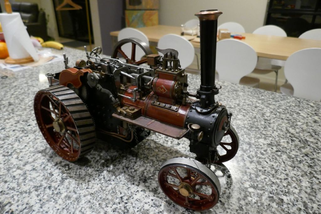

      Hello All..

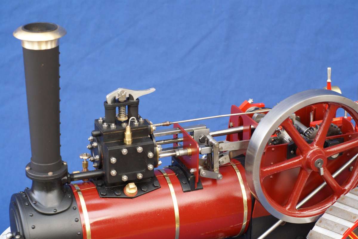

      A Friend of mine is wanting to start building the L C Mason 1" minnie.
      The original plans are still avaialble but there also seems to be a metric version available.
      Has anyone built from these plans ? wondered if they where any good.
      Thanks
      #23393
      Brian Abbott
        @brianabbott67793
        #157040
          The metric plans have only been about for a couple of months so certainly none completed, I have read of a few other people thinking of starting one using the metric drawings but not seen any sign of work.
          There are a couple of things that are not right on the metric drawing such as the cylinder studs protruding from the boiler, OK on full size where they could send a boy into the boiler through the manhole but in miniature you would never get the cylinder in place!!. I have e-mailed the source to make them aware of the error but have not seen a revised drawing. Its also still drawn to suit imperial DP gears not metric MOD ones.
          Whichever version you decide to go for I would highly recommend you track down a copy of LC Mason's book "Scale Model Traction Engine Building – featuring Minnie" Its out of print and fetches a premium but worth every penny. There is also enough info in the book to build the imperial version so you would be saving the cost of a set of plans, thats how I built mine.

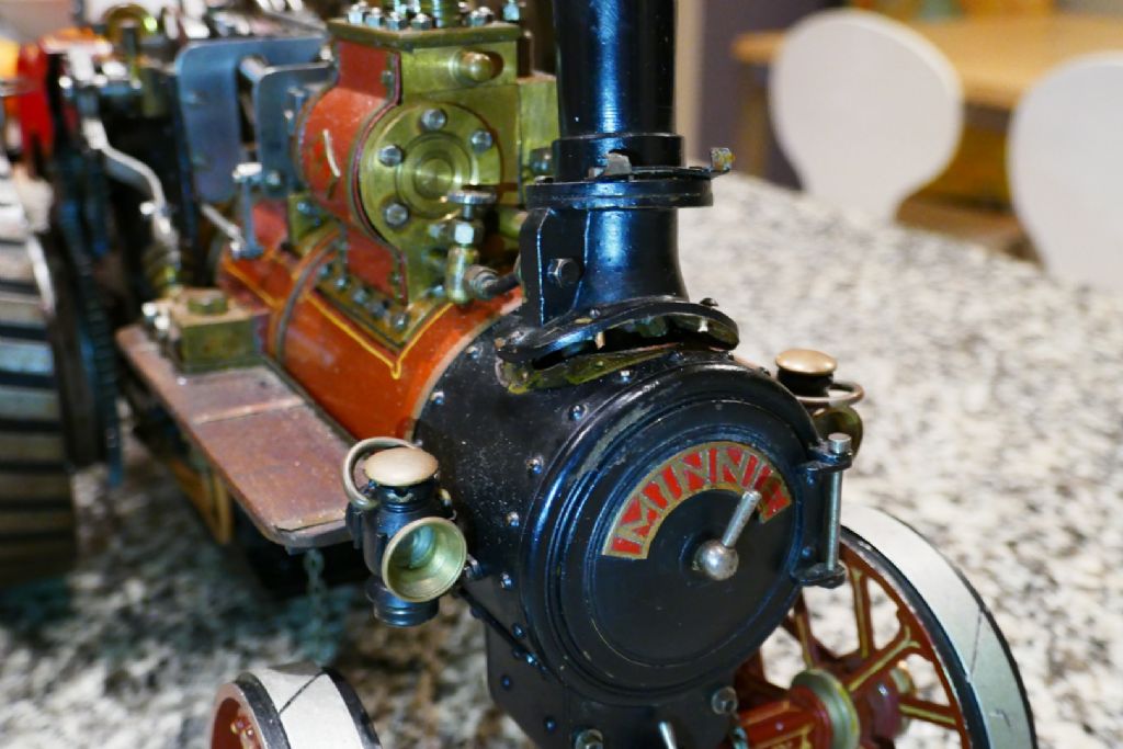

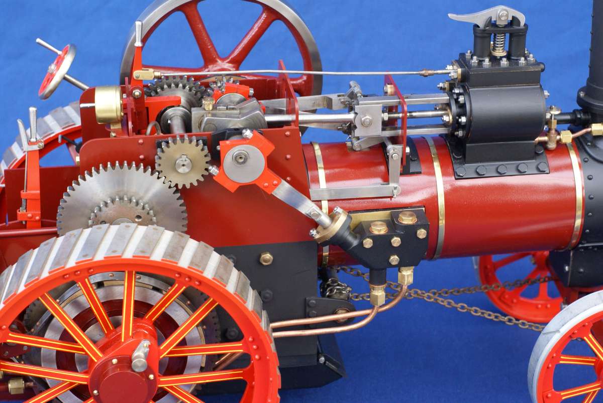

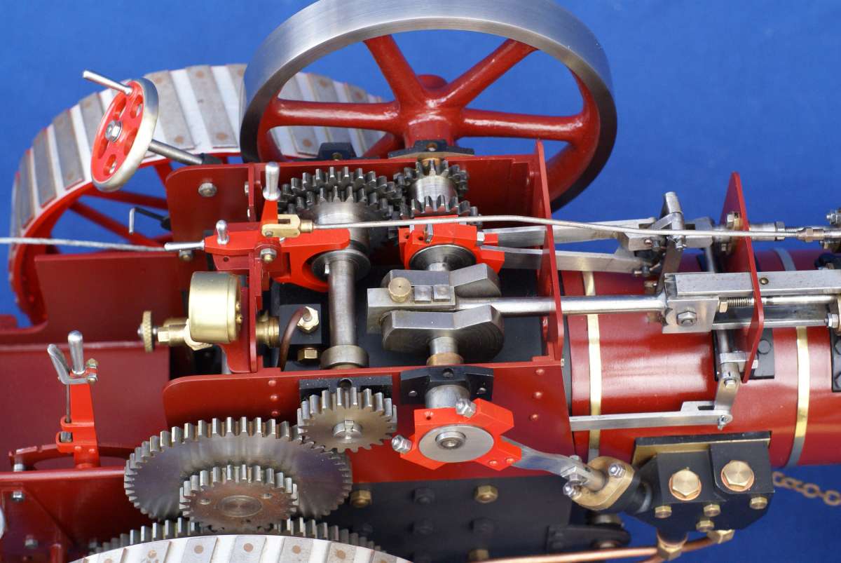

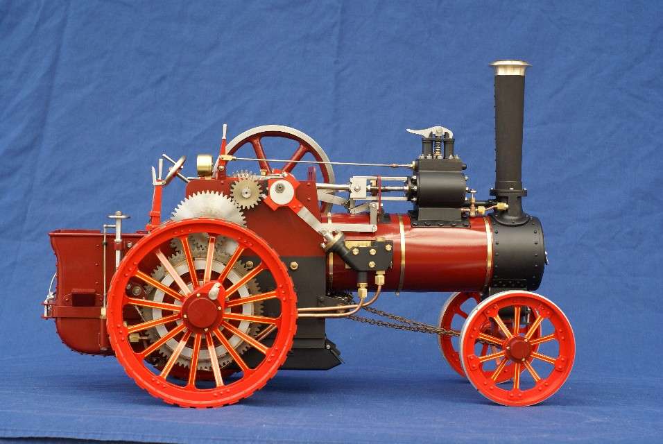

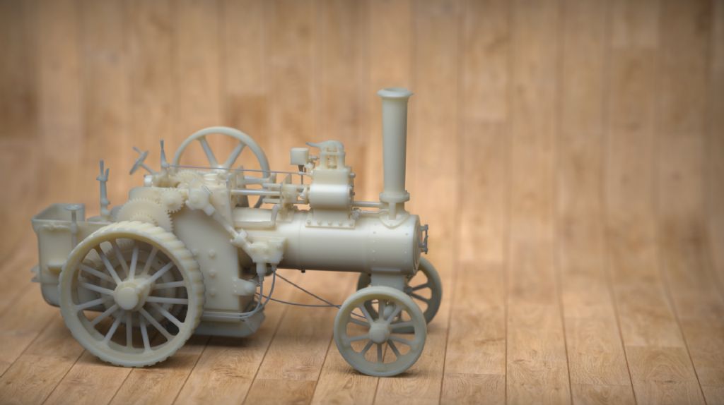

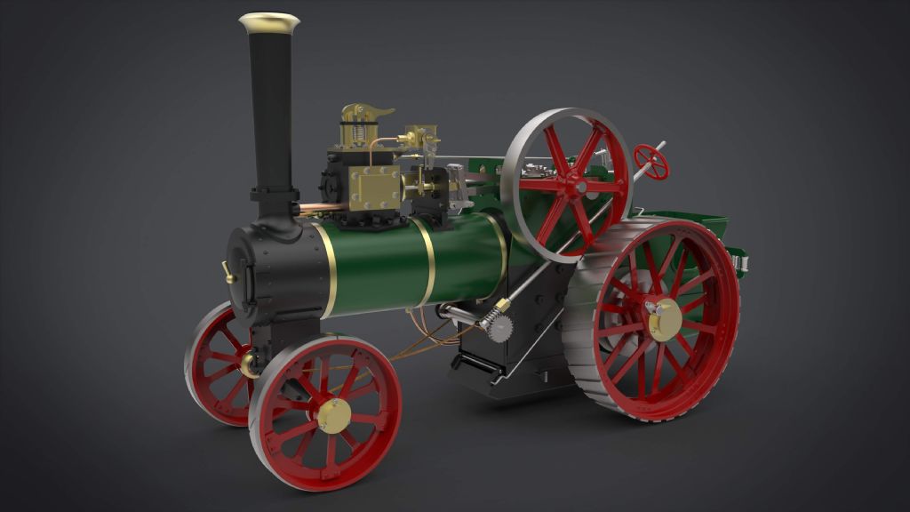

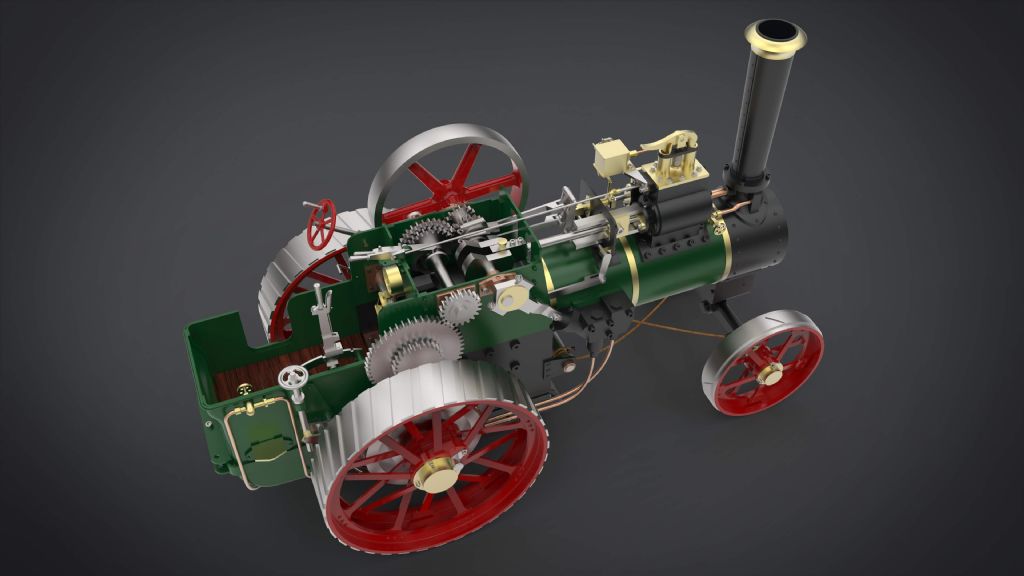

                                I recently was searching for CAD models on the GrabCAD website and found lots of useful information like a 3D Solidworks computer model of a 1" Minnie traction engine. The model was sent to a 3D printer.
                                Models are free to download after registering from grabcad.com.
                                Paul

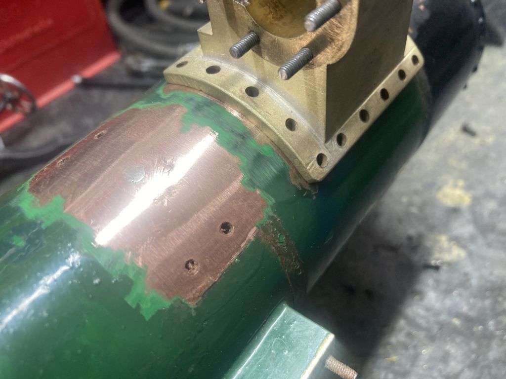

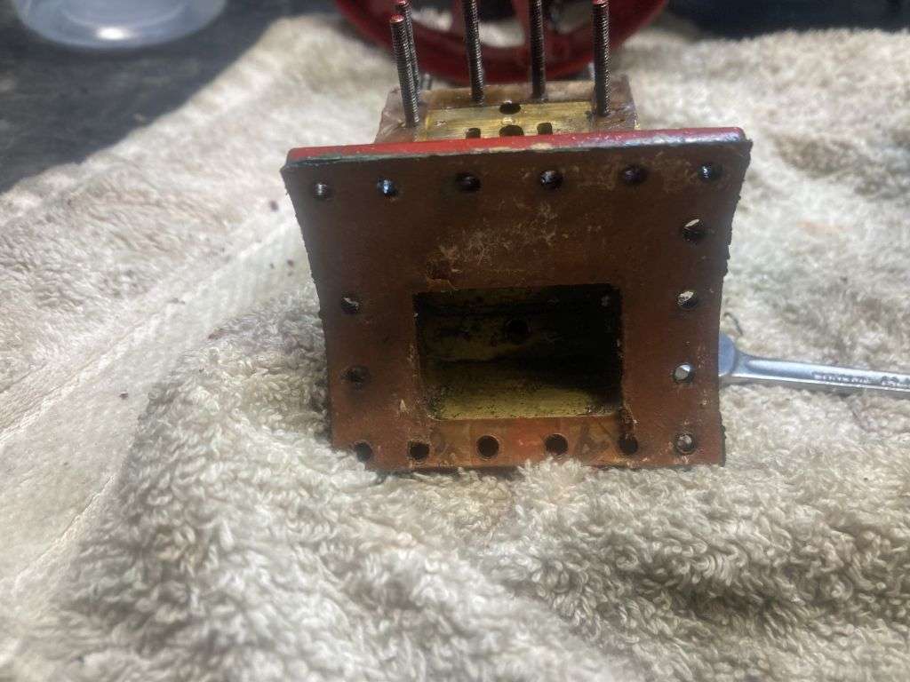

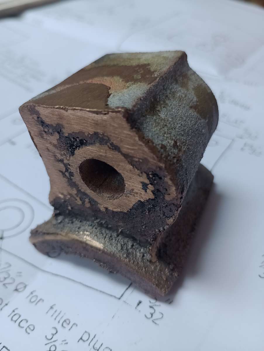

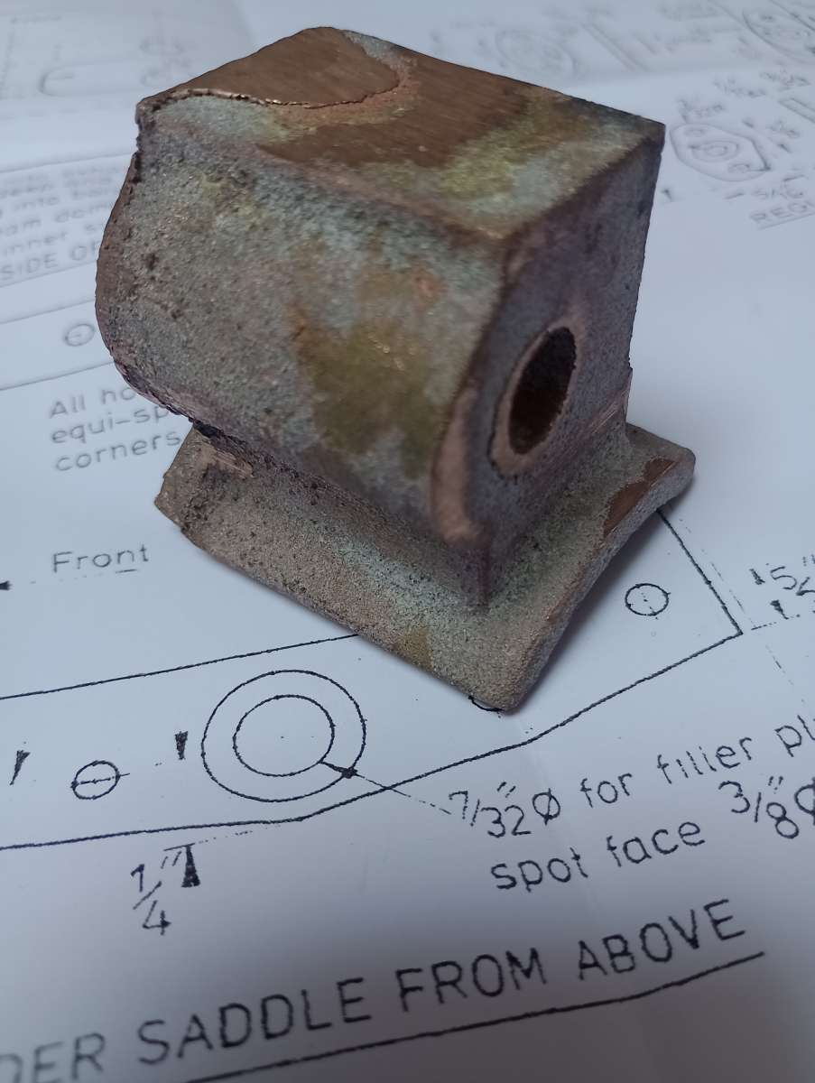

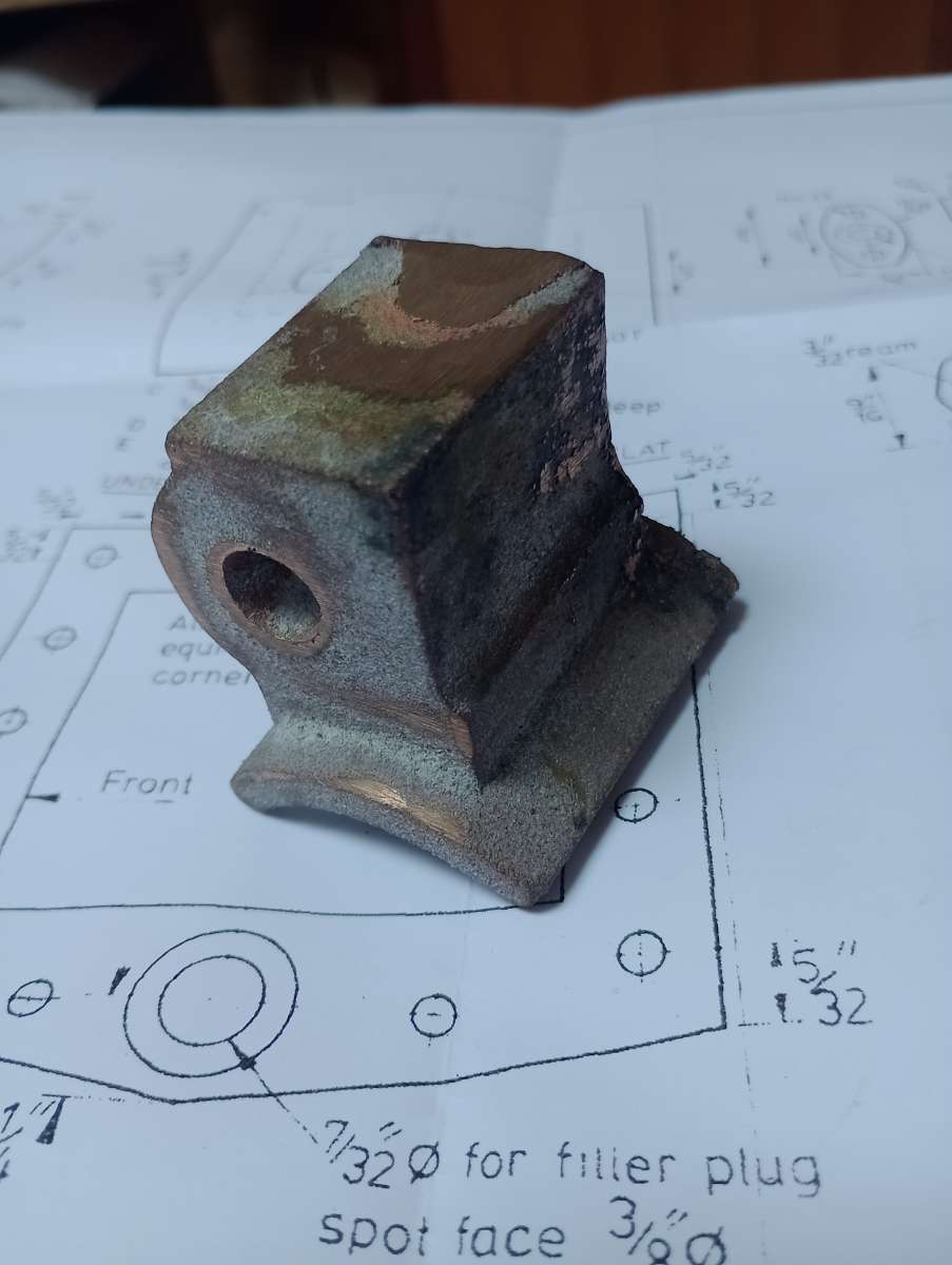

                                  Hi,how do you fill the boiler on a Minnie please?
                                  #354375
                                    The Filler plug is the square headed plug in the middle of the cylinder flange on the valve chest side, that can be used for initial fill when cold.
                                    #354378
                                    Terry Chapman 2
                                      @terrychapman2
                                      Posted by JasonB on 17/05/2018 15:17:57:
                                      Thanks for that Jason, found it.
                                      I need to pressure test this for my own safety and generally found out how to fire it up and maintain it.
                                      Any ideas where I could find this info as Im sure you dont want to list it out lol??
                                      Thanks.
