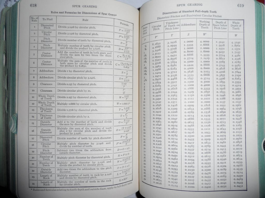

                Thanks Again Brian,
                FYI Look what I just found !! What does the good book say. Look and ye shall find.
                Or does it say Pie = 3.14
                Edited By Paul Kennedy on 30/12/2018 15:05:58
                Edited By Paul Kennedy on 30/12/2018 15:06:11

                    Diametral pitch (P) is defined as number of teeth(N) divided by pitch diameter (D)
                    I.e. P=N/D
                    Or rearranging, D=N/P
                    Outside diameter (OD) is pitch diameter plus twice the addendum, and the addendum is 1/P.
                    So OD = N/P + 2/P = (N+2)/P
                    Hope this helps

                      There is an erroneous assumption in the original post. The addendum (J) is indeed one over the diametral pitch (DP). In theory the dedendum (K) is the same. But in practice clearance is needed. By convention the dedendum is 1.157 divided by the DP. The working depth is J+K, ie, 2.157/DP. For low numbers of teeth more clearance is needed so the dedendum can be increased to 1.25/DP. The depth of cut (J+K) is often engraved on involute cutters to save confusion.
                      Andrew
