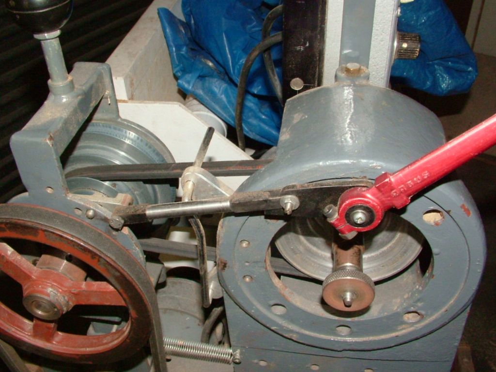

      OK Guys, Sorry for the title. Just a little humor. SO I'm looking for a Zyto Owner that has an intact Counter-shaft. If i cant find a second hand counter-shaft I intend on making one ! I would prefer to replicate the original but before I do I would like some feedback ! Is it any good for a start ? I don't wish to copy a poor design. Have you or has yours been modded in any way to improve it for instance ? I have a ML7 and its counter-shaft is sorta integral to the lathe so I'm open to other ideas from other manufacturers as well but think the easiest route is to copy the original. That being said I would need some sizes. A sketch perhaps with some dimensions. If your feeling particularly pedantic a parts drawing with accurate dimensions but even approximations will be useful so i can 'sorta' keep it to similar dimensions as the original. I'm intending on using steel plate and flat bar welded together with some round bar welded in to hold the bushes/bearings and then through hole bore on the ML7 to ensure accurate alignment. The frame will be entirely welded so .. Not the best but I don't have the capability to cast iron. :/ The best picture i have to work from so far is below.

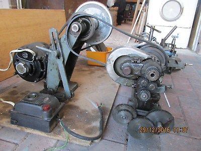

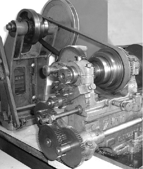

          I've got a *much* older Zyto countershaft – it's basically just two tall pillow block type bearings, with no motor mount. I think it was intended to run from line shafting above via fast and loose pulleys.
          I will be constructing a new countershaft for my zyto at some point, so I'm interested to see what you turn up.

            I've someone on the job looking for one for me and Id rather the original, however there is a number of problems, the worst is i'm an impatient ******at times so much so that my knick knacks itch and i don't have crabs, least i don't think i do SO That being said, i'm very keen to get cracking and build one. I've been thinking it out in my head and made one or two sketches of the original bench mounted design. What i'm planning is welding up steel plate, angle iron, flat bar and round bar to make the frame and base. And then machine it. Easier said than done but it shouldn't be too difficult given the right tools. I think I have most of the main tooling i require but there's always something you miss.Im really lacking actual workspace and might have to wait untill the spring summer or at least untill i get some dry weather and try tackling it outside in the carpark or the green. No welding bench either so it will have to be a plate of steel on a B&D Workmate Workbench ! I'm also looking for better photos for a start so i can import them into autocad and then scale them correctly with a known size so i can generate reasonably accurate plans compared to the original bench countershaft. So i'm playing myself at this point but thinking and planning don't cost me any cash so.
            If my friend fails in his quest then I hope to be prepared to just make one for myself but id need to reach into my pocket to buy the materials, and misc other stuff to do the job. I know i don't have a through hole boring bar for instance so there are things i'm still missing that i will need to make the thing. I'm also thinking about putting bearings on the spindle rather than bushes or maybe it just ran in the bare cast iron back then. Bushes or bearing. Hmm not sure on that one yet. Olite bushings is more authentic if still not strictly speaking original but the whole frame is fabricated and not cast so is there any point in even trying to be authentic with the frame :/ My first hurdle is to get some decent photos that both show the details and are reasonabaly square on so i can scale relatively accurately. I've put out some feelers out to a guy that I think has the lathe I displayed earlier.The pulleys will be another problem but i will see what i can do about that nearer the time if i go ahead with it. It seems everything you do at home suffers from the chicken/ egg problem. you need the tool to make the tool to make the bracket used on the thigy me jig to clamp the whatsnot so you can, i dont know, make the part. Or you can spend a wad of cash on stuff you will likely only use a half dozen times.
            Also I dont want to start this only in a month or two have my mate say hes found it and for me to have wasted the little spare cash on stuff to make the countershaft when i could have bought one if id just been a bit patient !
            Another route is to bolt two plumbers blocks to some 2×4 and jury rig something out of that but thats not really me although if i was in the desert or at sea i would because id have to. Ive seen a photo off your older countershaft and have also considered an intermediate solution. Ive seen a photo of a countershaft whose frame was made from unistrut as well which was both an inspired solution but ********* rough as a badger's ********* ><

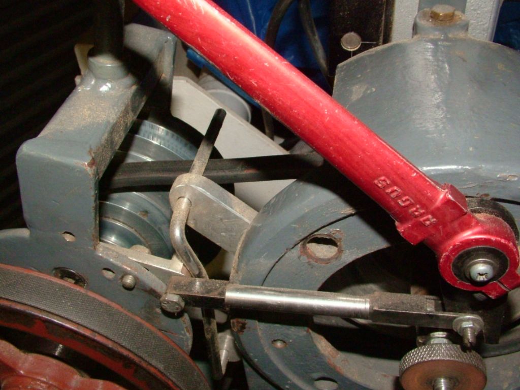

            The opposite side if interested.

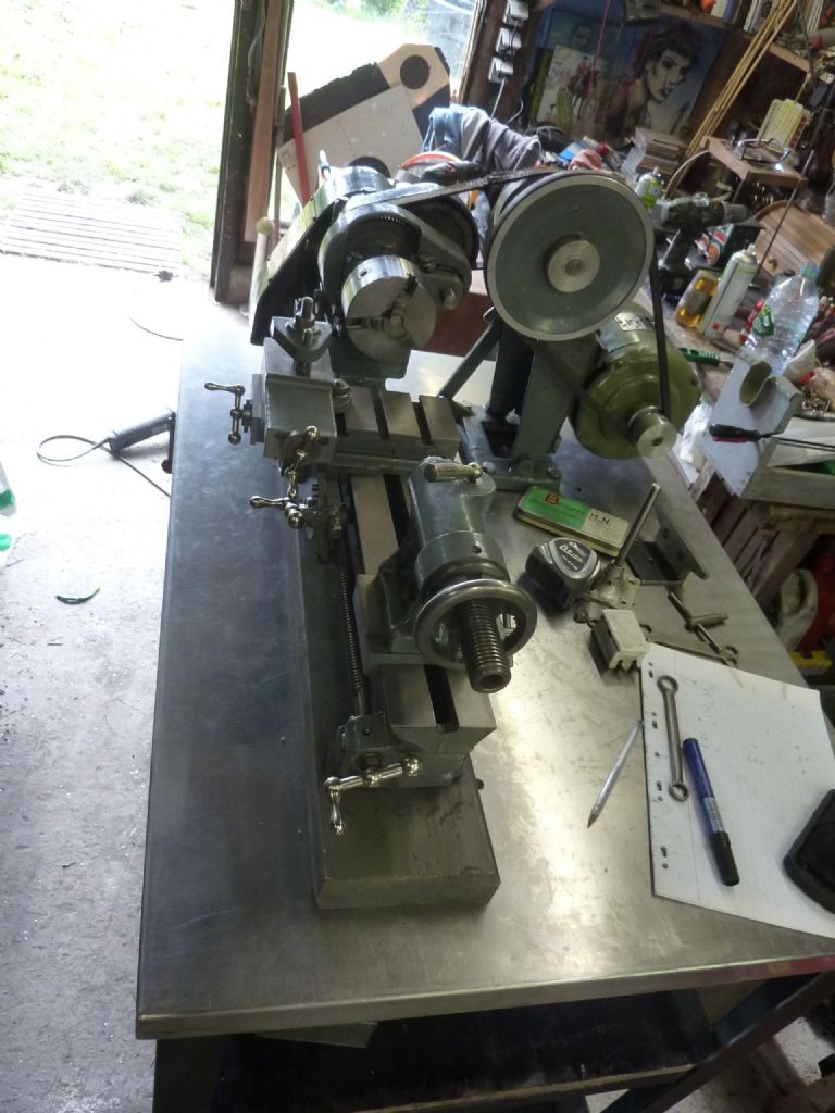

                          #485897
                          Dibnah
                            @dibnah

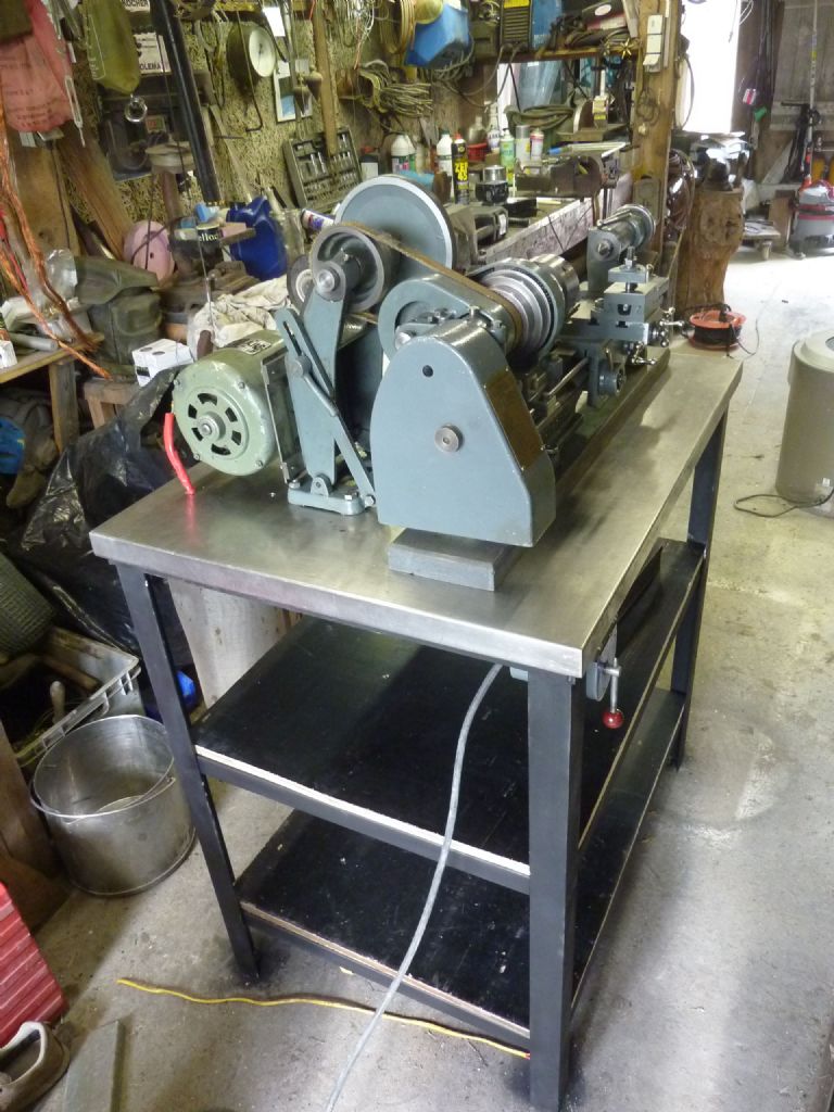

                            Hi A new custodian of a "Zyto" here. Will post some pics shortly. Plan to make a steel frame from scrap and mount the motor and countershaft above the lathe to reduce the footprint. The motor and countershaft have been mounted to 1/2" plate to the rear previously which seems overkill to me. If I'm about to do something that is obviously foolish please give me a nudge. I think I have enough angle iron to sit tray on and some 40mm box for the legs, will likely throw a shelf underneath too to collect plenty of random bits and pieces. Have asked elsewhere on here about pulley belt. It has had a belt too wide for the current set up and will only seat on middle pulley so want to use either an inside out Poly-V or a powertwist v belt but not 100% sure if either will run well on the existing flat pulley arrangement both on the countershaft and the spindle side ? Ideally the Powertwist as I don't want to strip the spindle out to get belt on. ( If I do then the cheap otion of a poly-v if it runs ok ?)
                            #485932
                            oldvelo
                              @oldvelo
                              Hi Paul
                              Belt tension, speed changing, With a countershaft on self aligning bearings
                              Swinging the weight of the motor to tension the belt is not best practice
                              Eric

                                Nothing wrong with using a Workmate bench for welding up things, I do it all the time and I have a 40 ft x 20ft workshop. Problem is that I cannot see the real workbench anymore, it has become submerged in half-finished jobs.
                                Anyone else been there ?
                                Also, nothing wrong with making up your own countershaft, it,s not for show, is it ?indecision

                                  Perko7
                                    @perko7
                                    Just in relation to oldvelo's final comment that 'Swinging the weight of the motor to tension the belt is not best practice' I would like some advice on why it is considered so. I have used this method on my old flat belt drive lathe for several years but if there are good reasons to change my arrangement I'm all ears.
                                    I have found that it provides even belt tension when changing between the three steps on the flat pulleys and, with careful arrangement of the pivot point location, allows the belt tension to not exceed the power capacity of the motor. In fact I use considerably less tension as it is a useful safety net should something jam or get caught while in use. It does mean I can't take heavy cuts but it's a very old machine and I treat it gently out of respect for it's age. The only problem I have had is shaking of the bench as the motor is not rigidly held, and any minor irregularity in the belt results in shaking of the cradle holding the motor and countershaft, causing the bench to shake as well.

                                          Hi perko7
                                          Well done you asked the question and answered with one posting. A factory with motors all jumping and swinging like hammocks in a storm at sea comes to mind
                                          Eric

                                            Thanks Eric. I'm still not sure though whether there is any other underlying reason that it's not a good idea.
                                            The problem with the shaking bench will hopefully be resolved with a new belt (I obtained some lovely new leather belting from a local shoe repairer) but I'm also considering putting in an adjustable tensioner which will hold the motor reasonably still rather than emulating St Vitus. Still don't want too much tension though. I did once get the cuff of a jacket sleeve caught on a workpiece in the 4-jaw while running at low speed in back gear. I had enough strength to prevent the rest of my arm from joining in but it was a close shave and I'm glad I wasn't running any greater tension. I don't wear long sleeves anymore when using the lathe. In the Aussie climate it's not often necessary anyway.
                                            #486318
                                            oldvelo
                                              @oldvelo
                                              Hi Perko7
                                              You can adjust a fixed tension on on a belt drive to vary when the belt will slip.
                                              I do this on the mill when tapping threads with a motor that has instant reverse and ramps back up to speed no broken taps for years.
                                              With the wieght of the motor swinging on the tension you have the motor pulling on the belt able to lift up and drop down this will over tension the belt and the motor climbs again is the most likely cause of the oscillations.
                                              A heavy intermittent cut at slow speed will demonstrate this best.
