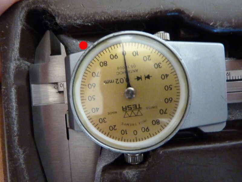

      I have just purchased from eBay a s/h Tesa dial gauge. I am very happy with it, it moves like silk, zero's correctly, and gives absolute consistent readings on repeated measurements.
      I have two related questions
      1) It is currently reading a "perfect" zero when fully closed, but I would like to know how to adjust this, if needed. On my current (cheap!) GRP Rabone dial gauge, you can simply rotate the dial with the numbers as required, against friction.
      2) Related to (1). The current dial face is upside down! This particular gauge face reads 2 mm per full turn.
      I can see 2 knurled knobs, and 1 recessed screw (roughly where I've added the red dot).
      The upper knob locks the travel. The lower knob has no effect (that I've discovered yet), and I haven't tried undoing the small screw.
      Can anyone tell me how to rotate the display dial, or (more generally) how to use this dial caliper?
      BugBear

          You "should" find that the knurled screw at the bottom unlocks the scale, for rotation.

              Posted by Michael Gilligan on 13/02/2017 11:34:45:
              I've loosened that screw, and tried to move the dial. To the limit
              of the force I'm prepared to apply, it doesn't move.
              It's either the wrong screw, or the dial is stuck.
              BugBear
              #283949
              bugbear6502
                @bugbear6502
                I've found an Amazon document for a Brown & Sharpe product (B&S, Etalon and Tesa are all the same) that says "The bezel lock screw locks the dial and the slider lock screw holds the sliding jaw in position."
                Since I know by experiment that the upper screw locks the jaw nicely, the other screw must be the bezel lock. And yet the bezel won't move.
                "darn"
                BugBear
                #283950
                  I would next try loosening the recessed screw by the red dot.
                  … It may have been overtightened [or even replaced] by the previous user.

                    Posted by Michael Gilligan on 13/02/2017 12:13:10:
                    Please pardon my ignorance (which is vast); what does the recessed screw do?
                    BugBear
                    #283952
                      Posted by bugbear6502 on 13/02/2017 12:18:58:
                      BugBear
                      Typically, it has a plain section on the inner portion, which sits under a ledge on the dial and prevents the rotatable scale falling off. … If it has been substituted, or abused, then it might be locking the scale.

                          BugBear,
                          I have an identical TESA dial calliper. I have tried it just now and can confirm that you should loosen the bottom screw and then the dial should be movable. On mine the dial moves very easily and smoothly so yours is stuck for some reason. Do not interfere with the two small recessed screws at the top as these are for adjusting out any slack in the slide. A bit like jib adjusters. The large screw at the top is simply a to lock the slide to retain a reading.

                            Excellent info – thank you. I hadn't even noticed the right hand recessed screw blush
                            BugBear
                            #283960
                              Reading Lambton's note … and looking back at the photo … I realise I may have misinterpreted the red dot !!
                              I thought it was marking the position of a recessed screw in the rotating bezel.
                              … If it's one of the two gib-adjusters then please accept my apologies, and leave it well alone.

                                OK ; thanks to all for your information; it looks like my calipers are simply/purely malfunctioning and that the dial is stuck (for whatever reason).
                                Given that they currently move beautifully, and are correctly zero'd, and very accurate, I will leave well alone.
                                BugBear

                                    Bizarrely – the dial now rotates, albeit very stiff. And I didn't apply extra force. Strange.
