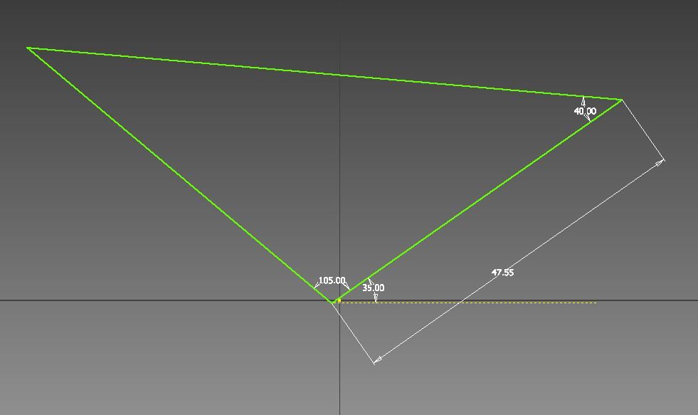

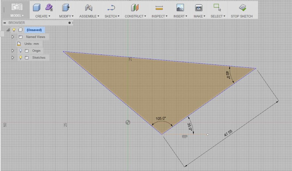

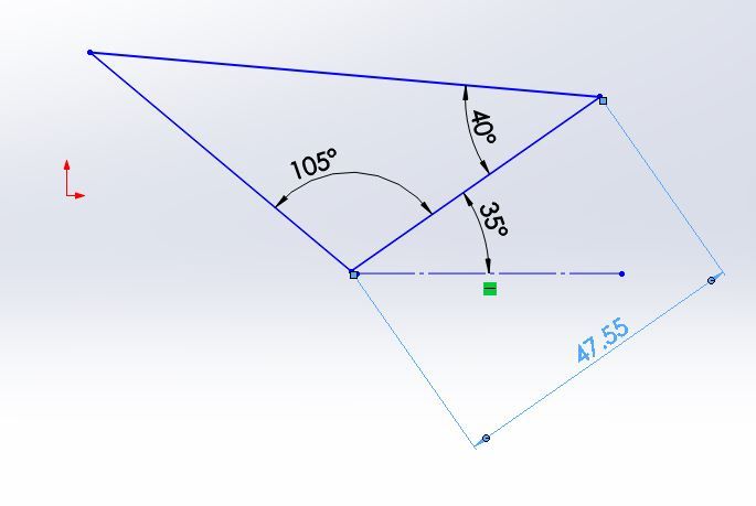

                                        #200560
                                        Muzzer
                                          @muzzer
                                          In the interests of science and being confined to my hotel room (Kunshan, China), here's my contribution:
                                          Solidworks 50 seconds:
                                          Fusion 360, 52 seconds:
                                          Fusion 52 seconds
                                          Inventor 45 seconds:
                                          Inventor 45 seconds
                                          All starting from the 2D sketch environment. Very similar process, very similar times. If there was beer money riding on it and I practised a couple of times, I'm sure I could get that down to 30 seconds or so and I'm not even a CAD jockey. Naturally, Inventor crashed just after I took the screen shot but I'm getting used to that now – not my favourite by quite a way.
                                          Solid Edge is slightly different and potentially faster, as it asks for the angle and length when you are placing lines, so you could put the lines in directly without needing to do so much dimensioning afterwards.
                                          The modern version of Alibre is Geomagic or Cubify, depending whether they are selling to professional or home/school users. The latter starts at around £30.
                                          I don't buy the argument that it takes ages to learn 3D CAD so you should choose carefully now. In fact, once you've used one brand, you discover that they are actually fairly similar – and of course that's hardly surprising given that it's a competitive market place. Try a few out and find which works for you.
                                          The current version of Turbocad Deluxe seems to be v21 and costs something like £65. Fusion 360 is free, well supported and has a lot of extras. Just saying….
                                          Murray

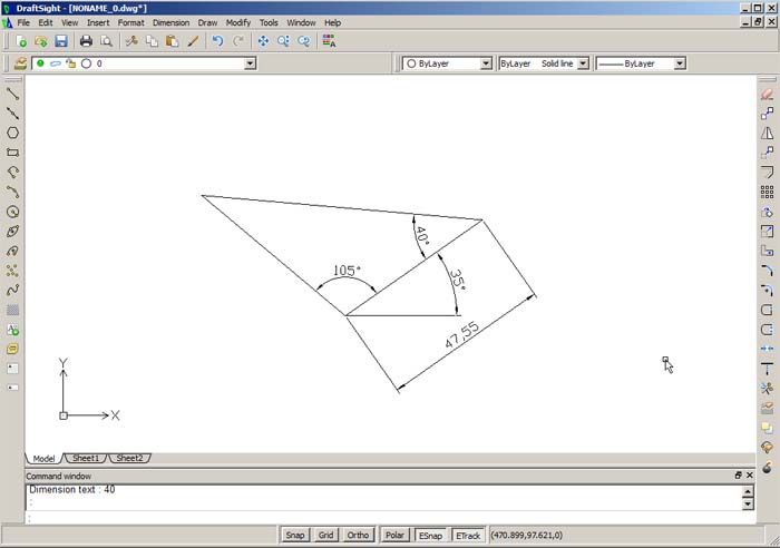

                                                  #200615
                                                  Roderick Jenkins
                                                    @roderickjenkins93242
                                                    HansR,
                                                    Draftsight:
                                                    Use the @length<angle command to draw the 47.55 line
                                                    Calculate the angle and draw the top line @90<175
                                                    Calculate angle and draw the bottom line @90<140
                                                    Trim the 2 lines where they intersect.
                                                    Dimensioning very straightforward.  Just choose the relevant command and select the required lines.
                                                    I've no particular axe to grind. I had DesignCAD on DOS and had some training and used Autocad in 2D mode. 3D Autocad I found a bit more of a trial – specifically determining where I was in 3D space. I used Autocad in 2D to generate DXF files for 2 1/2D CNC for a mill.
                                                    This is my first attempt at using Draftsight – I needed to search the internet to find the @X<Y command!
                                                    Cheers,
                                                    Rod
