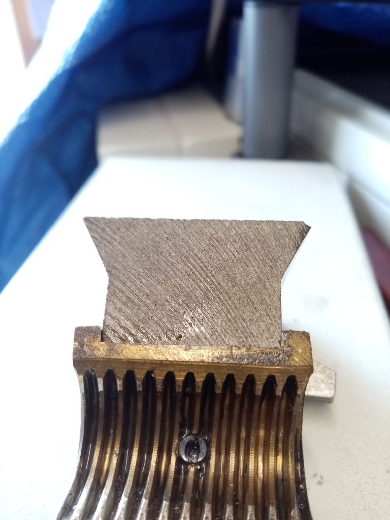

                  I have stripped the lathe down completely and chased the leadscrew threads that were rough, I don't want them wearing the nuts out. Further examination was required so I took the carriage apart and straightened out the carriage hand wheel shaft. It now travels down the bed from tail to head nice and silky smooth.
                  I found screw cut engagement was not reassuring so I stripped out the half nuts, the photos below show (1) how badly the carriage was assembled in manufacture, that screw was put in before the hole for the other screw was drilled, crazy as there is enough room for it to have been drilled where it couldn't interfere with the first screw.

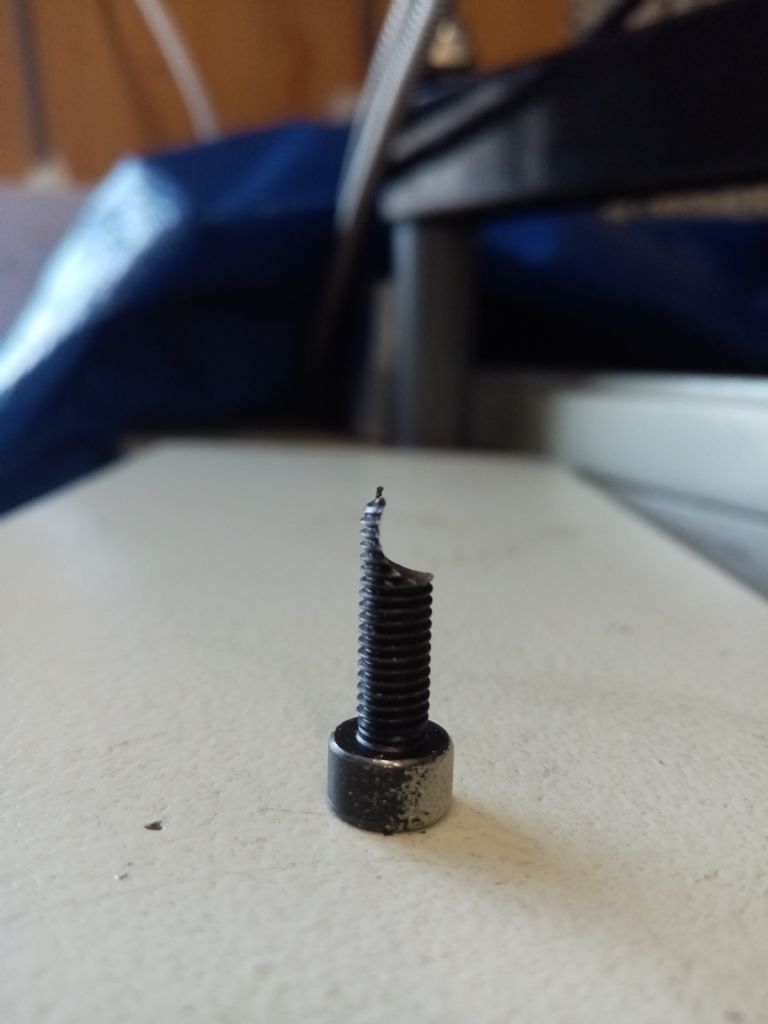

                  The second photo shows how the screw holding the half nut bronze sleeve to the casting, was just a bit too long so the leadscrew could not be engaged to the full thread depth.

                          Thank you everyone for your help. 20 turns of the leadscrew produced a travel of 2 1/2 " so it looks like it is indeed a 7/8 dia by 8 TPI leadscrew. I have now reassembled the lathe and it is much better, half nuts fully engage and stay there. Initially I was concerned by the amount of backlash still in the train and chased that back to the roll pin, fitting a new one has cured that so it looks like it could be a useful machine now that all of those snags are ironed out.
