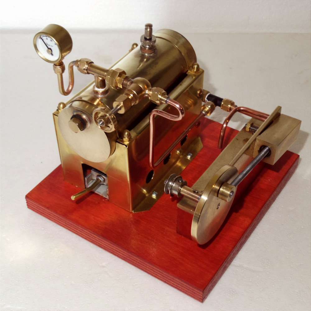

                The above steam engine was constructed from the Opitec 420 kit (with a few modifications). The Opitec 420 can be built with hand tools and a drill press, no lathe is required. It is designed to be built by schoolchildren.
