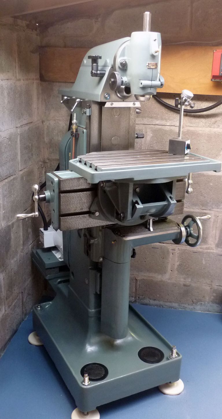

                      Get one of these ,ive never regreted it.smiley

                                          Hi Mark, is it a Deckel?
                                          I could really fancy one of those, it's even better than my Centec 2B

                                                Hi Gary, not a deckel but a GHA Alexander, so basically a clone.

                                                  We had an Alexander where I used to work, very nice machine. What taper is it in the vertical head, they never managed to identify it?
                                                  #436992
                                                  Richard –
                                                    @richard-3
                                                    The Alex vertical head is 4mt, the original draw bar is S20, I'm getting quite proficient at cutting it, both internal and external.
                                                    I've done allsorts on mine, if you mount off the vertical where the table fits you can bore all the way to the floor!!
                                                    Point to note when using a vfd you will still be changing belts as you lose torque,
