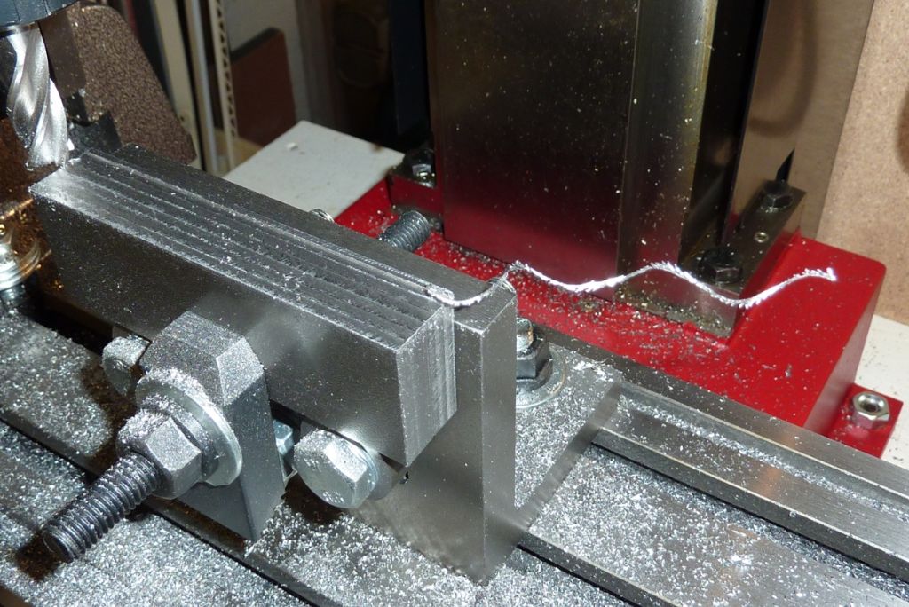

                                    To throw a further query into the mix, one cut resulted in this:-
                                    I'm sure this will tell most of you quite a lot, but it didn't tell me much apart from something might be wrong.
                                    Gary
                                    #121426
                                      Assuming you took your first 3mm cut off the front (towards you) side of the work what direction was the work traveling in?
                                      Oh it also tells me you need a vice.
                                      Edited By JasonB on 03/06/2013 18:52:14

                                          Posted by JasonB on 03/06/2013 18:51:56:
                                          Work was travelling right to left (conventional milling). I've been very careful to avoid climb milling until I know better what I'm doing.
                                          I have a vice, it is further along the table. I was using Harold Hall's technique for making a parallel by using two cylinders bolted to the angle plate. Then take a light cut off the top of both cylinders and mount the workpiece on top. I think it is supposed to ensure that the two sides are parallel to a much better accuracy than just mounting in the vice.
                                          Gary

                                            Looking at that machined workpiece… your chips are like dust which means the endmill isn't cutting like it should. Looks like you cut it dry… and the stringy swarf again suggests the cutter isn't cutting cleanly. The finish doesn't look good either (difficult to tell from one photo at one angle), it should be smooth and shiney. Might be too high a speed on the cutter, might be a blunt cutter, might be very 'sticky/gummy' steel. Best to play around with different parameters on a piece of scrap )of this material) to familiarise yourself with what works best for it – they all respond differently.
                                            For your machined parallel – if you turn the piece end over end (180deg flip) it will come out parallel even if the bottom of the vice is not perfectly aligned with the lathe bed.

                                              > Also for the same given 3/8" bit of steel on the same out of tram mill the larger swing of a flycutter would produce a less concave surface than a smaller dia endmill.
                                              Would it?
                                              Imagine the extreme case of having the cutter tilted right over. the endmill would make a smaller furrow than the endmill. As the out of tram gets less, the difference remains in proportion.
                                              I agree with Chtris, that cutter isn't working hard enough. That stringy swarf suggests it's pretty tough steel too.

                                                  Gary: If the 'stringy' swarf only appeared on the last cut, near the edge of the work then I wouldn't worry about it. I think it's the result of cutting near the edge rather than a problem with feeds and speeds. I sometimes see something similiar using very different cutters, much higher speeds and feeds and a different mill. My first thought on the relatively poor finish would be too look at the end mill. What brand is the end mill? I'll try and sketch something out on the width of cut issue, as I see it, tomorrow evening.

                                                      Andrew, I think you're right about the swarf. It was on the last cut and as the total width of the two parallels was ~19mm and I was taking cuts of 3mm the last one was ~1mm. The end mill was a no-name one from RDG and as Dormer 12mm end mills seem to be about £30 it would probably fall within the definition of 'cheap'. I might have a go at checking the tram at weekend.
