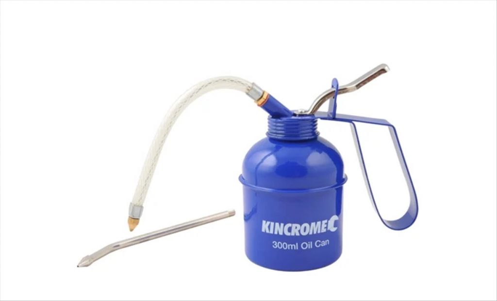

                          #490710
                          Paul Lousick
                            @paullousick59116
                            Oil can with a flexible spout for those difficult locations.
