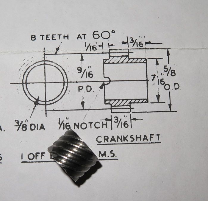

              Hello all.
              Embarrassingly , I’ve still not progressed this very far, despite the fact that it’s more than 6 months since I asked the original question.
              Anyway, my question today is how are the gears actually fixed to the crankshaft. I can see there is a 1/16 notch cut into the crankshaft gear, and a 1/16 hole drilled into the camshaft gear, but it’s not clear to me how these are used to lock the rotation of the gears to the rotation of the shaft. I’m guessing it involves pins into the shafts, but I can’t see this marked on the plans.
              Thanks in advance,
              David
              #302235
                Press fit pin into shaft, could Loctite if not happy with tightness of press fit or even use a taper pin.
                #302259
                John Purdy
                  @johnpurdy78347
                  David
                  As Jason says a short pin is pressed into a 1/16" hole in the crankshaft to key that gear. I fixed the one on the camshaft on mine with a 1/16" roll pin. You might also read my post of 02/11/15 in the "Drawing Errors and Corrections" section of this forum (if you haven't already) as there are a number of problems with the drawings for the Wyvern.
