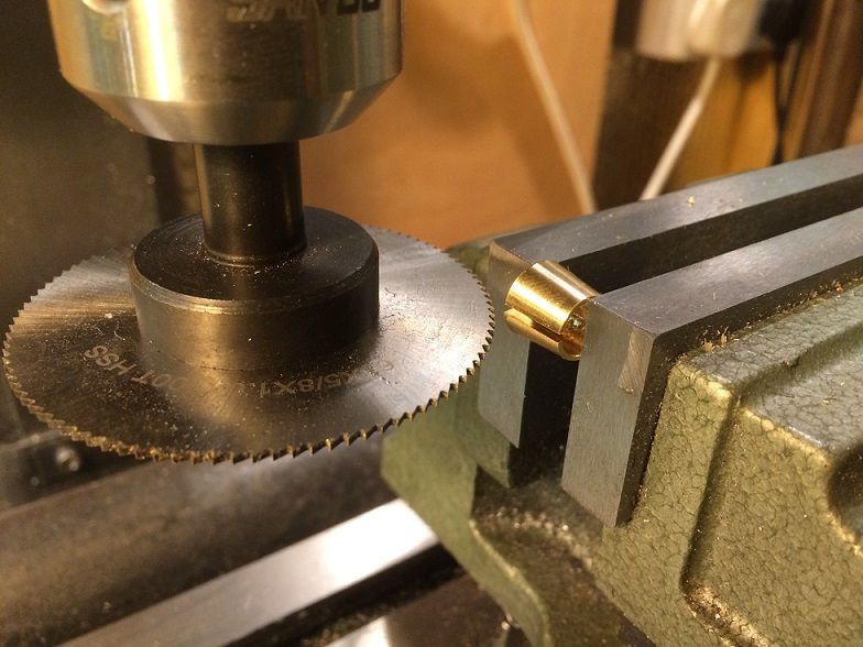

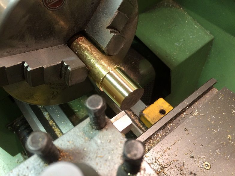

                      ok, here's my first question. (I'm starting on the easy bits). The plans call for a drive washer and a drive washer cone (i.e. a split tapered bush that will compress onto the crankshaft when the prop nut is tightened.
                      The drive washer is aluminium but there is no mention of what material the split cone should be, although it is shown on the same plan page as other aluminium parts.
                      My thoughts given that is going to be under compression and will receive rotational force that it needs to be steel and not aluminium. In my head I feel that two aluminium sufaces in contact like that would bind and potentially fuse.
                      Any opinions?
                      Cheers Craig
                      #352463
                      LADmachining
                        @ladmachining
                        I have used mild steel and brass for the split taper bush in the past on various engines, with no issues.
                        Aluminium, I think, may cause issues, by galling and welding itself to the prop drive hub or the crankshaft itself.
                        Anthony

                          I have used brass and you often see that used on commercial engines.
                          #352506
                          Craig Booth 1
                            @craigbooth1
                            Thanks Jason/Anthony,
                            I have managed to find the part on the parts list (in german) even though it is not referecned on the drawing and it is showing as brass, so brass it is.
                            Cheers
                            #352574
                            Craig Booth 1
                              @craigbooth1
                              well, i thought it was quite a productive evening, got the drive washer cone done (in brass) and happy with tolerances.

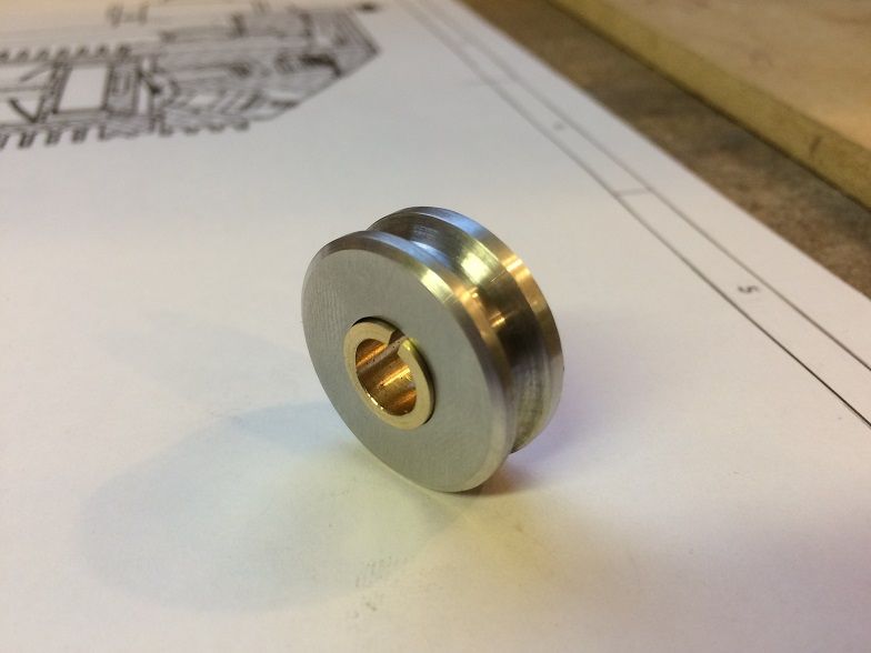

                                Craig Booth 1
                                  @craigbooth1

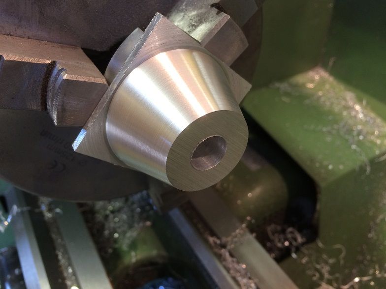

                                  worked on the prop driver. had a bit of a problem trying to get the internal taper on such a small hole. 11.3mm dia at the largest on 6 degrees, but got there in the end.
                                  I will cut the grooves to grip the prop in the front face of the driver once I get a involute cutter, which I will need for the timing gears anyway.

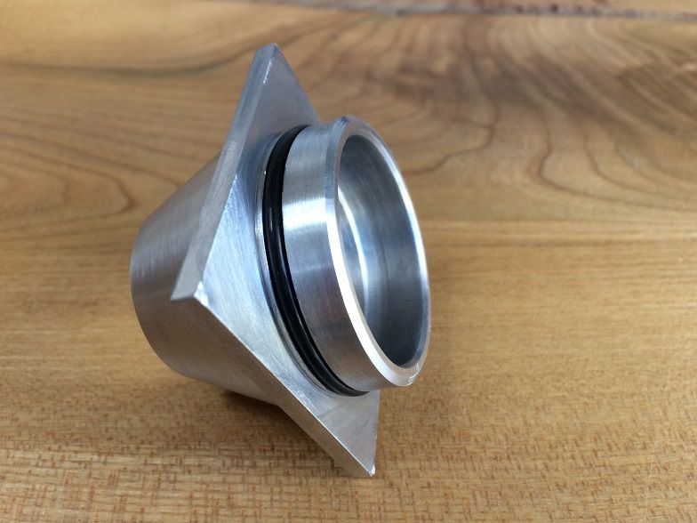

                                  Craig Booth 1
                                    @craigbooth1

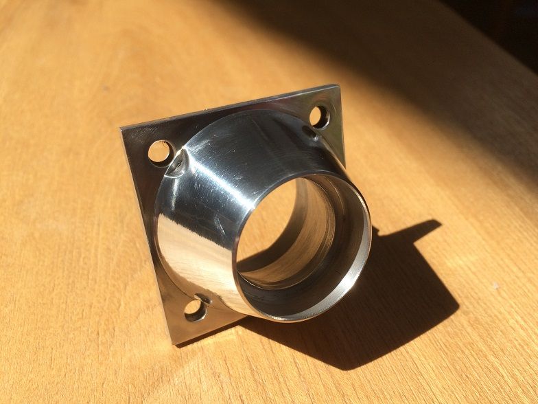

                                    also got around to most of the front crankcase housing. Turned the rear first including seat for rear bearing and groove for O-ring, then flipped in lathe and taper turned inside and out, then front bearing seat.
                                    Remaining square frame is still 0.5mm oversize until I make the main crankcase. Next will drill the mounting holes on the mill.

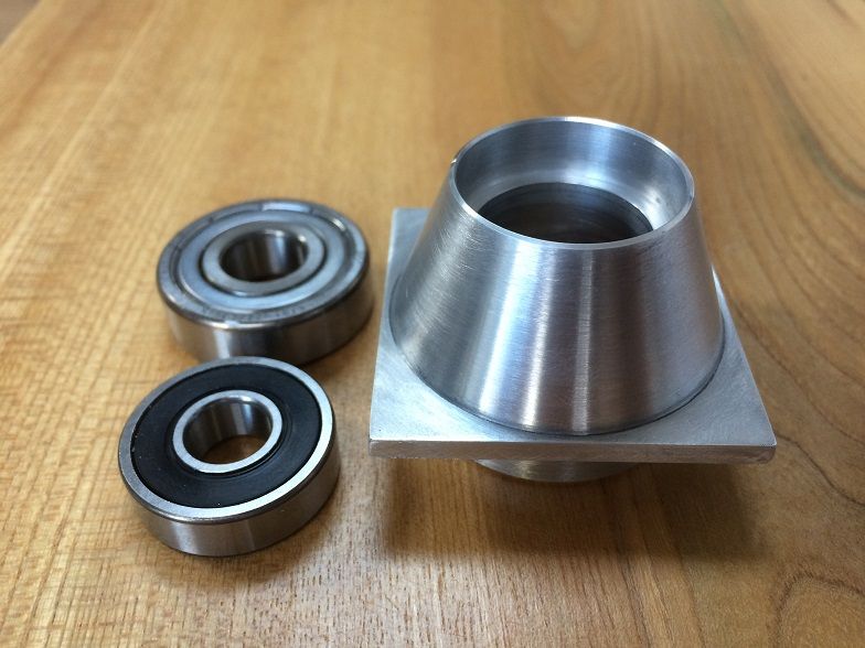

                                      Craig, my experience with using plastic shielded bearings is that they cause additional friction that leads to overheating the assembly but it may help prevent loss of crankcase pressure.
                                      Emgee

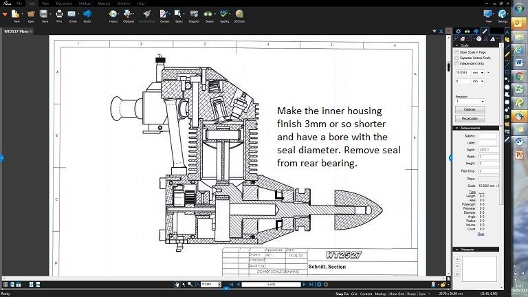

                                      Neil Lickfold
                                        @neillickfold44316
                                        Is there a sectional view of this engine you are building? Just curious.
                                        Thanks Neil

                                          Craig Booth 1
                                            @craigbooth1
                                            Thanks for the warning Emgee, it is a high temp version so I'm hoping will be ok, but will keep an eye on it.
                                            Here's a cross section from the plans.

                                            Neil Lickfold
                                              @neillickfold44316
                                              Thanks for the cross section. On model engines, instead of using the shielded bearings, they have a shaft seal, which has about 0.03 through to 0.07mm in diameter clearance depending on the seal area length. This is normally just behind the front bearing where it is at it's smallest clearance. The small amount of leakage then lubes the front race. The high reving ones leak quite a bit, but the slower reving ones dont. So on an engine like you are making, shaft seal that is 3mm long and about 0.03 to 0.04mm in diameter will seal the case nicely and you wont have any issues with seal drag either. But is seems you have made the front housing already, so unless you make another it is not going to happen. So in the case above, you would end up making the tapered clearance section about 3mm shorter from the back with a bore concentric to the front and rear bearing diameters, and be 0.03 to 0.04mm bigger than the shaft diameter.
                                              #353089
                                              Craig Booth 1
                                                @craigbooth1
                                                Hi Neil,
                                                Thanks for the comment. I did think about bearing lubrication when ordering but came to the following conclusion, these are sealed units (for life), life expectancy standards (without going into the full calcs that seem to be available) could be 300hours at a minimum, ranging at to the thousands of hours.
                                                IF I do get this engine to work and put it in a plane, I would on average have the engine running for 15hours per year.
                                                So taking worst case I would still get 10-20 years out of it. I'd be very happy if that was the case.
                                                Do you have a drawing that shows the principle you describe above? Even though the part is finished now I reckon I could still get a lubrication channel behind the back bearing, and I'd be keen to understand for other engines.
                                                #353212
                                                Neil Lickfold
                                                  @neillickfold44316
                                                  Here is a sketch of the added seal area. The gap is showing the small clearance, and will be a solid fill, I just drew an out line.
                                                  #353219
                                                  Craig Booth 1
                                                    @craigbooth1
                                                    Thanks for that Neil, if I understand correctly the lubricant wicks to the front bearing via the annular gap between the shaft and clearance made (0.03mm). As you say obviously too late to have that arrangement on this model, but would a fully open inner seal work, i.e. if I just remove the inner seal on the front bearing and make a small channel or two behind the rear bearing?

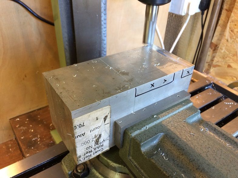

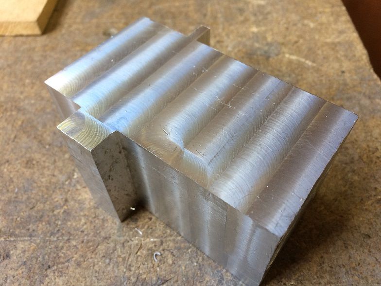

                                                    #353220

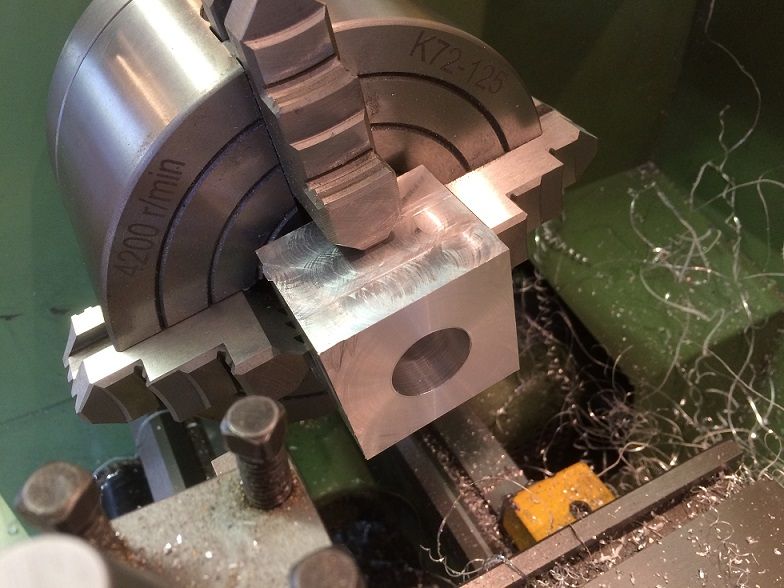

                                                    Craig Booth 1
                                                      @craigbooth1
                                                      also made a bit of progress on the main crankcase today. Was a lot of work to get the 70x70mm stock down to size (45×46, plus the mounts), but got there in the end, ankle deep in swarf. Now starting to work on the mounts.
