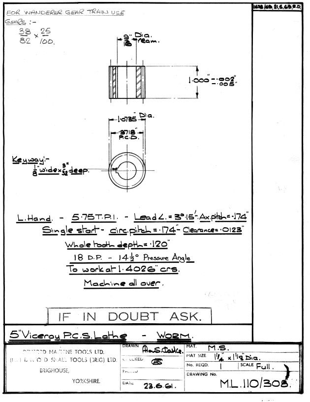

      Posted by Pete Rimmer on 08/01/2021 19:32:21:
      Well, given that the kind gentleman has pointed you to the correct drawing on the Denford forum:
      You now have all the info to produce your worm. Bonus if you can find a lathe which has 5 3/4TPI on the gearbox.
      CVA has that pitch on the gearbox as does my Monarch.
      The replies on Denford Data and this website have been very useful.

          Posted by AJAX on 08/01/2021 21:33:47:
          * Harrison M300
          That's the lathe that will cut an 18DP worm, provided you have the optional 56 tooth gear wheel for the drive train. I bought my gear on Ebay some years ago.

            @peterimmer30576
            The M300 at your work will cut that worm if you set it to 23TPI (C5SY) and swap the 88 and 44 gears around.
