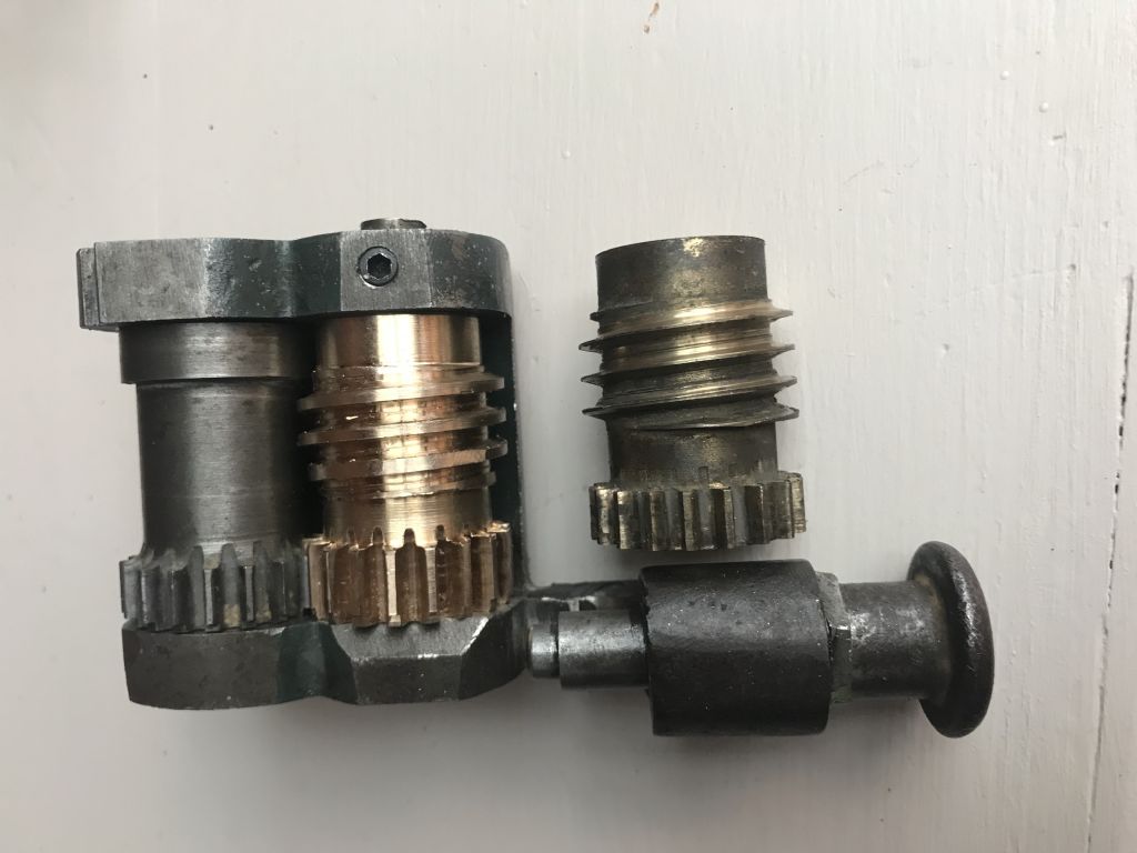

      I have a long-overdue job that needs to be done to restore this lathe. The feedshaft worm is badly worn and spares appear unavailable. I've been on the Denford Data website where there appears to be a number of knowledgeable and helpful guys and I'm hopeful that I can get the original drawings for the worm. With or without the drawings I would like to get a new worm sourced or made and I'm wondering if anyone can make a suitable recommendation. I'd expect to pay a fair rate but we have to be realistic as this is not a top-end lathe.
      20210107-162006 20210107-162353 20210107-183545 20210107-202040 20210107-202056 20210107-202105 20210107-202126
      Incidentally, by visual inspection it is my presumption the worn worm is the cause of partial engagement (and unwanted disengagement). The worm wheel looks to be in much better condition but it remains in the gearbox and taking a photo is tricky at present. However, I would have expected the worm wheel to wear at a faster rate than the worm but maybe I've got that wrong.
      I'm based in Dorset.
      Thanks for reading,
      Brian

        Nigel Graham 2
          @nigelgraham2
          I would suggest identifying the worm's and wheel's vital statistics and seeing what replacement stock items may be available and suitable for modifying to fit. You might need go nearest-metric and it could entail making or modifying other parts, but a bit more easily and potentially a lot more cheaply (say around £80 – £100 for a stock worm and wheel?) than having one-off specials made commercially.
          Don't replace the one without the other.
          This is similar to a problem I have with a Denbigh horizontal mill whose long-feed worm wheel is there (part of the lead-screw nut) but its worm and drive are long-lost. Another contributor here suggested I adopt that solution, turning the original wheel down to create a seating for a suitably bored-out new wheel, bought together with its appropriate worm.
          One advantage is that you know the worm and wheel are matched, and anyway, as I think he pointed out to me, there is no use in trying to match a new worm to a wheel that will also be worn, and may be of different pressure-angle to boot.
          The steel wearing much more severely than the bronze is not unusual, and some combinations of bronze and steel are worse than others for decades of living together in perfect harmony. The lathe's makers would have used the best but assumed a finite life. I don't know why but I suspect the softer material eventually becomes a de facto lap.
          One point to watch – it applies to my mill but I can't quite be sure from your photos – is the hand of the worm. Most stock worms and wheels are right-hand thread. So if your lathe's parts are LH, the transmission stockists might have the right diameters but need to make or order the LH versions specially. If so I'd naturally expect a delay while a few more orders for south-paw worms and wheels come in.
          Worms with paws, North or South…? I'll keep my eyes open when I'm next digging the garden.

          old mart
            @oldmart
            A long shot, but is there any way of increasing the engagement? That might allow you to reduce the diameter of the worm by 1/8".

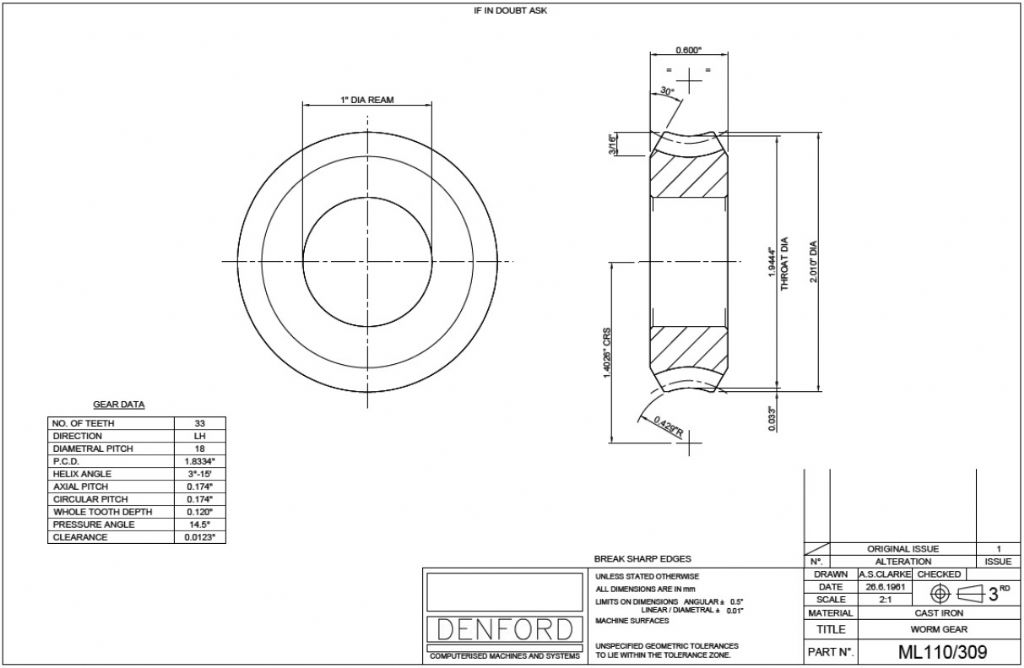

            Pete Rimmer
              @peterimmer30576
              The drawing you're looking for is ML110_309 it's the drawing for the worm gear. It's a 18DP 14.5PA LH worm gear of 33 teeth left hand helix and 1.8334" pitch diameter.
              Going by the specs on that drawing your worm should be I think 1.098" diameter 0.174" lead single start LH worm.

                  Posted by Pete Rimmer on 07/01/2021 22:18:49:
                  Thank you Pete.

                      If this is your only lathe you could start by turning the worm gear over. That would put 90% of the load on the un-worn side. That would get your auto-feeds working at least towards the chuck but probably both directions since you'll have the worn part of the worm acting on the unworn part of the wheel, and vice-versa.
                      Then you're going to have to figure out the gearing to get a lead of 0.174" or 4.4196mm to make a new worm using a threading tool ground to 14.5 degrees which is ACME thread angle.
                          Edited By Pete Rimmer on 07/01/2021 22:26:36
                          Pete,
                          Please excuse my questions.. I'm a novice.
                          You mentioned 1.098" worm diameter. I assume you got that from (0.429"R + 0.120" tooth depth) * 2 which equals 1.098" or 27.89mm
                          The least worn diameter of the worm measures slightly less at 27.63mm. Looking at the working drawing should we also take the specified clearance into account when calculating the worm diameter?

                          Pete Rimmer
                            @peterimmer30576
                            Yes you're right, lacking a drawing I used the figures you quote not giving any allowance for the clearance. It was more so you could compare what I think you should have with what you actually have. There would need to be a clearance allowance.

                                Looks like both original parts are cast iron. I see no reason why you couldn't make them from mild steel though.
                                For a permanent fix you could do a number of things:
                                Make a new worm and a new wheel to the original sizes.
                                Make a slightly larger worm and re-cut the wheel with a 1-off form cutter. Depending on the condition of the wheel it might only need cutting 10 or 20 thou deeper then you can increase the PCD of the worm the same amount.The wormwheel cutter would have to be the same OD as the worm itself and you can make it from a hardenable steel, using the 2-button method to get close to the correct form. Then you'd have to set the cutter at the helix angle, index the worm for 33 teeth and plunge-cut each tooth in turn. It's not as difficult as it sounds just a bit of work.

                                  It really doesn't look that worn to me, it looks more like the cog isn't engaging enough of the worm
                                  Can you get any more travel out of the engage/disengage part

                                    Yes it does look as if it's only achieving half engagement. I wonder if the stops on the rotary lever can be adjusted? Might interfere with the operation of the threading interlock, if it has one, or knowing Denford they might have used the interlock AS the stop.

                                      I see your point. Actually when I first tried the rotary lever I had the very feeling it wasn't engaging properly. Maybe that's why the worm became worn and not the other way round. I will take another look over the weekend. Let's hope for some warmer weather as my garage is FREEZING!

                                              Pete Rimmer
                                                @peterimmer30576
                                                Well, given that the kind gentleman has pointed you to the correct drawing on the Denford forum:
                                                You now have all the info to produce your worm. Bonus if you can find a lathe which has 5 3/4TPI on the gearbox.
                                                CVA has that pitch on the gearbox as does my Monarch.

                                                    Pete Rimmer
                                                      @peterimmer30576
                                                      It says 18DP right there on the drawing and the mating wheel is drawn as18DP 33T. The 5.75TPI and .174 lead are a little at odds with each other (0.17391 vs , 0.17450) I guess that they calculated half a thou per pitch is close enough.
                                                      Certainly, the engagement mechanism seems to be hit-and-miss enough to allow for a much wider error.
