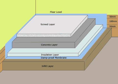

      With impending retirement I plan to build a small extension onto my garage to become a dedicated workshop. The structure will be well insulated and should need only a low level of heat input to keep it warm. To provide this I plan to embed a low-power electric heating element into the floor.
      The heating elements need to be embedded in 50mm of concrete screed which would sit on top of 100mm thick polystyrene blocks.
      My question is this: Is 50mm of concrete sitting on top of a relatively soft base material going to be strong enough to support machines weighing up to a ton ? Any thoughts or experience anybody?
      A crack in the concrete would be a bit of disaster for the heating elements as one might imagine
      Gerry

          No
          Mainly due to the polystyrene

            All disturbed soil settles so you need to spread the load big time.
            It would be normal to use 100-150mm of concrete (not screed) with reinforcing mesh as the structural floor. This can be above the insulation. If below you need a similar thickness concrete top layer.
            Screed is not good for bending loads and would not be considered structural in this sense but its fine for making a smooth surface and wrapping around the pipes/wires of your heater.
            Good luck, just get a builder in. wink

                            Current building regs go along the lines of this:-
                            Add reinforcing mesh to concrete slab for extra load bearing. Infill layer would be hardcore with a sand blinding on top. Heating if required in the top screed. If machines need fixing to floor heating element position needs careful planning.

                                                Posted by gerry madden on 06/02/2022 19:38:24:
                                                Gerry
                                                Relatively soft materials aren't a problem provided the weight is spread over a wide enough area. Tanks rarely get stuck in mud because caterpillar tracks massively reduce the pressure on the ground.
                                                Looking up polystyrene insulation I found 3 pressure resistant grades made specifically for insulating floors, able to take 100kPa, 150kPa and 300kPa for 10% compression. Polystyrene made to insulate walls is no good.
                                                300kPa is a bit over 40 pounds per square inch so my flat-bottomed sheet-metal lathe stand with two 13×13" plinths would support 13520 lbs (over 6 tons). As my lathe actually weighs about 600lbs, say 800lbs with the stand, the pressure would be only 2.4 psi, and I'd expect polystyrene under the plinth to deflect by about 0.06mm.
                                                Although concrete screed isn't as good at distributing pressure as chipboard or floorboards, I think it would be safe to support heavy machines provided a stiff board were placed underneath to guarantee load spreading. For example, a length of kitchen worktop 52" x 24" under my 800lb lathe and stand would reduce the floor loading to about 0.7psi, which is trivial.
                                                I'd be nervous of doing anything that increased pressure on a polystyrene insulated floor such as putting a heavy machine on wheels. But this is mainly because I don't know how 50mm of concrete screed behaves laid on top of polystyrene. I suspect the combination is much stronger than I give it credit for because floors are generously specified to take loads. Is there a builder or architect on the forum?

                                                      Thanks all for your input.
                                                      I think its clear now 50mm of concrete on a compliant base is quite risky, and especially so with electrical elements embedded in it. I will have to consider something substantially thicker, probably 100mm min. In a house this wouldn't be helpful as it just slows the warm-up time. But in the workshop it would only be a background heat just to keep the room a little above ambient, so perhaps 100mm is not a problem.
                                                      I had planned plenty of insulation and the calculations suggest it wouldn't take much energy to maintain a reasonable differential with the outside ambient. I already have solar panels on the house and they generate far more than I can use, so this would heat the workshop most days, and for free.
                                                      The real problem now is that the planning people want to reject the whole concept due to 'green belt' concerns. So all workshop design activities are on hold until this is sorted, ….if it can be sorted.
